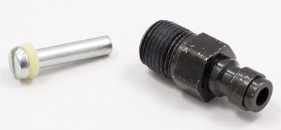

Is it a typical Foster fitting with a pin-type check valve like this?
If so, measure the pin diameter with calipers and report back. For example, let's hypothetically say it measures 4.3mm. You would need a M1.5 x 4 O-ring.
