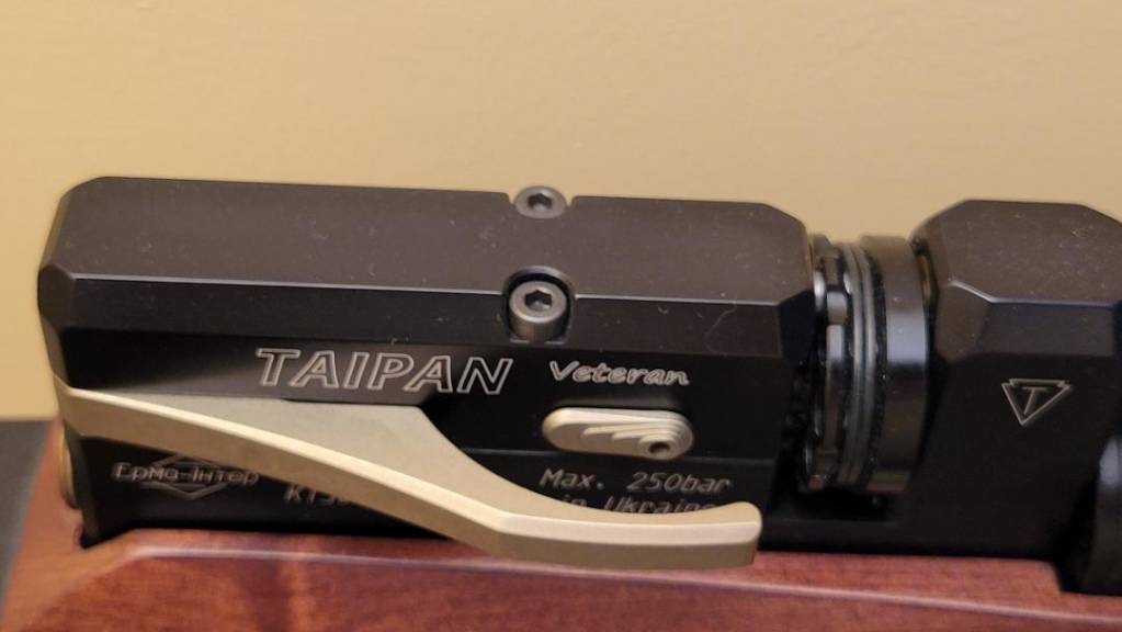

Been shooting Taipans for about three years now and just discovered something new.
The anti-double loading feature is something that is well known and I use it frequently.
A cocked gun can be decocked by pulling the lever back and holding it while squeezing the trigger and letting the lever close slowly.
That's how I've been using it but today I noticed something else.
If you slowly pull the lever, the mag will rotate halfway to the next pellet... 'click'.
Pull the lever just a little farther and the 2nd 'click' lines it up for the next pellet.
At this point you can push the lever closed and the pellet will be loaded without cocking the hammer.
No need to cock then decock using the trigger.
Can't believe I'm just now figuring this out
Is it just me or did everyone else already know this?
