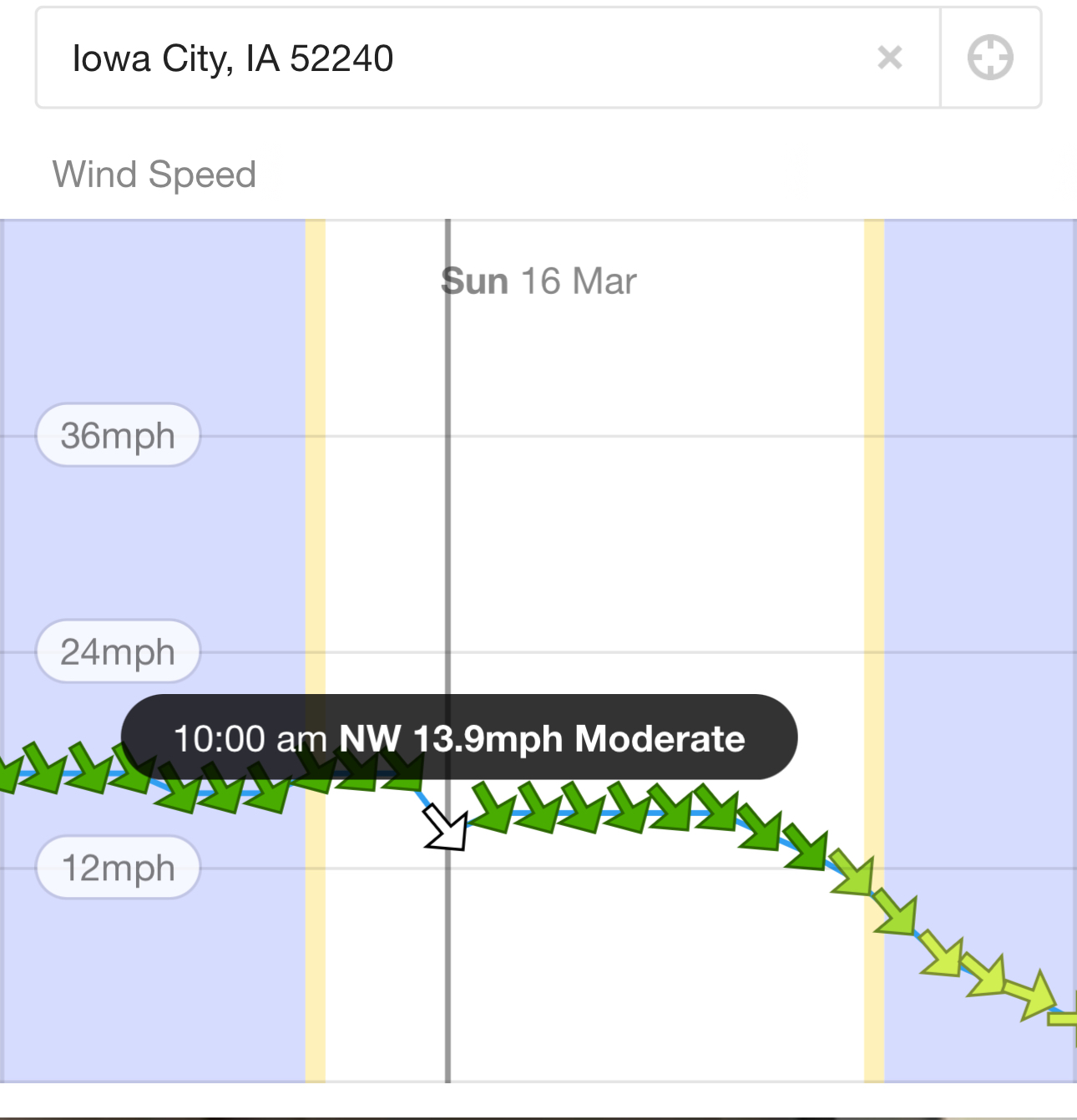

So tomorrow at the same time it will be a ten mph less wind. So about 13-14 and from the other direction. The range faces west. Today wind was coming from my 11:00 position. Tomorrow it will be more like 2:00. I’ll be dressed a little better.

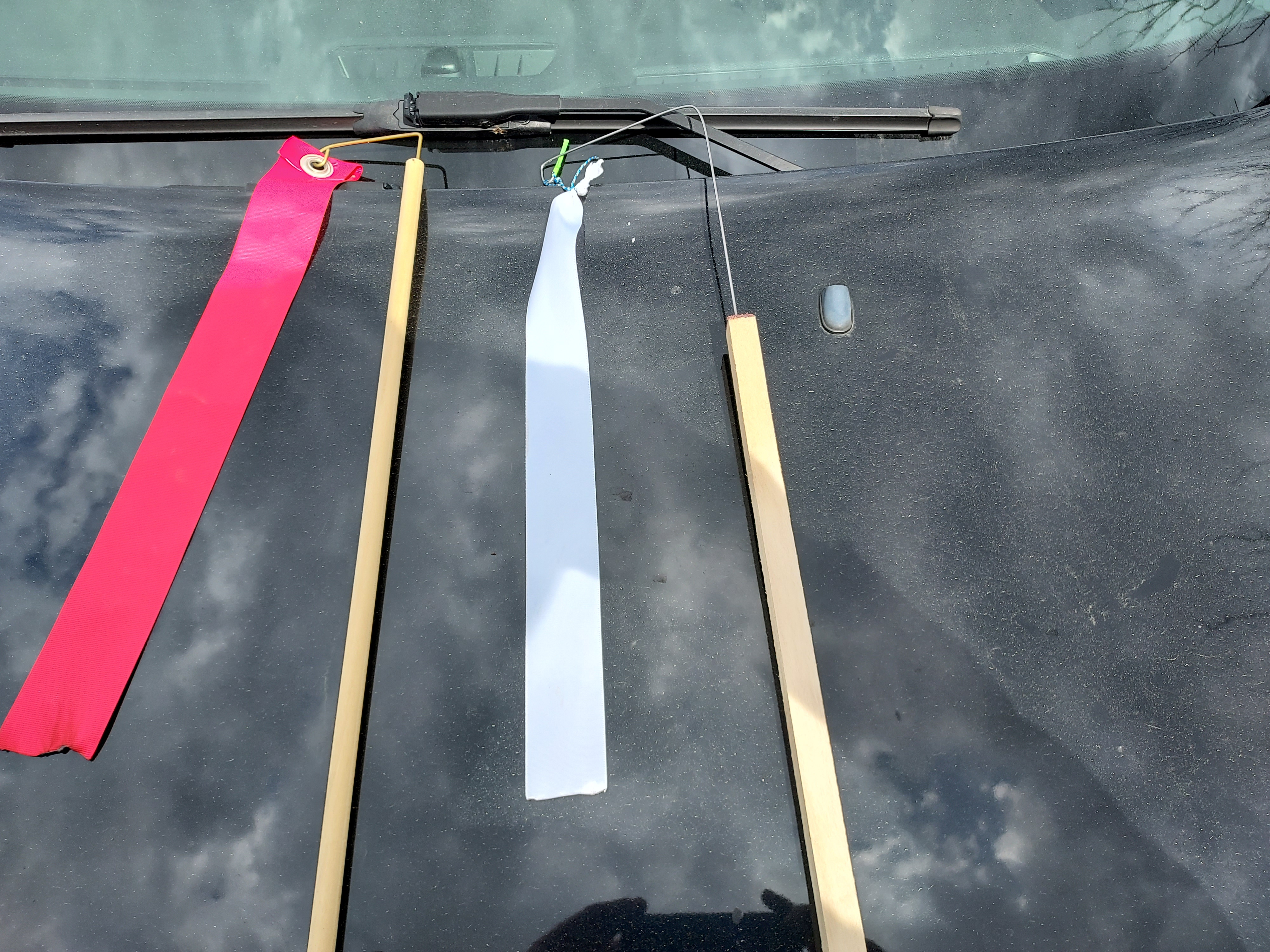

Accurate and cheap:
1. The left indicator meets USA Shooting Specifications: 400 mm long, 50 mm wide, and 150 grams per meter squared
2 . The right indicator is satin ribbon using the rod from a landscaping marker flag.
3. Both wooden dowels have holes drilled large enough for the rod to spin freely allowing the flag end of the rod to always point down wind, and visually (through the scope):
a. When the wind is towards the target, the dowel will be before the flag.
b. The reverse is true when the wind is from the target.
4. Square dowel allows clamping to a structure, round dowel allows usage with a tripod.
Reactions: Iowa Airgunner
Thank you. That is gold information. I had no idea there was a spec for the wind flags.
You are welcome.
No body sells them so they are hand made.
The wind flag shown (red) is used for all sanctioned 6400 matches on our Rifle Competition Course.
Each flag dowel is placed in a pvc tube in the ground that is set at a specific location relative to the target and shooter with the flag at a specific height.
I only know this because we hold a 6400 event every year and one of our shooters shot a perfect 6400 (one of 3 to date) and every aspect of the range had to be verified for the record to stand.
