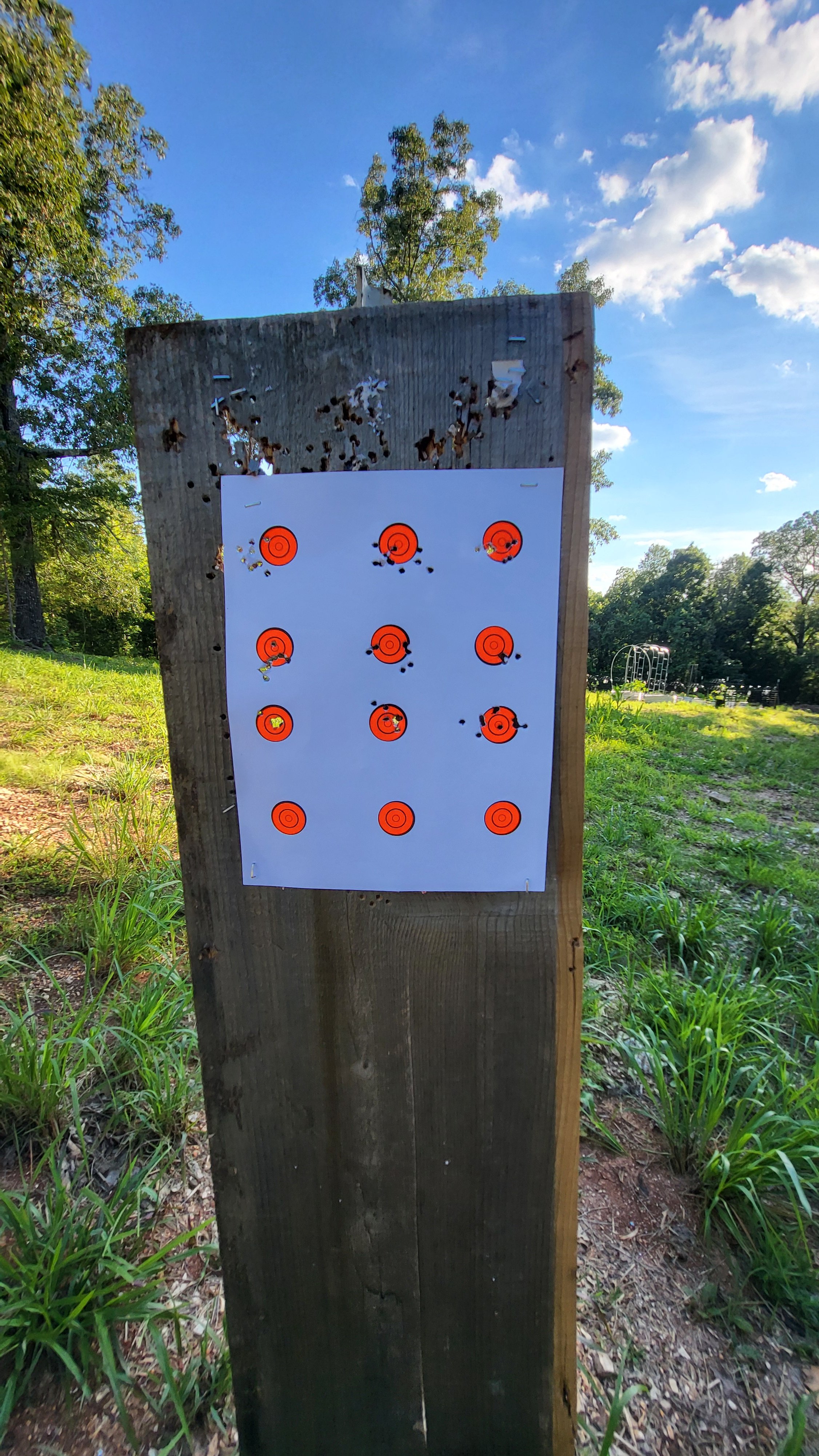

Here's the good the bad and ugly. Always the whole page. Ten shot groups at 33+ on 1 through 5. Five shots at groups 6 and 7 and I blew it on 8 & 9 so I shot ten on those. The orange stickers are 1"
Oy well.

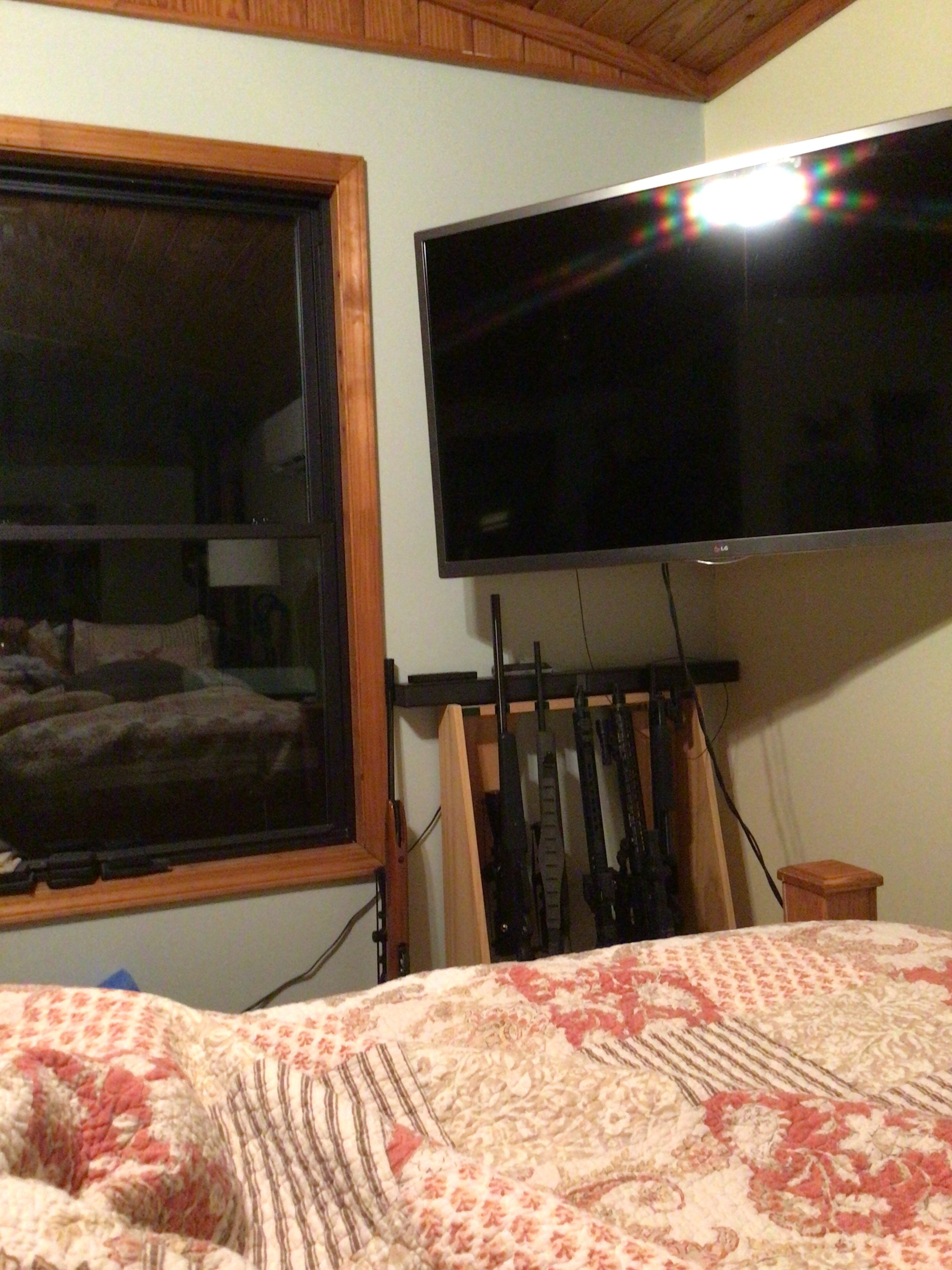

Please don't be offended. I'm not suggesting I'm more intelligent or you're stupid. If you read the other thread as I suggested you might understand my position. I'm not interested in entertaining the same argument again. I keep lots of loaded weapons around the house and I have my reasons. There's a loaded 9mm om my bedstand and 2 loaded ARs and a shotgun at the foot of my bed. That may scare some people but we've never had an accidental discharge because we practice safe handling.
