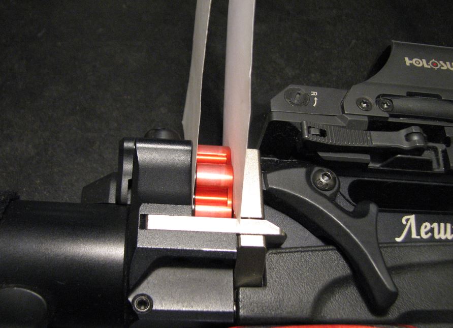

do the mag turn freely if you remove the index arm spring?
is the mag plate bend? - check this on glass
is the mag free floating in between the breech? - you should be able to slip a slice of copy paper down to the barrel at the front, and down to the puck at the back
..and the puck should be able to move back after each shot, keep it well oiled with silicone oil
Reactions: RAMJET66

the puck, under pressure, moves forward do seal against the mag plate (also squares the mag up against the flat part of the barrel so the pellet is perfect in line with the bore) - and the puck spring back a tiny bit if well oiled (like a brake caliper from a brake disc) when the pressure drops so the mag is free to turn
