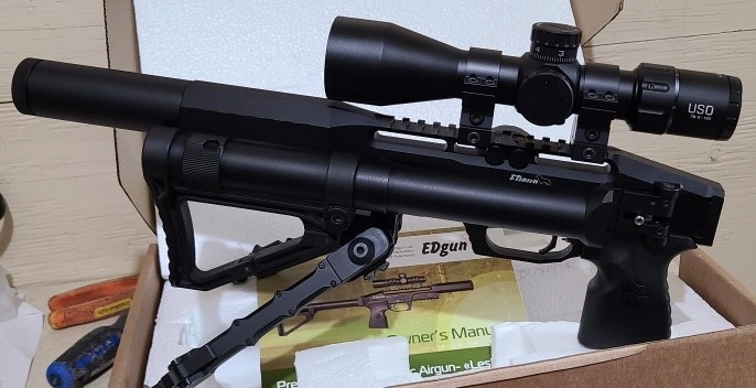

It is the stock regulator and the Leshiy is the Classic gen 2 that just comes in a box no hard case. Not sure about grip but pic attached.
It has the stock arrangement for the 350mm .22 barrel.
Also what shot count should be expected with the .22 350mm @ 700fps 16gr configuration
That is the stock Edgun grip. I can't tell for sure if it has a 3d printed extension but I'm guessing it does not. If you get it and don't like it I would try a 3d printed extension first. I believe user @Towle has posted a free file for members to use if you have access to a 3d printer. Otherwise look and see if they're still available on Ebay.

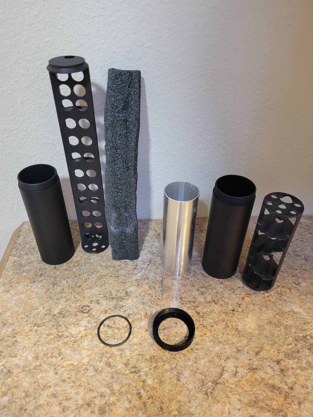

I would want to confirm that it was the stock extension and not the DonnyFL extended baffle. I have both and prefer dealing with the stock setup in the field. If your pack is big enough to carry it fully assembled then really not a big deal.
Stock extension ? Just the shoulder stock portion on the air tube ? It is stock as well. Nothing upgraded except has the optional Huma pellet dispenser. Not sure I would need the dispenser.
Sorry, I meant the "stock' (as in from the factory) shroud extension.
On the left is the first three parts are the threaded extension, the DonnyFL baffle extension & some pipe insulation for sound dampening.
The next three parts to the right are the the factory aluminum spacer, the threaded extension & the factory baffle insert.
In the front are the threaded end cap & o-ring required by both systems.
Again not a big deal if you're leaving it fully assembled while packed. I do prefer the factory aluminum spacer but really no difference in value to a purchase. However, I'd want to know if buying.

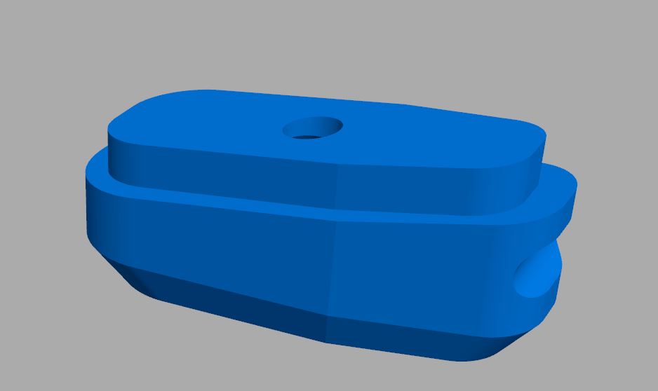

Fast and easy print and uses the original screw
https://www.airgunnation.com/topic/leshiy-classic-3d-print/
