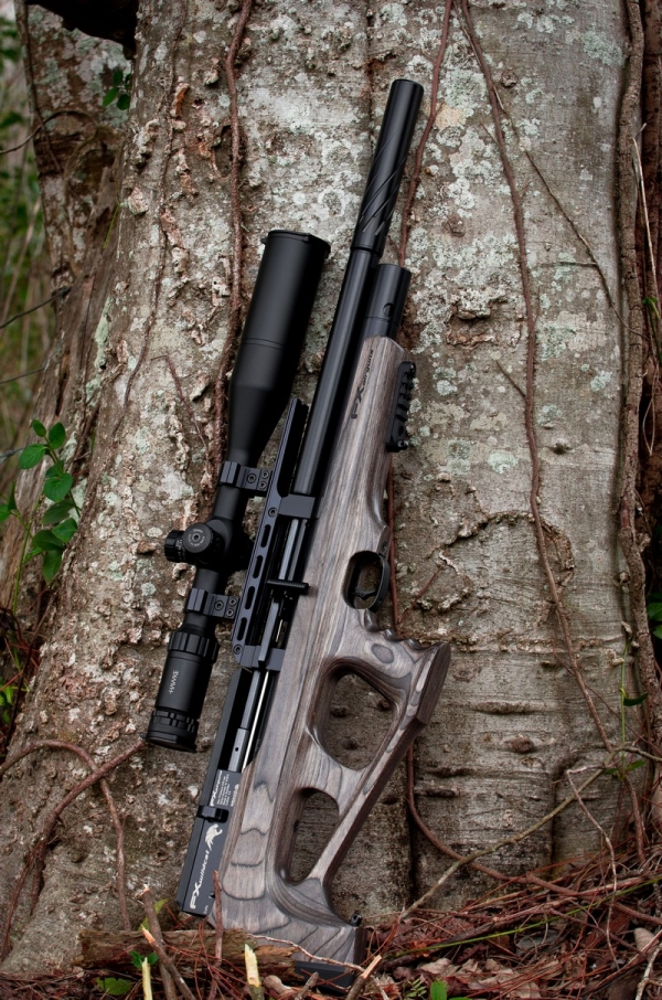

OK so Iam not bragging or anything just being honest here I do own Both in .25 a compact mkii wildcat and a Lelya 2.0 so here are the observations.
The edgun mags are long enough for a hornet or polymag , THE FX IS NOT!!!!! if this matters
The lelya is much more compact period in every diminsion sorry it is bottom line and not by a small amount
Accuracy about equal, with each having a different favorite pellet
tunable EDGUN is actually easier to adjust hammer spring!
FX was smoother new, now run in equal just different with the straight pull, EDGUN is ambi in all ways,
lelya has a mag cutoff
wildcat is more delicate (sorry it is)
you can change bbl liner in fx pretty easy
Edgun is easier to clean from the rear
Wildcat has a nylon cheek rest! thanks for this !!! ED has a new one avail.
Wildcat mk2 compact with gray laminate stock(AOA thanks for the special) sidewinder 4-14x, Lelya 2.0 walnut 6x dedal stalker. Both in .25
