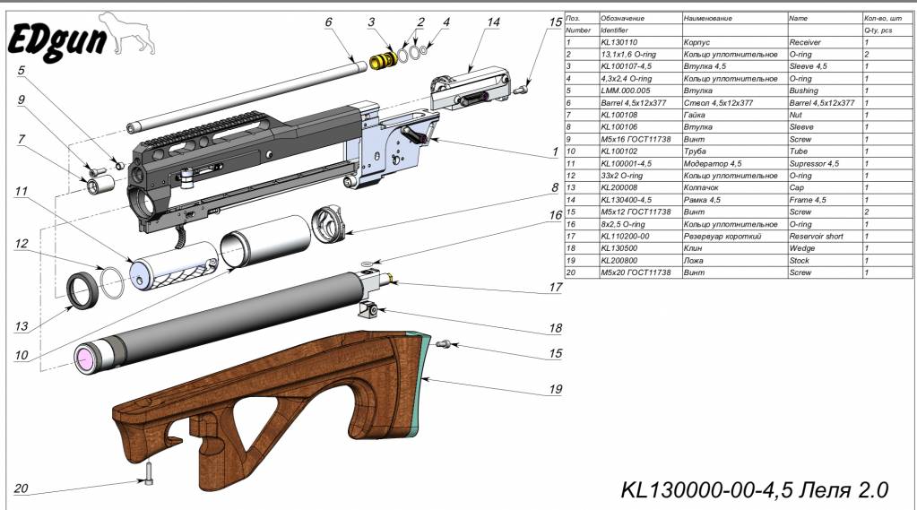

zeravince - check the breach o-ring, make sure it's in place and not cut. Without knowing exactly about my own gun, that would be mi first guess.
Mike
P.S. - See JWilson's picture above. He was typing the same time that I was ! See items #2 and #4.
