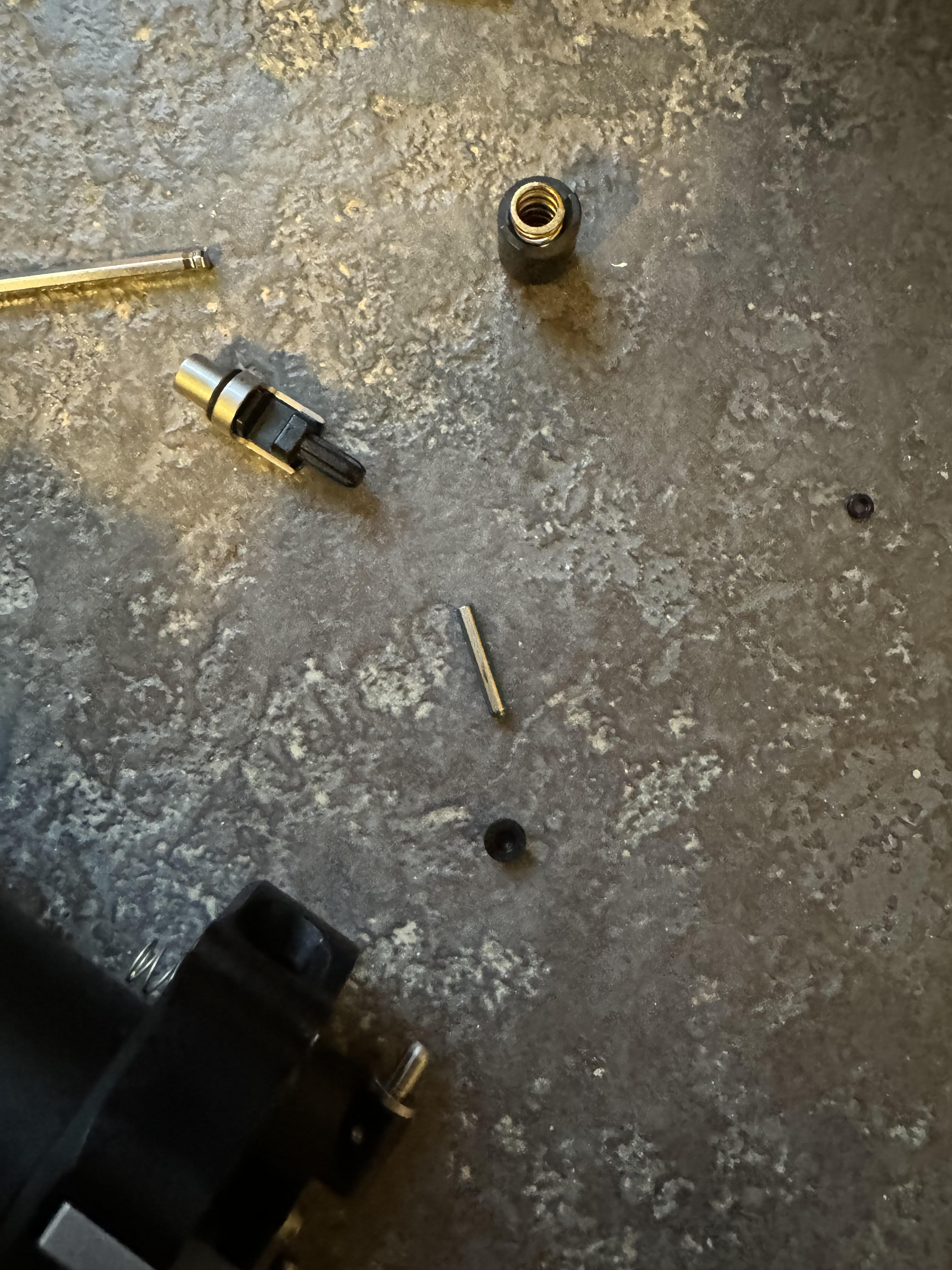

If anyone has access to a Leshiy 2 Workmat, I believe I'm working on the "forward plug" portion of the Leshiy. I attempted to follow Edgun West's Leshiy 2 Indexing Problems video, but an unexpected part (looks like the video wasn't shot for the 9mm) threw me off.

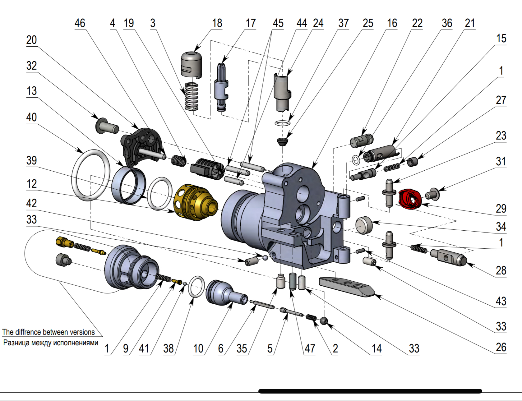

It's the tiny black cap. Where the hell does that thing go? I could really use a schematic or a photo of the forward plug assembly.
