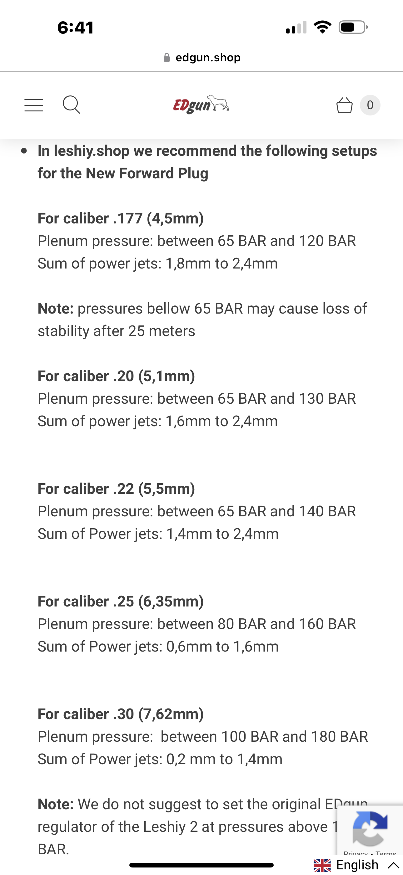

Much appreciated! I honestly have no clue what kind of jet size I have installed right now. My country doesn't have restrictions on power, so they are the original (FAC) ones I got from EdGun Spain. I have the Huma Raptor installed, set to approx. 160 bar. I'll have to dig into it.
Got this from their website and hoping this helps you out.
