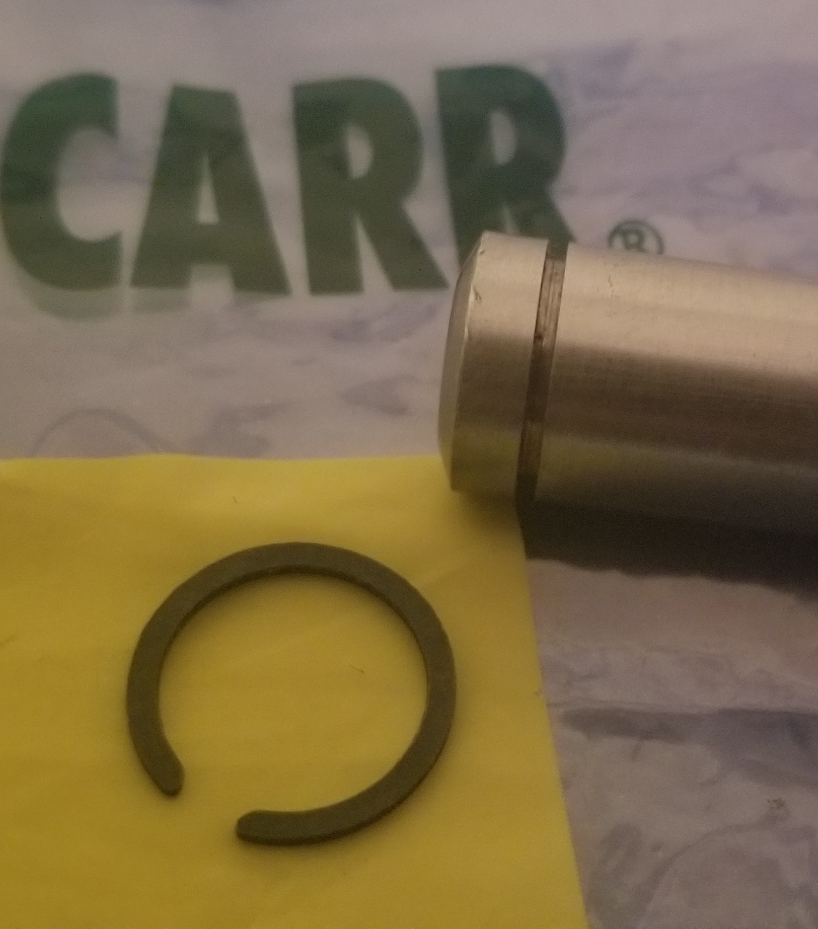

Unfortunately it isn't the traditional snap ring c-clip with the eyelets that you would insert the snap ring pliers into. Here is a picture of the c-clip:
I did some more digging around to identify the type of ring and I believe it is a spear end retaining ring (if it is called something different I would be interested in knowing the correct name). I ordered some of these pliers to see if I could get the clip on with the pliers below:
