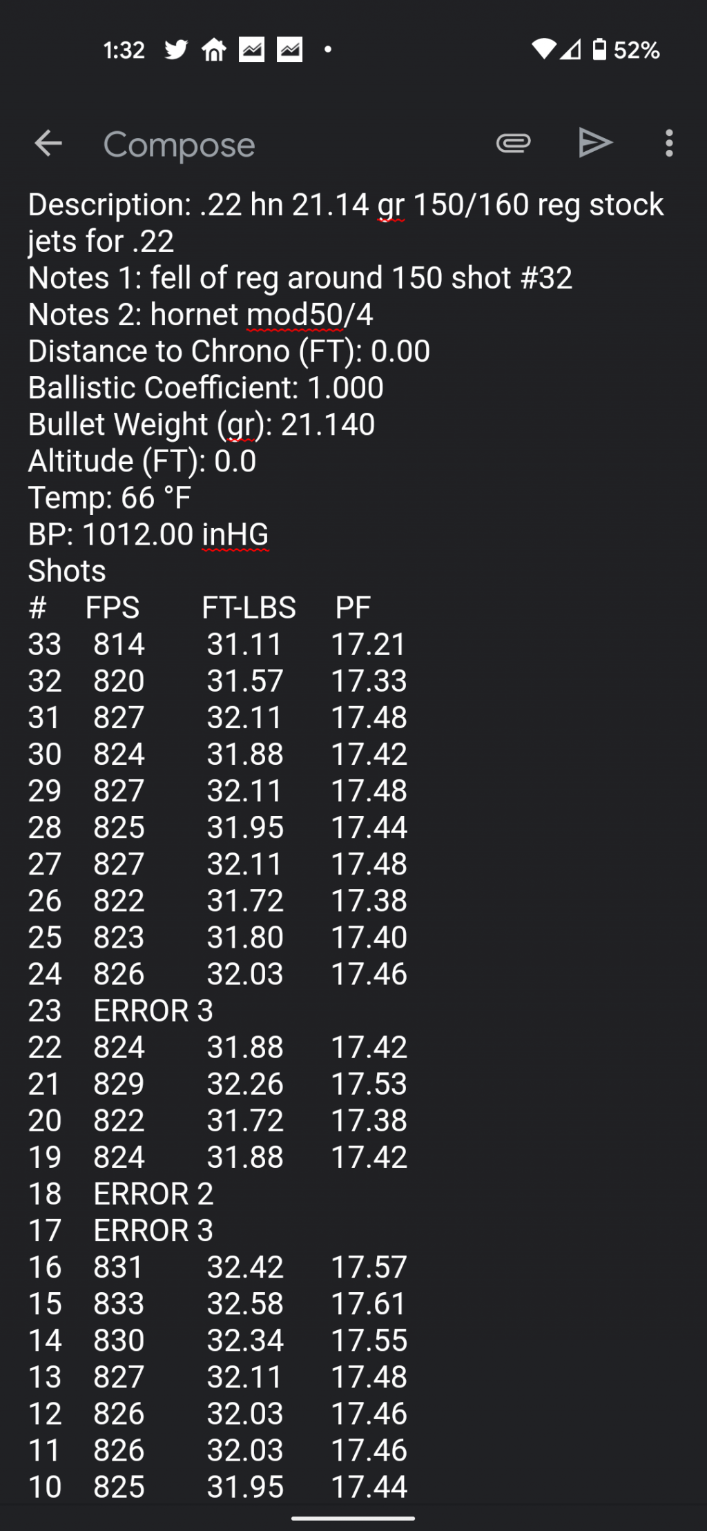

Tuning leshiy 2 chrony #'s let's post em
.22 cal
250mm alpha precision
HN barracuda 21.14 gr
150/160 reg
Stock jets (.4,.5?)
Mod 50/4 moderator
Leshiy 2 large air bottle
Leshiy 2
350mm barrel. .25 Caliber
No idea about the reg settings. Stock as it came from Brian at Edgun West except for the Valkyrie Akula Mod 40 handguard and moderator.
JSB 25.4
Shot count: 10
Low: 884 Hi: 900 Avg: 891
FPE 44.8 Ft Lbs
Spread: 16 1.8% STD Dev: 5.8

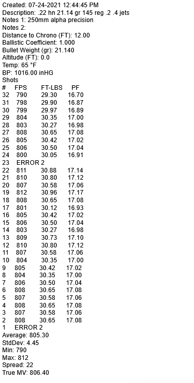

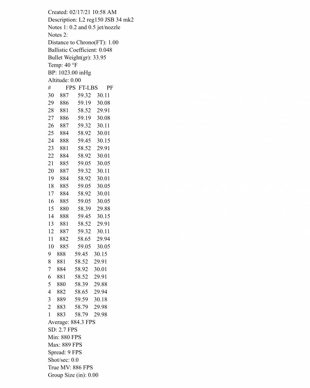

It seems to me that the small reg changes make a much larger impact on fps than changing the jets. If I understand this correctly changing the reg = changing the pressure of the air. Changing the jets = changing the volume of air by changing the dwell time of the valve.
I tried the same .22 cal 21.14 gr pellets today. Took the reg down to 130/140 and swapped the stock jets for .2 and .4
Below are the results.
I'm getting a 350mm .25 cal barrel and my goal is to find the sweet spot between .22 and .25 where I can swap barrels without having to degass the gun.
I think your setup with 140 bar 0.2 and 0.4 jets will work good will a .25 350mm shooting JSB heavy 34gr around 850fps. It maybe a little hot for the the 25gr pellets at around 940fps.
Yeah I'm not getting 940 fps, more like 820 250mm .22cal. My hope is that by getting the 350mm barrel I'll be able to get .25 cal shooting in the 800 range without changing reg or jets. Then thinking about getting a 450mm .30 cal and seeing what that does.
I think if I find the right gr pellets at each caliber and having longer barrels as I go up in caliber, I could get something that will work well across all three calibers inside of 50ish yards
Go with heavier .22 medium gr .25 and lighter .30's

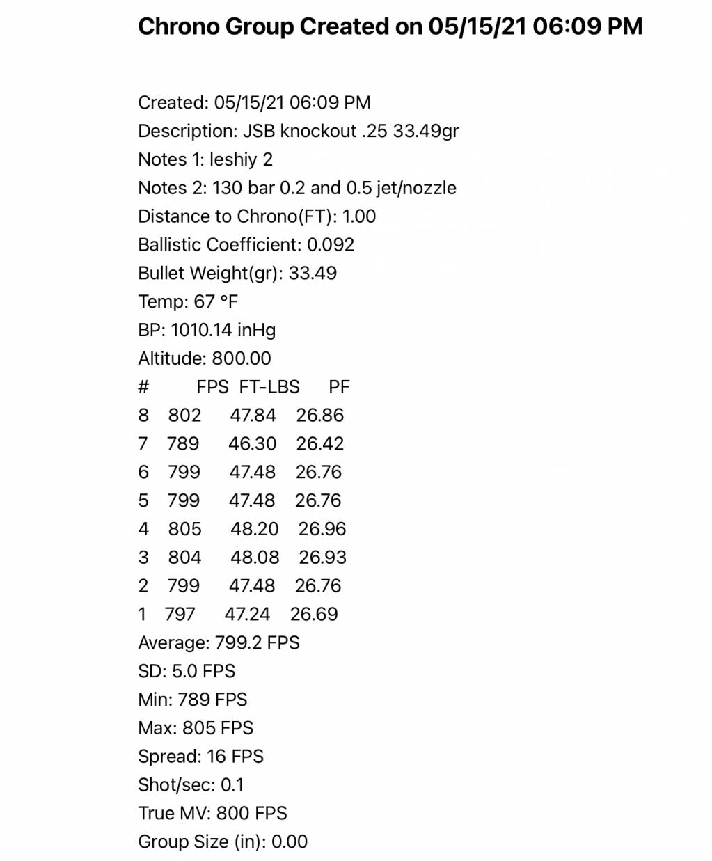

I think you misunderstood what I was trying to say. With your current set up of 140 bar using 0.2 and 0.4 jets you will probably shoot .25 25gr pellets at 940fps and 34gr pallets at around 850fps with a .25 350mm barrel. My reasoning is based on my .25 cal 350mm at 130 bar 0.2 and 0.5 setup shoots 25gr at 890fps, 34gr pellets 820fps and at 150 bar 34gr pellets a 884fps
That is interesting. I didn't realize the longer barrel would make THAT much of a difference.
