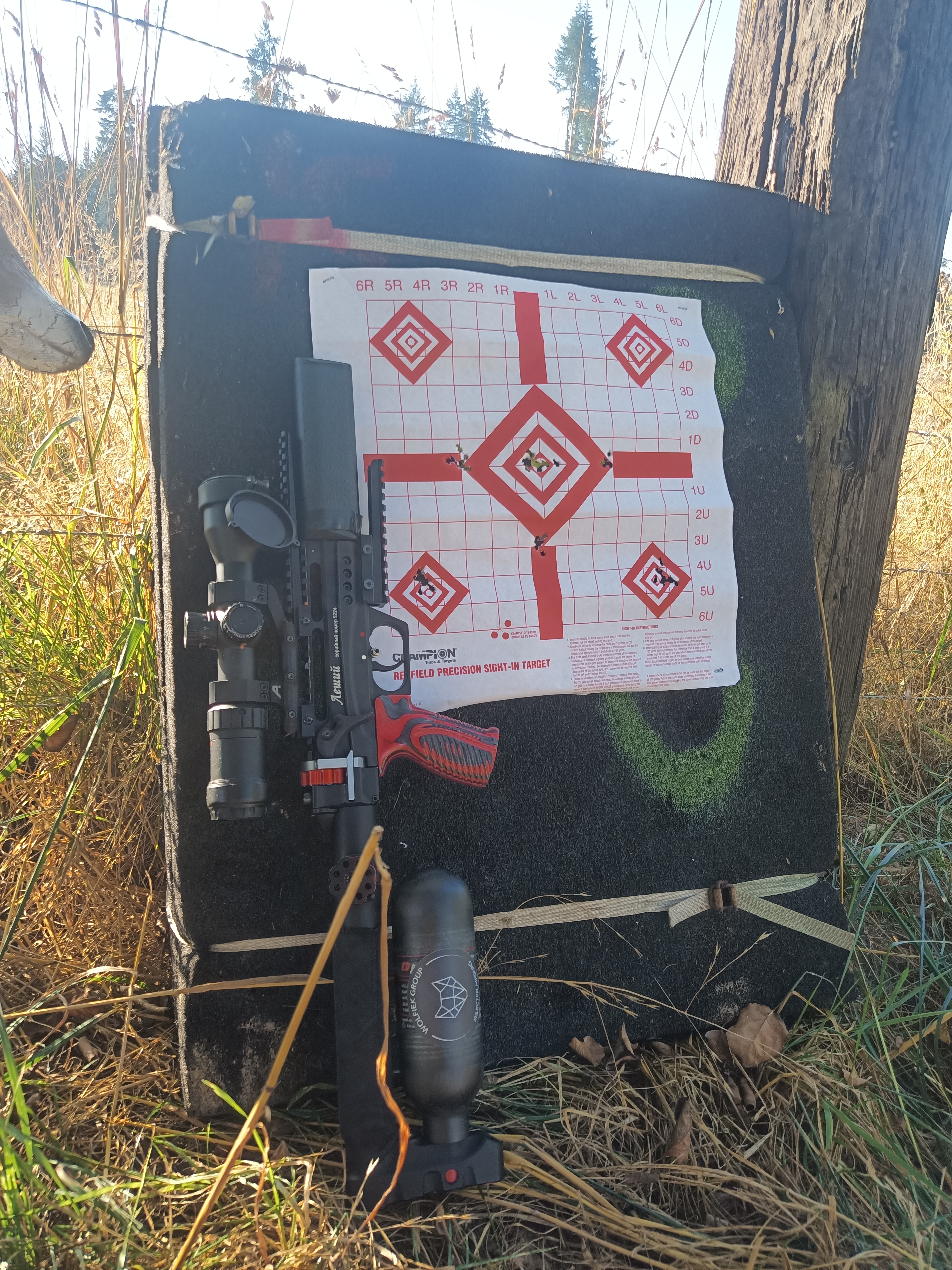

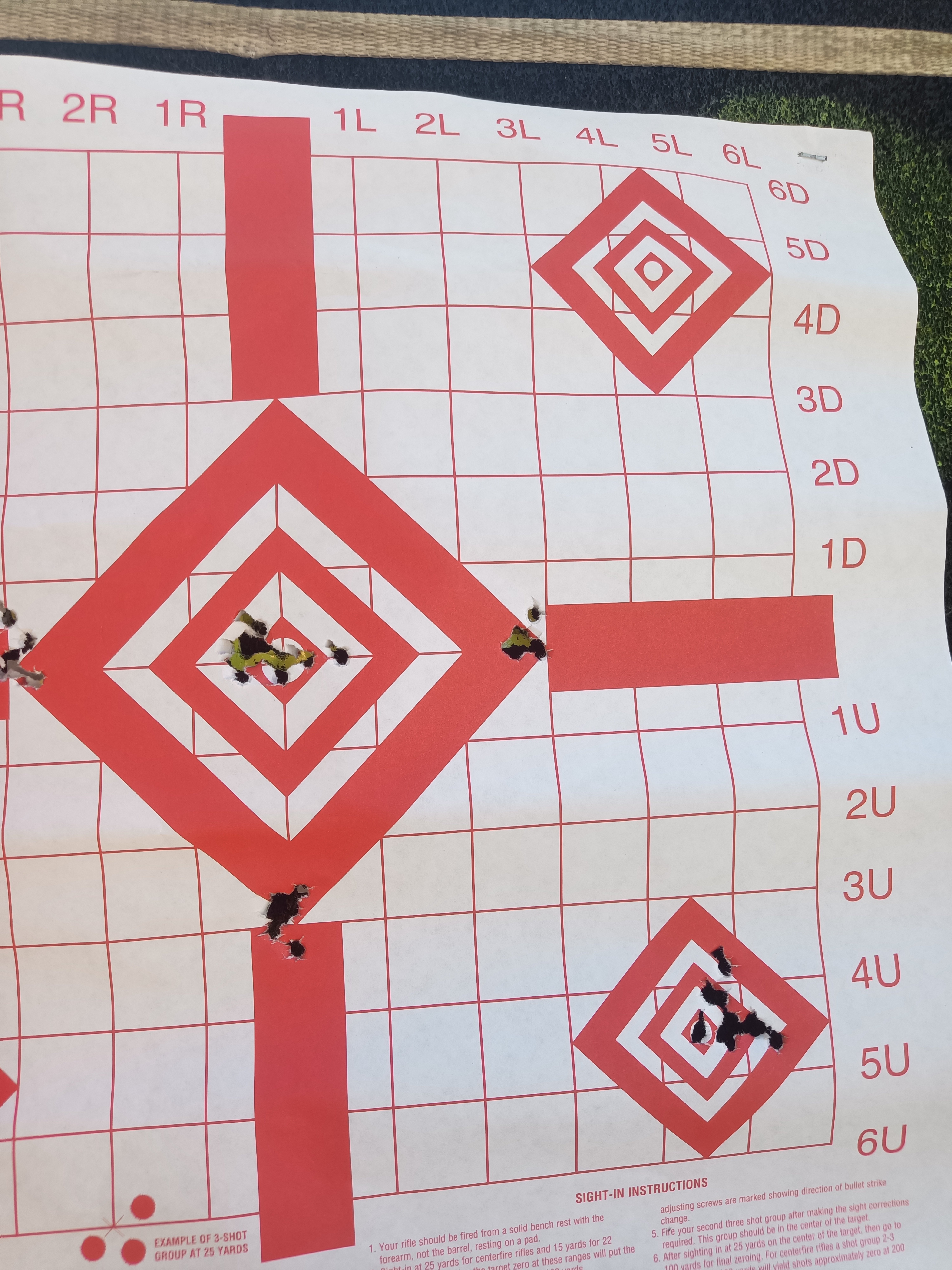

View attachment IMG_20221003_163802.jpgDid some shooting with the L2 today testing what velocity the premiers like. Set the reg pressure to 95 bar and that got me around 695-700 FPS. This was at 35 yards sitting supported with unsorted pellets(pretty sure I had a few dented skirts if the fliers are any indicator. With this tune in 22 cal I can get around 220 shots per fill with the bottle and 70 with the original cylinder.
If I sorted pellets I bet I could get this size of group out to 70 yards. If you're wondering if the L2 will shoot the cheap stuff I'll say that mine will. I forgot to mention all groups are 8 shot groups.

Are these the Premier domes or hollow points? Another poster on this forum mentioned that his Leshiy2 shot the Premier domes well. I think at a faster speed than you mentioned but I'd have to go look that up.
I do have some hollow points here. I'll have to try them in my 22/250 L2.
They are hollowpoints but I have not noticed a difference in how they group vs domes. The Crossman wadcutters in the carton shoot terribly in this gun though, like a shotgun group.
