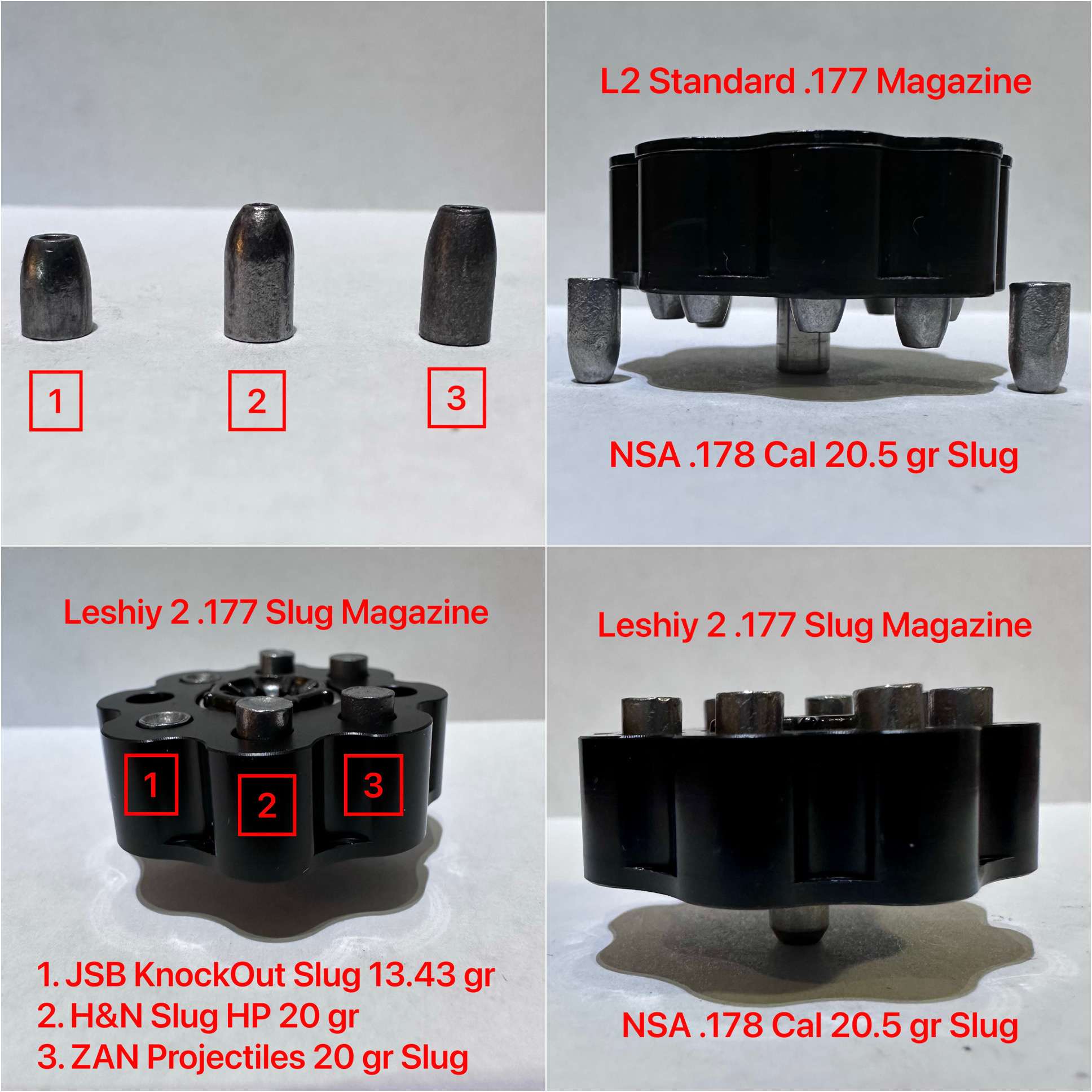

I only shoot .177, and can only speak personal experience on that caliber.
I've tried several brands of pellets, and they all fit in the standard Pellet magazine just fine.
JSB KnockOut Slugs fit, and work best for .177 slug magazines!
You need to be using standard Pellet magazines for JSB Hades or any other Pellet!
Slug magazines are a smaller diameter than the standard Pellet magazine!
Note, in the photo below, how the smaller diameter slugs fall through the standard Pellet magazine.
Also, here's the thing about Slugs, some brands (JSB/Edgun) fit perfectly in the slug magazines, while others fit too tight.
Yes, you can finger press in the tight slugs, and they'll shoot, but in my experience tight fitting slugs can have varying results.
You will need to search around, to find discussions on the best fit slugs in your caliber.
Thanks for posting this. I have ordered some ZEN slugs, simply because that is what EDgun sells on the EU site. I figured that has to work. I am also getting some dedicated pellet magazines. I will report back.
