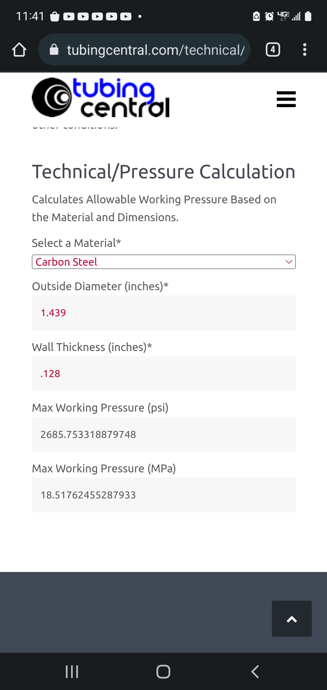

I did alot of research when building the plenum for my 50 and the wall thickness to inner diameter ratio of that tank is waaaay too thin for anything in the pcp pressure ranges.
Would the type of material make a difference in what wall thickness is needed? I know in my line of work, alloys and heat treating make a big difference in the properties of the aluminum.
Assuming 7075t6
And a quick caliper measurement of tube
Here are the numbers using YIELD STRENGTH. Ultimate tensile of 7075 is 82k (actual burst)
Ed, correct me if I’m too far off here.
Dave
Note: The safety factor is a variable, I only used 3 because it is close to what the design gives us before the tube even yields @ 12,808

I believe in real world testing. Years ago I started making Titanium tubes for PCP's. I sent parts out for destructive testing. I was worried until they sent back the parts. It separated at the end of the thread relief at 17,400 psi. I felt better then.
This is obviously the best way. Test to destruction or the end of your capability. It really is amazing what some alloys will take.

I did a quick check of mechanical properties of various aluminum alloys. The yield strength varies between 3.5 MPa (1100, no temper) to at least 70 MPa (7075 T6) . To me that makes simple measurements of aluminum components not very valuable without knowing the alloy used. I would expect an airgun to be closer to 7075 or possibly even 7075 (2024 seems to be another possibility, its around 40 MPa depending on temper). I doubt the tubes of inexpensive moisture filters are this kind of aluminum, however. They could be recycled material which could be anything from really strong to something like 1100. I don't know of any simple way to tell unless the manufacturer tells us. An airtube made of 1100 could be equally safe as 7075 but it would have to be about 20 times as thick.
