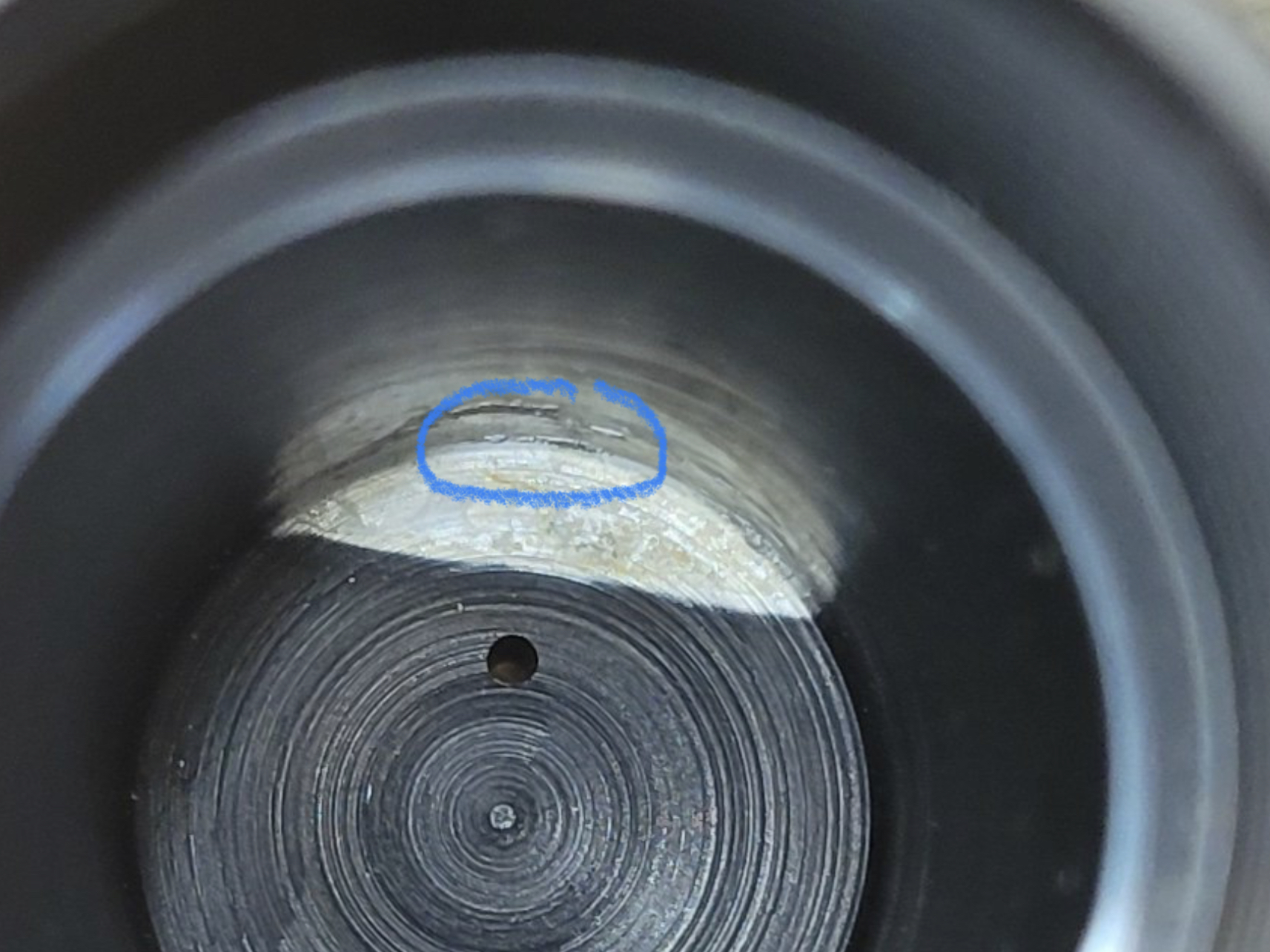

I'll borrow some loupes & see if I can get a better look. Or maybe just slice it in half as I could never sell it with good faith.
Or mail it to @MJP if he cares to look at it?
It looks to me that you could Insert a pick into the gouges to feel for them, no need to cut it open for this. Or maybe it's just me old eyes playing tricks on me. I don't know how it possibly could've have been made like that!

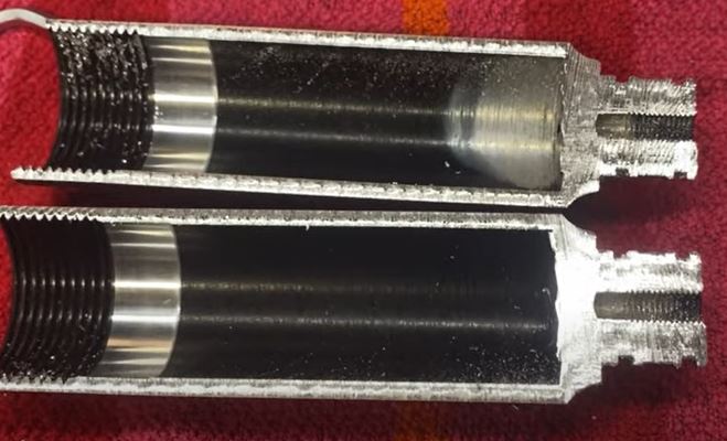

Looks like the tube cut open for the video has a similar area with no anodizing.

This looks like it has some gouges in it. View attachment 352073
That gouge is very worrying also, it is already a failure point in the surface, a discontinuity in a surface is a point for a failure to start.
I did not want to go that deep in to discussion about surface imperfections and potential failure.
The subject is complicated enough already for regular people that don't need to deal with fatigue and stress in parts.

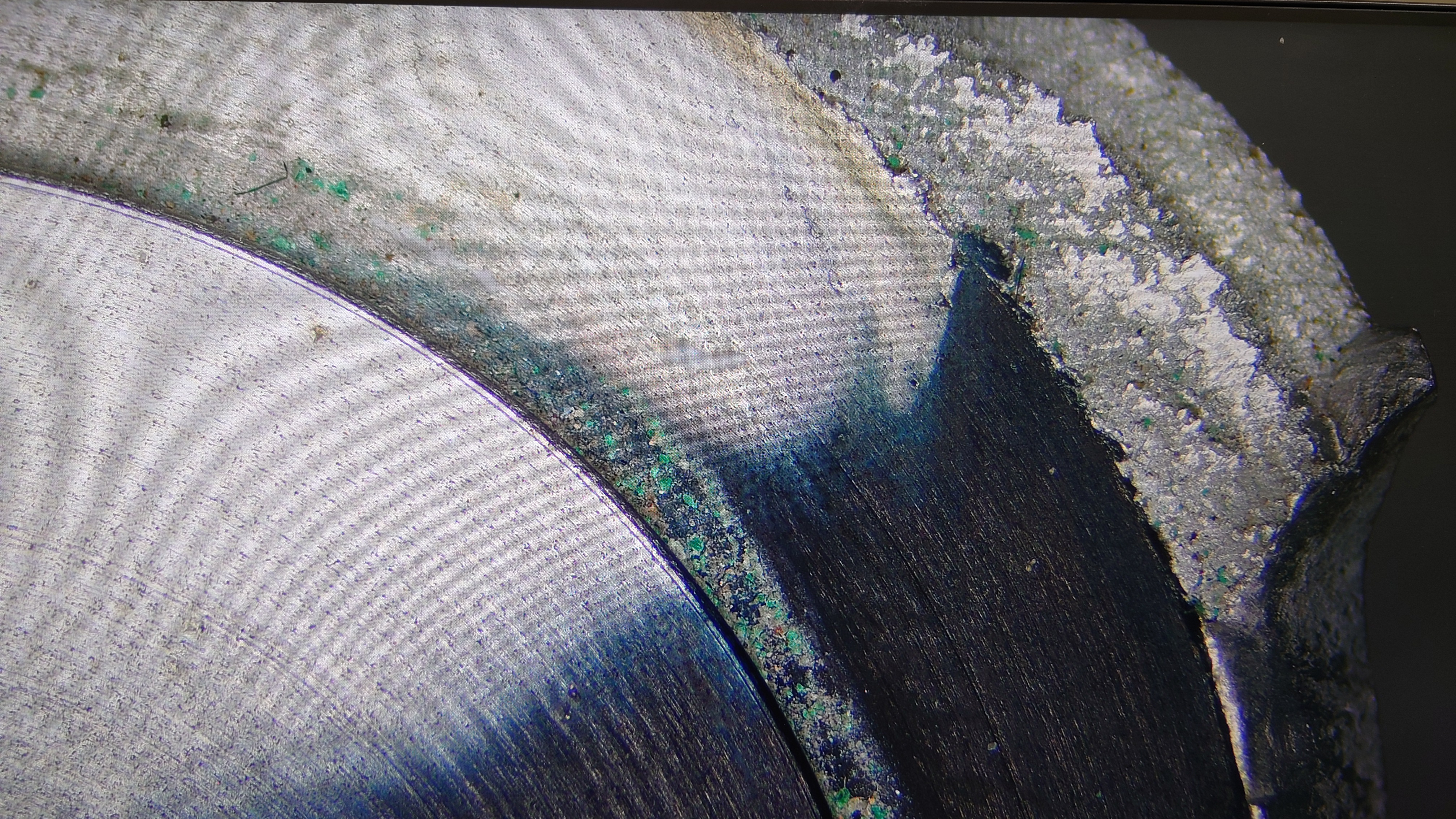

Meanwhile I have examined the remains with the microscope and found some interesting details. The surface of the material is like burned or corrosive. The most interesting thing is that it exploded like it had something inside, and the destroying of the reservoir starts with the thread part, not the bottom (we will talks about "weakness" of the bottom part below). That is quite strange, since, based on my experience and the normal physic the exposure is the process of the widening of gas. When the volume of the gas has huge excess of volume where it is widening. For example, the 22LR cartridge -- the maximum pressure it can give about 130 MPa. Looks serious. But only in case when the gas extends in the close volume, make a hole in the barrels or just drop the cartridge in the fire -- you even will not notice that energy.

When the reservoir destroys due to the material failure, the character of the damage looks different. But when it explodes with the oxygen -- looks like that! I don't want to say anything now, before the expertise, I just tell you what has caught my attention. And my, preliminary conclusion can be wrong, there is still the possibility of the wrong material, no doubt. Let's wait for the conclusions of the experts.
