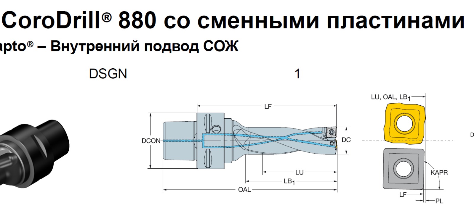

You analyze not the real cut, but the screenshot of the part, made not perpendicular. Look, I just open it in the editor and make the horizontal line, you see it doesn't match the corners. Now have a look at the "steps" and just imagine (in case the shape is really like that) what tool and by what process it could be made, taking into consideration that it is the revolving detail.
That is just artefact of the image. You can ask Marko to make a normal picture of it. Plus to it, there are, looks like, burrs on the part, he didn't remove them by polishing as I did and as you can see at the bottom screenshot.
View attachment 353378 For flat bottom we use that kind of drill.
View attachment 353398 Have I ignored it? Well, I am sorry if I gave you a chance to think that I ignore the "unakward" questoins. I just, really, didn't see it. Anyhow, as I've just said -- imagine if it is a real geometry, how revolving part could be made with such steps, moved in one side, though they should be simmetry from the center of the revolving. Do you get what I mean?
