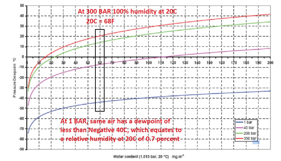

I would never use high pressure air that did not both go through a water/oil separator followed by a proper molecular sieve. Water and oxygen at pressure may as well be pure acid, at 300 bar think how many more oxygen molecules are compressed in a small volume, pure oxygen at 1 bar may actually be less molecules of oxygen per given volume. If you your ambient relative humidity is 1%, and nobody here is compressing that dry of air, at 300 bar and 20 degrees C, 68 F that is over the dewpoint of the air, you will have water in tank. Depressurize tank, pull valve, and the tank will be dry giving you a false sense of security since the water has all gone back to vapor while tank depressurized.
From a paper on breathing air, best graphic I ever saw on how little water is 100% RH under pressure.
