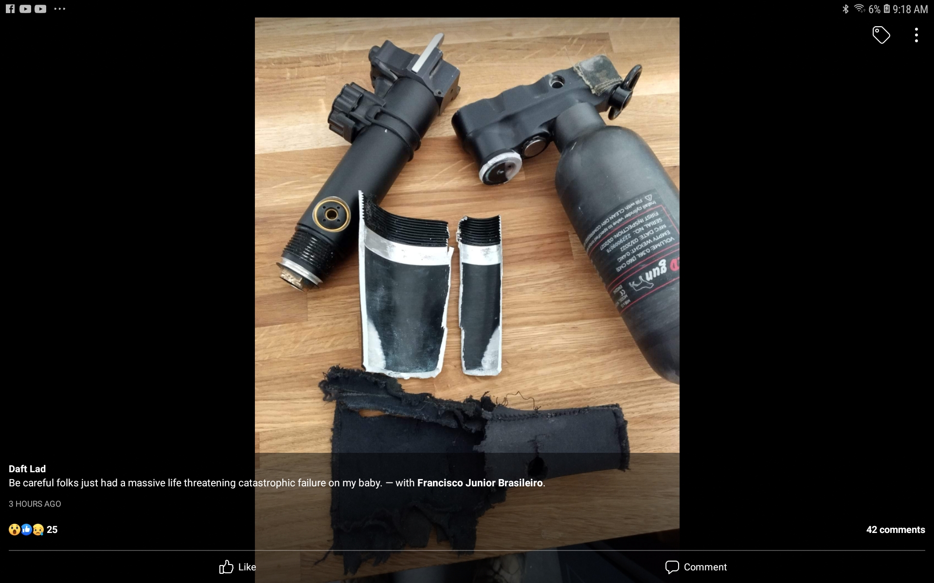

I would have preferred he posted pics while still on the gun, curious which direction it blew out. Towards his face or away, it all seems suspicious to me. If this happened to me, you guys would get the full story and lots of pictures to show. In my old age I have learned to not trust most of what I see on the internet.
Yup, exactly. This whole situation is off so I can't wait to find out what the "official" findings are.

Well this is taking wrong turn seeing water or aluminium oxidation wasnt really the reason of failure... So take a chill pill... Ppl in here are going to perform hydrotesting for Leshiy 2 and if there is problem they will hand out report to our local dealer. I will inform more when they get hydrotesting done. They might test it to failure point seeing no one in our national forum agrees that its safe pressure vessel after seeing wall thickness and design. I highly recommend not to use leshiy 2 untill 3rd party hydro testing is done.. but once again we all are grown up ppl and make our own decisions.

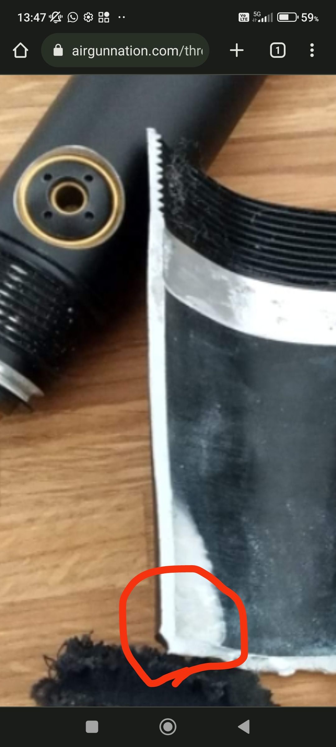

I have to admit I was surprised to see wall thickness, is this normal for the industry? It did seem unusual but admittedly I have no background in pressure vessels. Is this possibly a raptor reg that got set to a higher pressure? I wasn’t clear on what I was seeing in the image
Also, if that oring, in that position WAS being used, it would allow the threaded area to become part of the pressure vessel. It is not designed to have the pressure in the threaded area.
Dave
Thats what I see also!! The oring should be inboard of the threaded area. If its outboard the whole pressure is on the threaded area with a very thin wall. I really hope no one was injured. Please send the pics to Edgun to review.
Reactions: Scotty1
Well I dont really know what standards were used but by western standards leshiy2 is rated at 300bar fill pressure and any part under that pressure shouldnt fail anywhere near those pressures you can output. Actually catastrophic failure should only occure far north of 900bars. This applys especially when used materials such as aluminium that have huge tendency of suffering metal fatique. We use massive safety standards in west due that fatique that can cause failure at alot lower point in time but when you up scale strenght enough forces aint enough to cause fatique in first place.

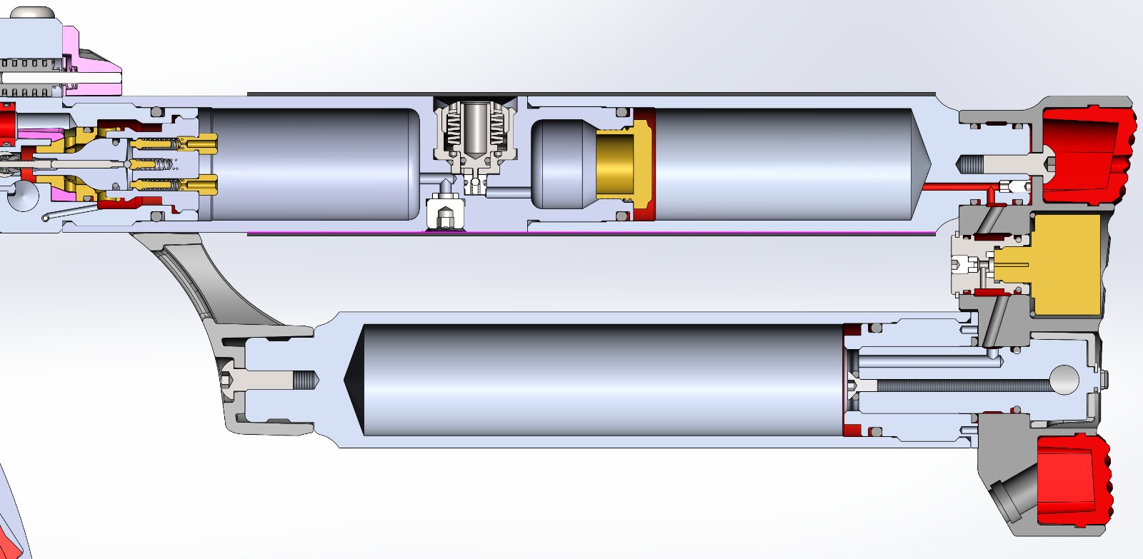

Here is the scheme of L2 back part, as you can see, the threads are free of pressure.
We tried to destroy the tubes while testing and always fail, the maximum pressure we could achieve was 800 bar.
Could it be that chamber was drilled too deep combined with that sharp corner. Atleast to my eye it seems that is going far deeper on that fractured tube if you see material is really thin due that corner overlaps with out side bevel. Alltho other theories were that it failed from threaded side but I really fail to see how it could seeing threads are not under pressure unless the fellow managed to leave that o ring away and make it seal from outside.
Reactions: qball
The issue was the treaded area was pressurized nothing else is at fault. The cross section of the tread bore is to thin for that pressure. The Inboard oring was not in place and having a outboard oring is never a good idea so i have no idea why its there at all. Because the inboard oring is missing all the pressure is being held back by the outboard oring which then in turn puts all the tank pressure on the thin threaded area. THIS IS WHY IT FAILED.
Yes but the problem with that theory is that there is no place for outside O ring.. and I bloody highly doubt it you could manage to make it seal by placing O ring on bottom of threads ans just screw it on place..
I know the threads are free of pressure by design. The oring in the failure picture is not in the position it was designed to be in.
Whether it was there prior to event or blown there during event, I do not know. But it is in the wrong position in the picture of the event.
Dave
Are they talking about the oring on the plenum next to the repr reg? The threaded area?
When you built tube you always have o-ring sealing pressure in before threaded area just like in leshiy 2.. but in picture of exploded chamber o-ring is placed on bottom of male threads leaving threads pressurized that could result catastrophic failure if you manage to seal it somehow by placing o-ring there and leaving o-ring groove empty so pressure in chamber actually moves between threads. Im not sure how it could seal that way since leshiy 2 aint designed to have that o-ring sitting there.
