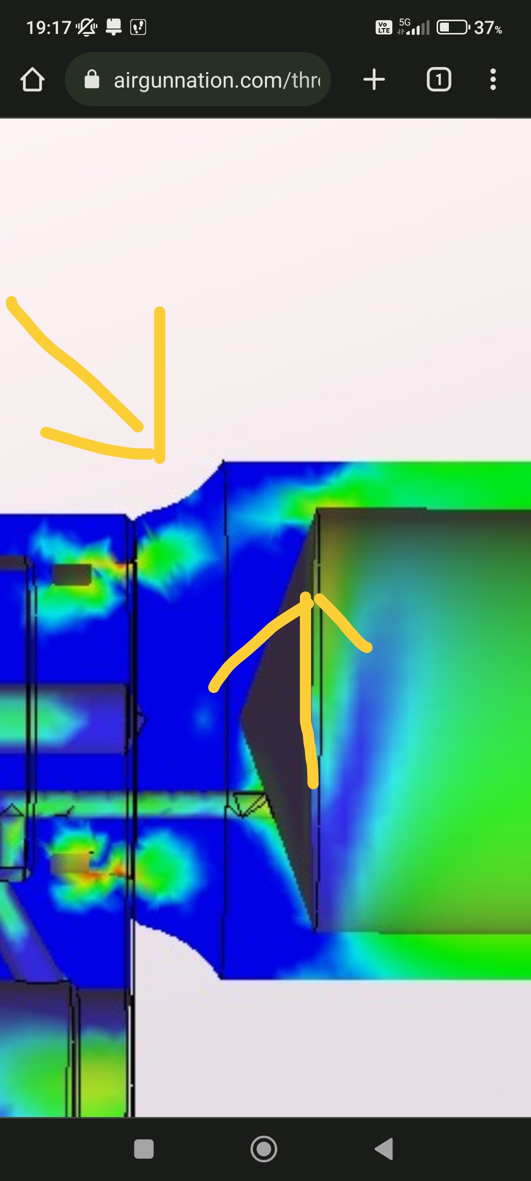

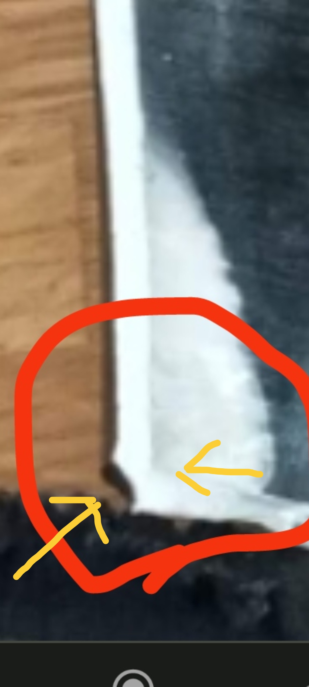

It is just speculations, but I agree with slugmaster about the side bevel seems to be missing on the oposite end of the threaded area. If the inner hole of the tube was drilled flat (which it look like on the picture), and to deep, it could weaken the tube. About the O-ring, my guess it was blown back, when the air rushed over it.
Even if it would be drilled to deep the weakest point would be in the middle of the tube, not in the side of it. Look at this picutre. here you can see how the strenth is located on the gun while under 300 bar pressure (calculation in the program). That is the minimal strenth limit. Nevertheless that the strength is concetrated at the edge, the whole strength limit is equal to the whole tube on the full length of it. Even if we speculate that the metal will start become weaker in this point the whole strength will be delivered to the deepnest of the metal and there is a lot of additional strength (the blue area around). So, the bottom here is not stressed too much. And if the tube would blow up most likely the bottom wasn't the point where it had been started.

That Leshiy tube looks awful alot of different than in your modeling....
The apparent discrepency you are pointing out, it's unclear if that's the original milling or if that's a mechanical tear from the explosion, the cutting done to present the picture, or perhaps stems from some other issue entirely.
There's a lot of issues in those photos. Difficult to tell what is cause, and what is consequence.
I still believe the oring was not in the gland and got trapped by the heavy beveling of the air tube up against the body of the gun resulting in the separating of the thread cross section. Either way thank God no one was hurt. Ed will figure it out he knows what he's doing he is not new to this and has a good reputation and builds very good guns.
