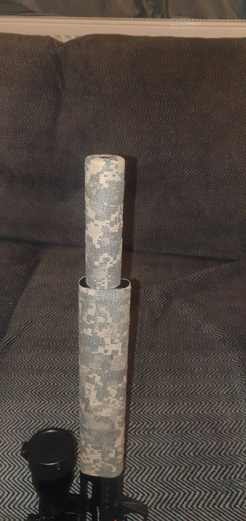

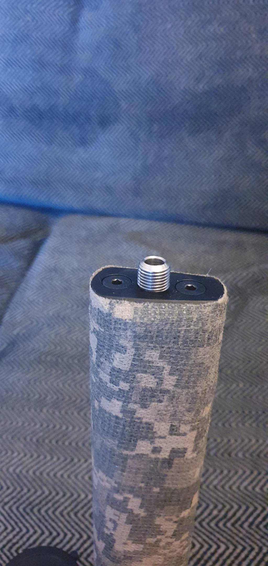

So, I've modified my leshiy 2 with a 1/2 UNF thread to accept an additional moderator.
I've only been able to test it with the moderator off my FX crown (which itself has been modified with a "hair curler" internal setup). But it has made a big difference with the sound report! I've only been able to test it without firing anything, should hopefully be able to get out tomorrow and test it with projectiles.

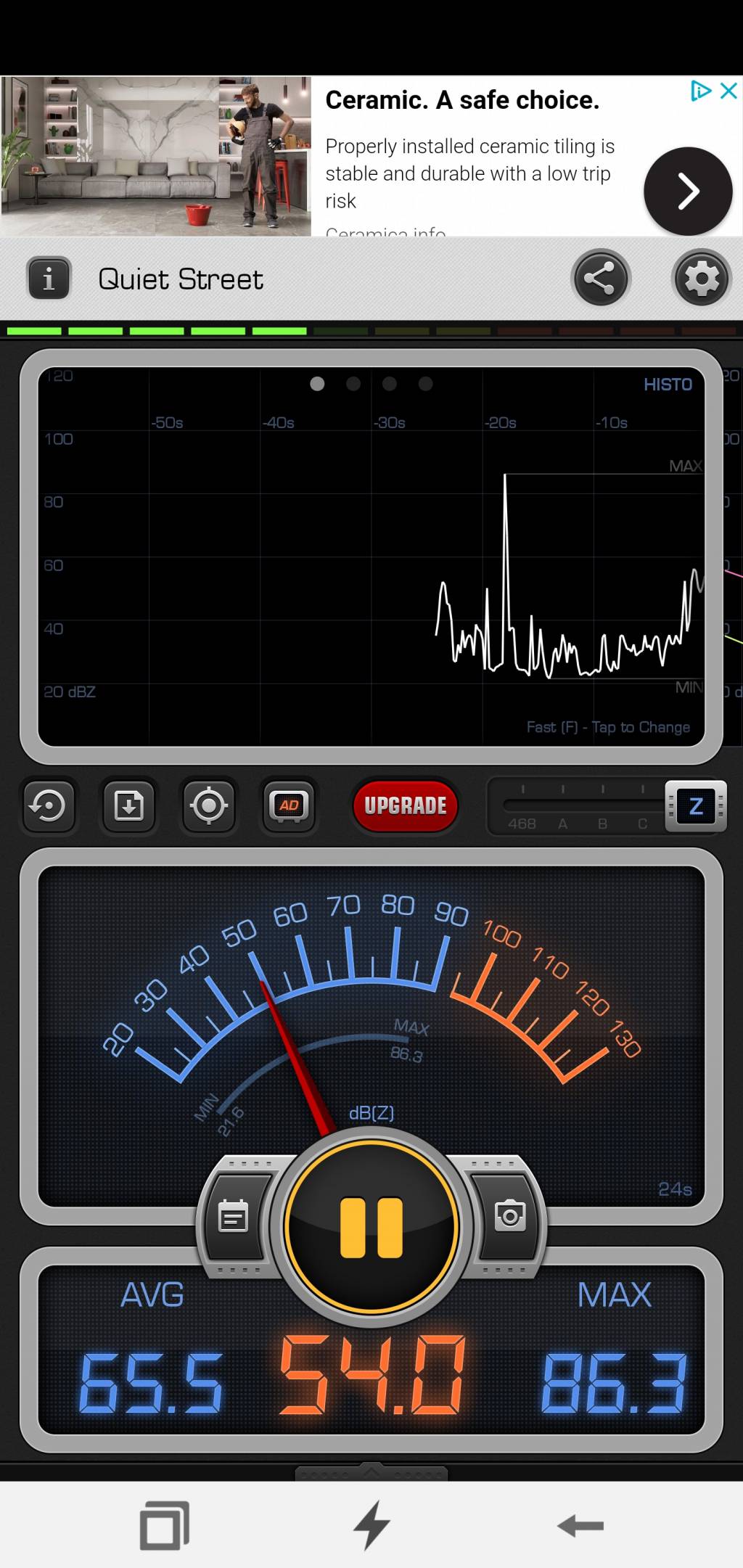

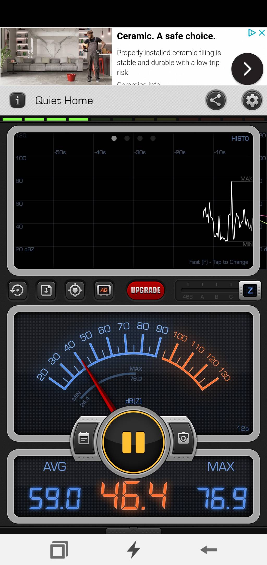

I took a video with a firing with and without the moderator, but it really didn't do it justice so dont see any point uploading it. I've got a dB app on my phone, it was approximately .5m to the side and 10cm in front of the moderator. Here are the results.
