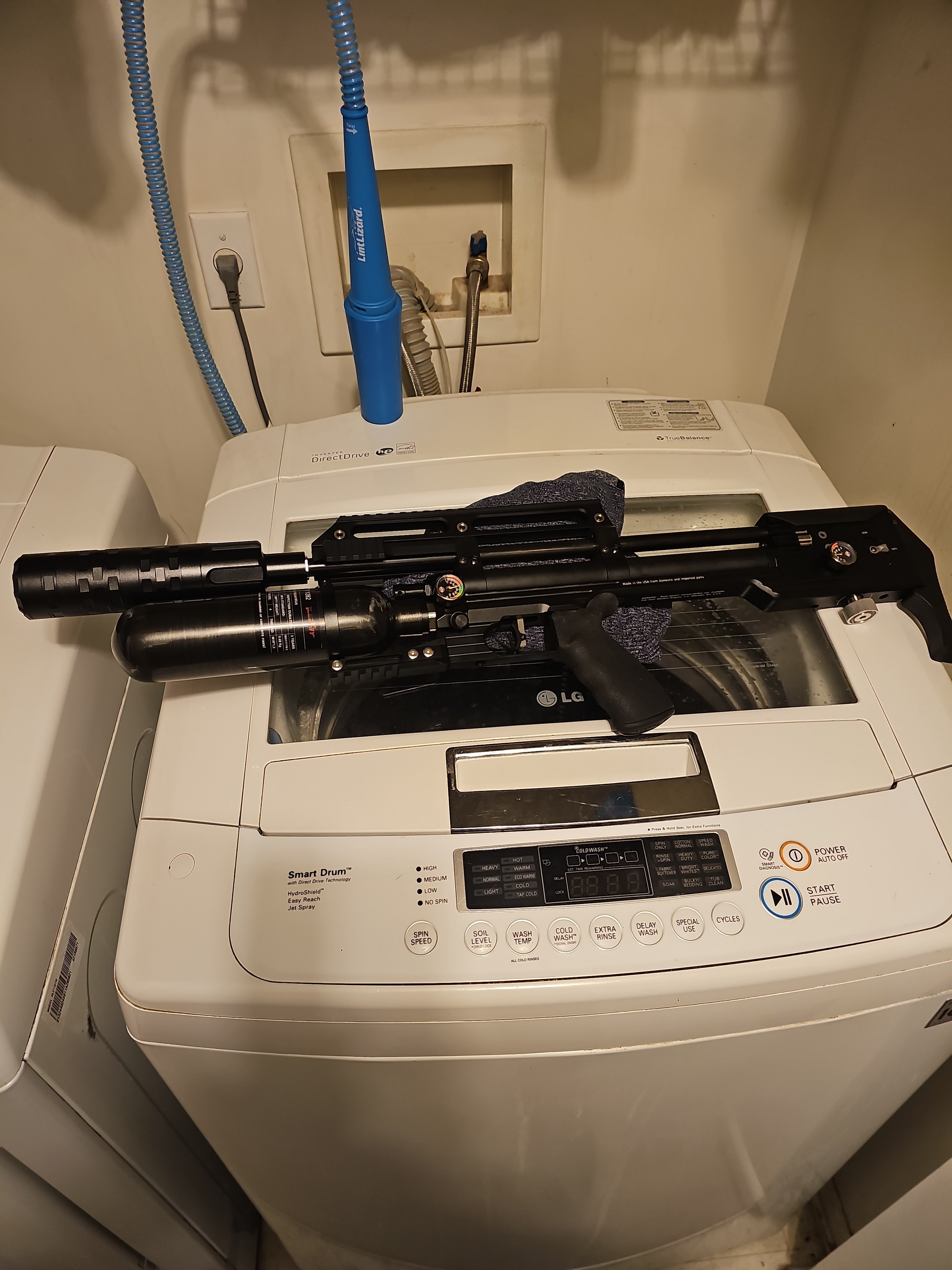

Brian at Edgun West has the Sidewinder compact pro with the Behemoth moderator and a 350 cc CF bottle. Its very quiet I mean really quiet. Its on my.washer cause i had my Alkin W31 vertical compress or plugged into the only 240 volt outlet. Alkin was filling my CF Joe Brancoto Great white tank. Which i then used to fill the tank on the sidewinder then shot a starling in my backyard. Its a keeper in my opinion. Specs are on Edgun West websight.
Reactions: Krofer and dflo
Thanks! That looks like a great configuration. I like this. The Behemoth is getting good remarks everywhere. What caliber is your quiet sidewinder?
