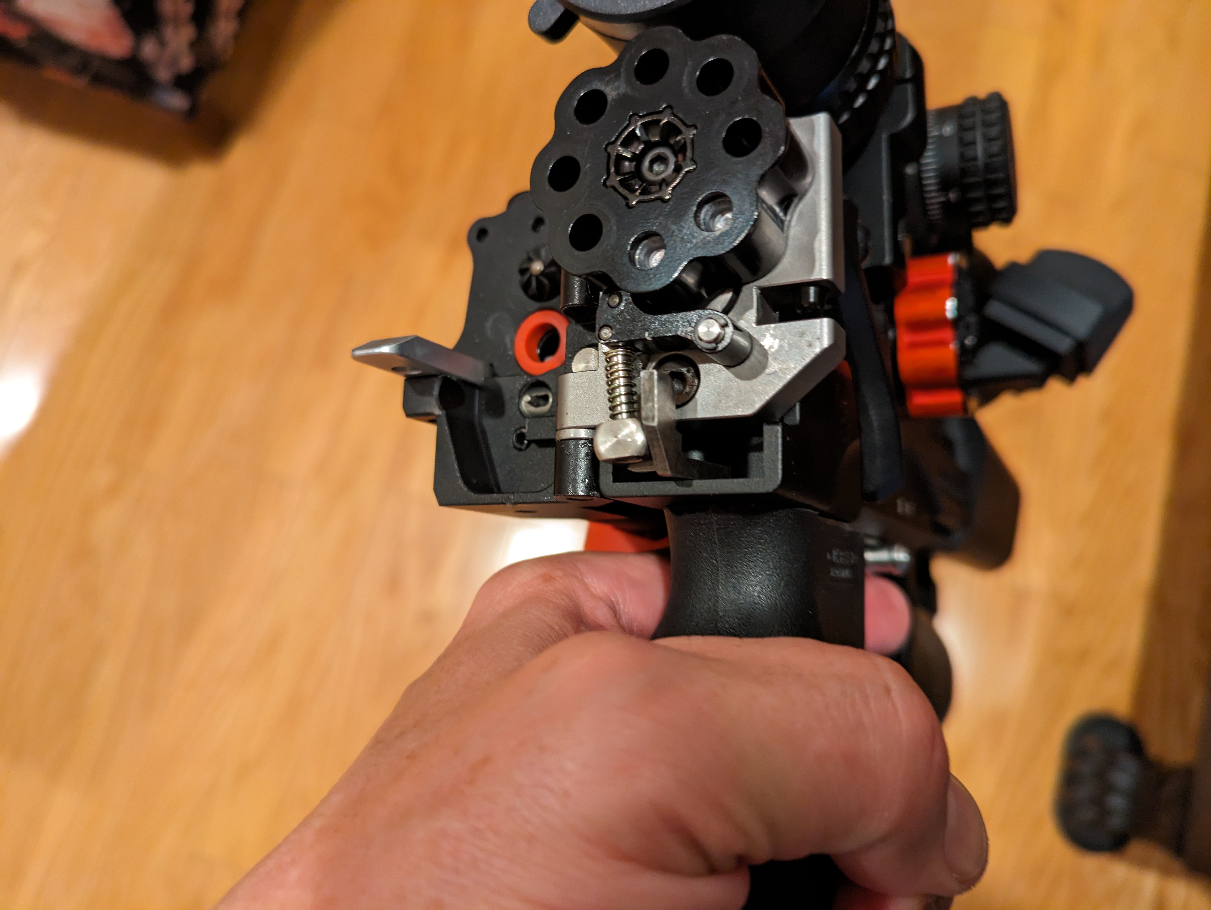

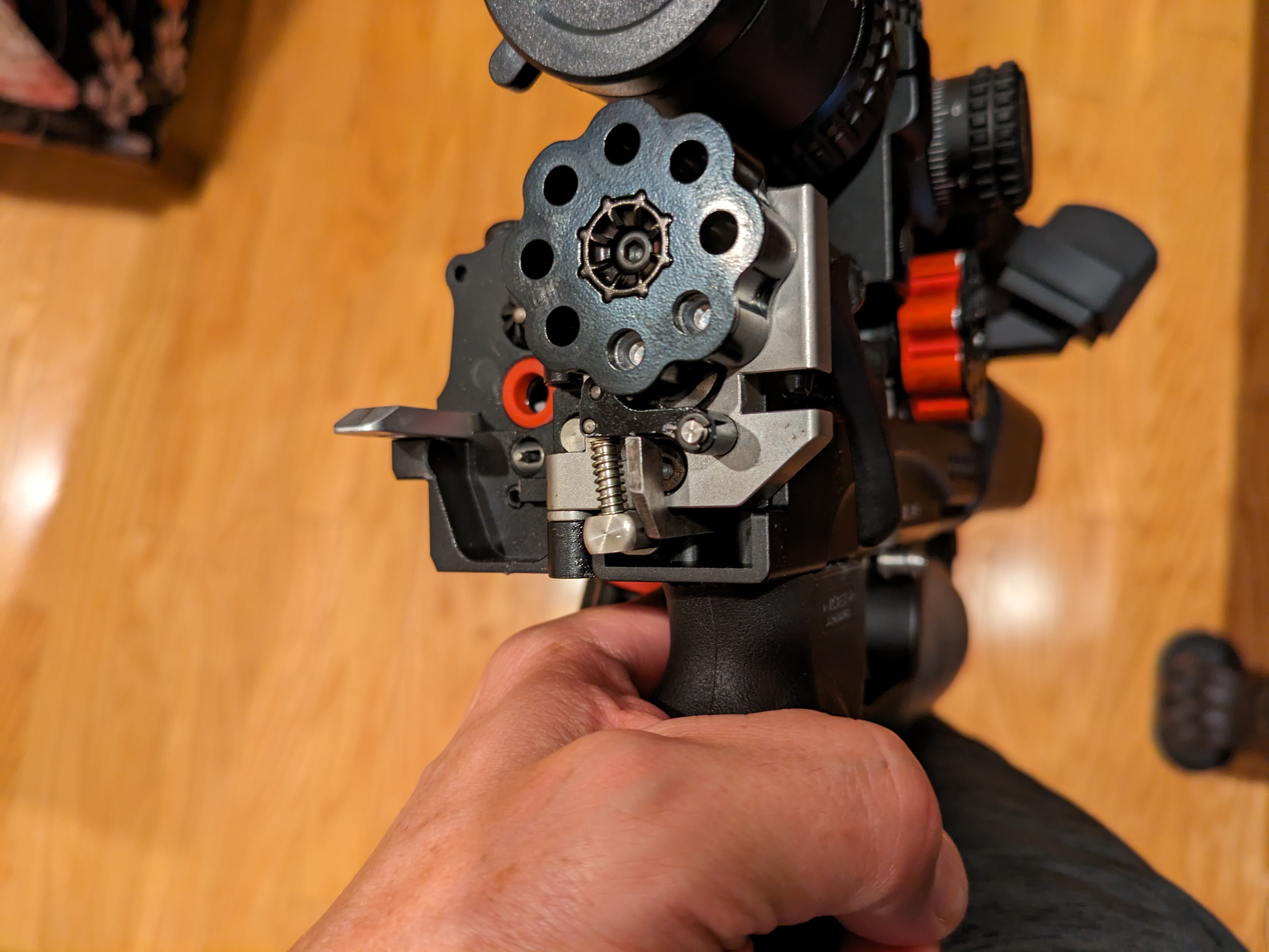

Maybe you can help me with a new problem. I filled my bottle, set the reg dry firing with empty mag a few times, put a mag in it and shot 4 rounds and went back inside. I went back to shoot a few minutes later and the trigger would do nothing. I can open and close the buttstock and flick the safety and usually get one shot but them nothing and i have to fool with it again. I tried adjusting the trigger a little both ways and neither made a difference. I have tried the reg at 120-150 bar now, it was around 140 bar before the Oring burst. and it makes no difference. I am attaching a pick that shows what i thing is the firing pin and the trigger lever with the safety disengage, do they look to have the correct orientation? I was having a hard time finding a pic to compare mine to. It feels like the trigger isn't engaging the pin, there is no resistance, feels almost like the safety is still on. If i can provide any more details please let me know.

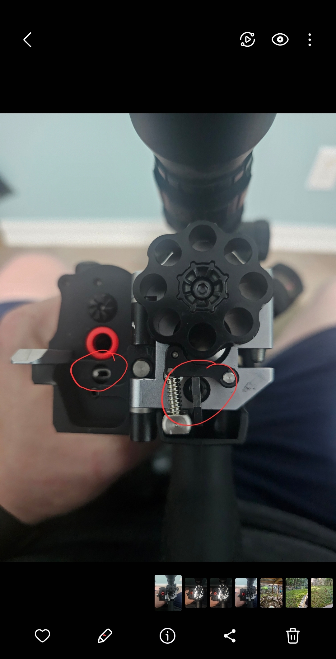

my trigger bar looks kind of crooked (or whatever the part in the right circle is, could it be physically missing the firing pin?in the left circle is the firin pin supposed to be on that side. I dont have another gun to compare them too if you dont mind opening one of yours and comparing or sending em a similar pic.

You shouldn’t be able to move it by your finger I guess is what I’m saying if it’s ok. And the bar goes in and out smoothly? How much free play do you have in the trigger in fire mode ?(first stage basically )
It’s possible if you don’t have enough free play in the first stage your trigger isn’t resetting. Back out the small screw behind the trigger until you get some free play

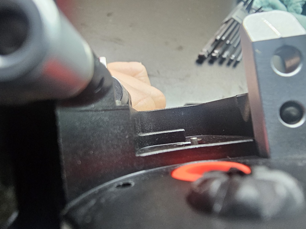

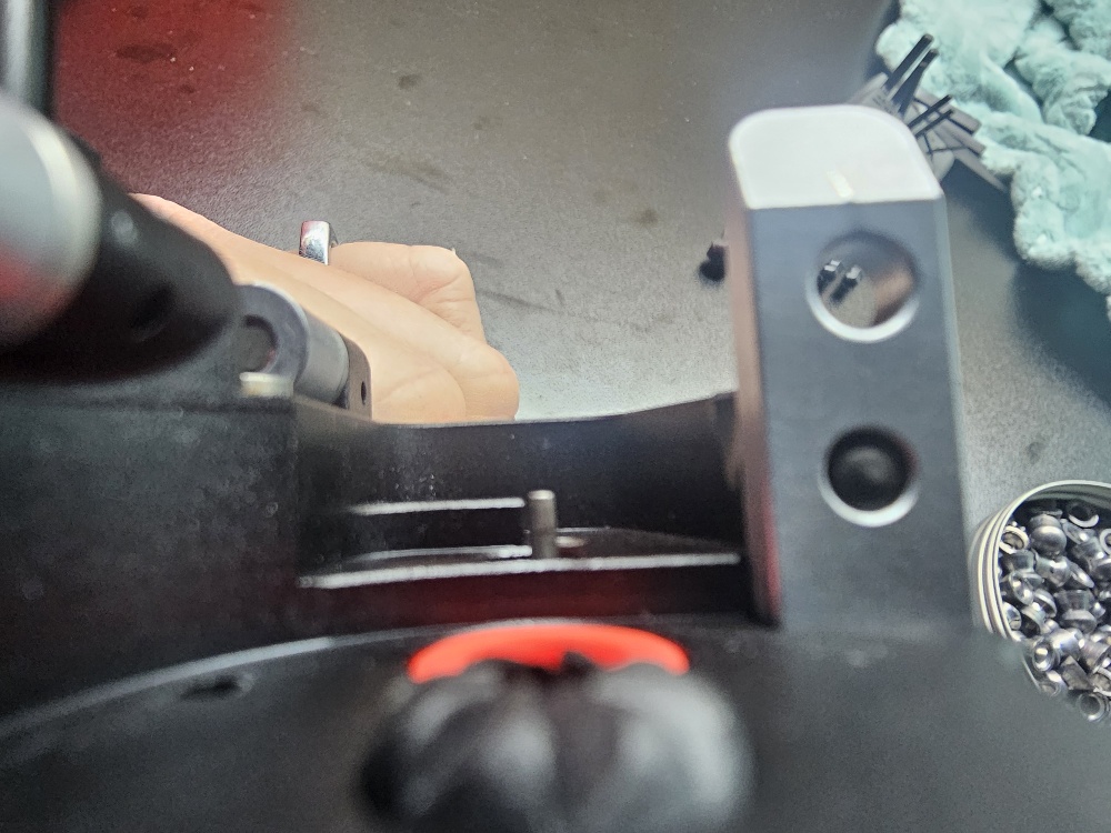

after i fire the gun the pin will be all the way out like in one of the pics and then i can press is in a little then it stops. once i press it in the gun will fire 1 time and then the pin will be out, and i press it in and it works one time again. i have adjusted the trigger far out in small increment and its still doing the same thing. I watched the trigger video before i first started adjusting it to see which way did what, my safety also work no problems.
