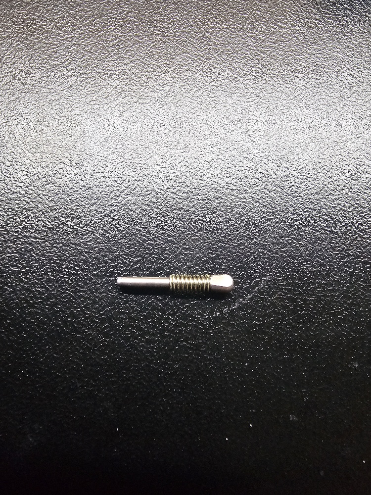

I bet you'll find the problem when you dig into it. I haven't experienced anything like this......yet so am hoping to learn as well.Thanks, mine looks similar. I think the issue is for some reason the pin in my last pics isn't resetting in the valve. guess ill take it apart tomorrow
Yeah imI bet you'll find the problem when you dig into it. I haven't experienced anything like this......yet so am hoping to learn as well.

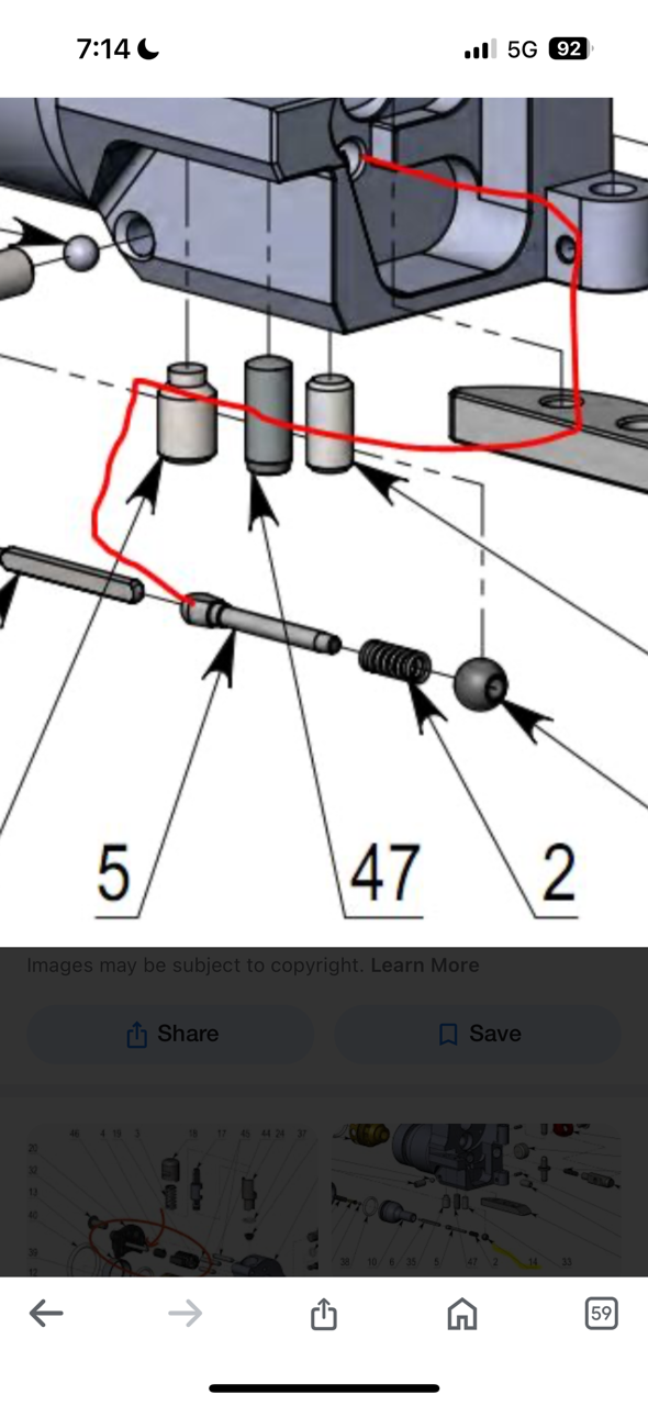

Yes sir that's it! The ball on the far right just above the #2 spring.
Makes senseYes sir that's it! The ball on the far right just above the #2 spring.
this video made disassembly pretty easy.
I couldn't have done it without your help. I'll update this once I reassemble but I can't image it's anything other than the missing ball.Makes senseglad you figured it out. These guns are simple.
KIS- keep it simpleI couldn't have done it without your help. I'll update this once I reassemble but I can't image it's anything other than the missing ball.
