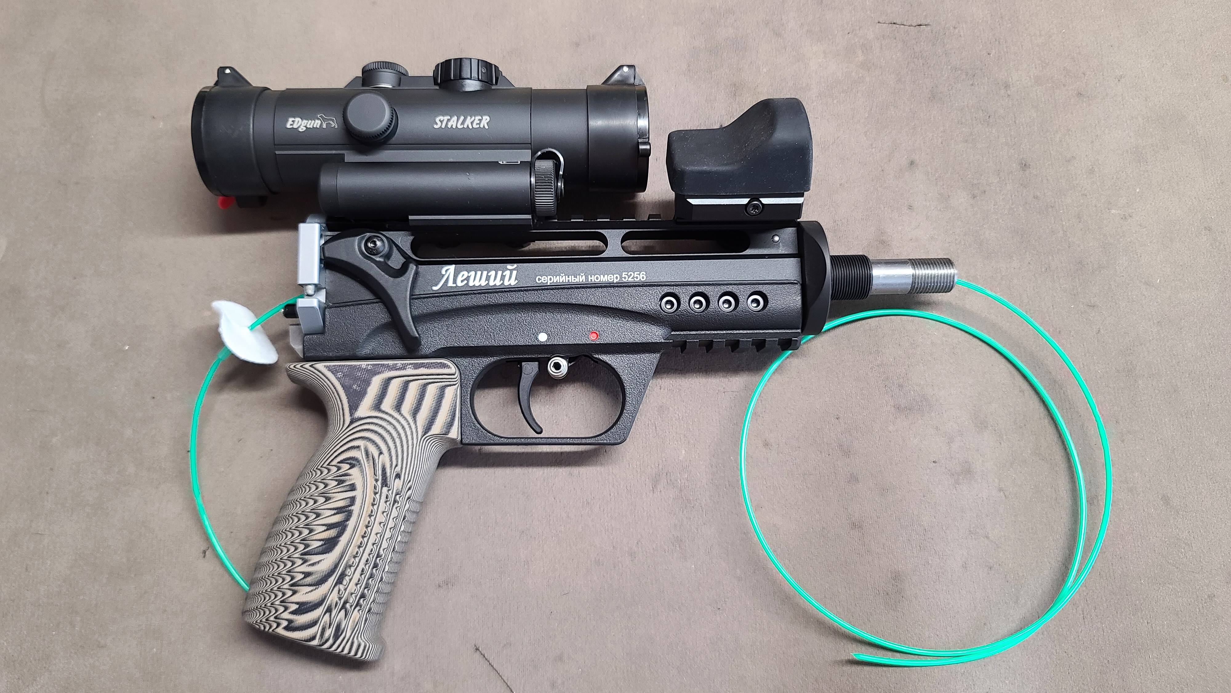

Finally got me a Leshiy 2 REPR. Came shooting as expected right at 900 fps (which is ideal for most people), but I wanted to dial it back a bit for some steel plinking drills.
I used the OEM REPR adjustment tool to reduce the velocity of the 18g pellets to 830 fps (27 FPE). I ran it through the chonograph while detuning it and for about 3 magazines afterwards
A few days later I found some time to mount the scope & dot, and clean the barrel.
Then I went to top off the air reservoir and "pffffft" all of the air slowly drained out of the regulator.
Problem? Solution? Thanks!

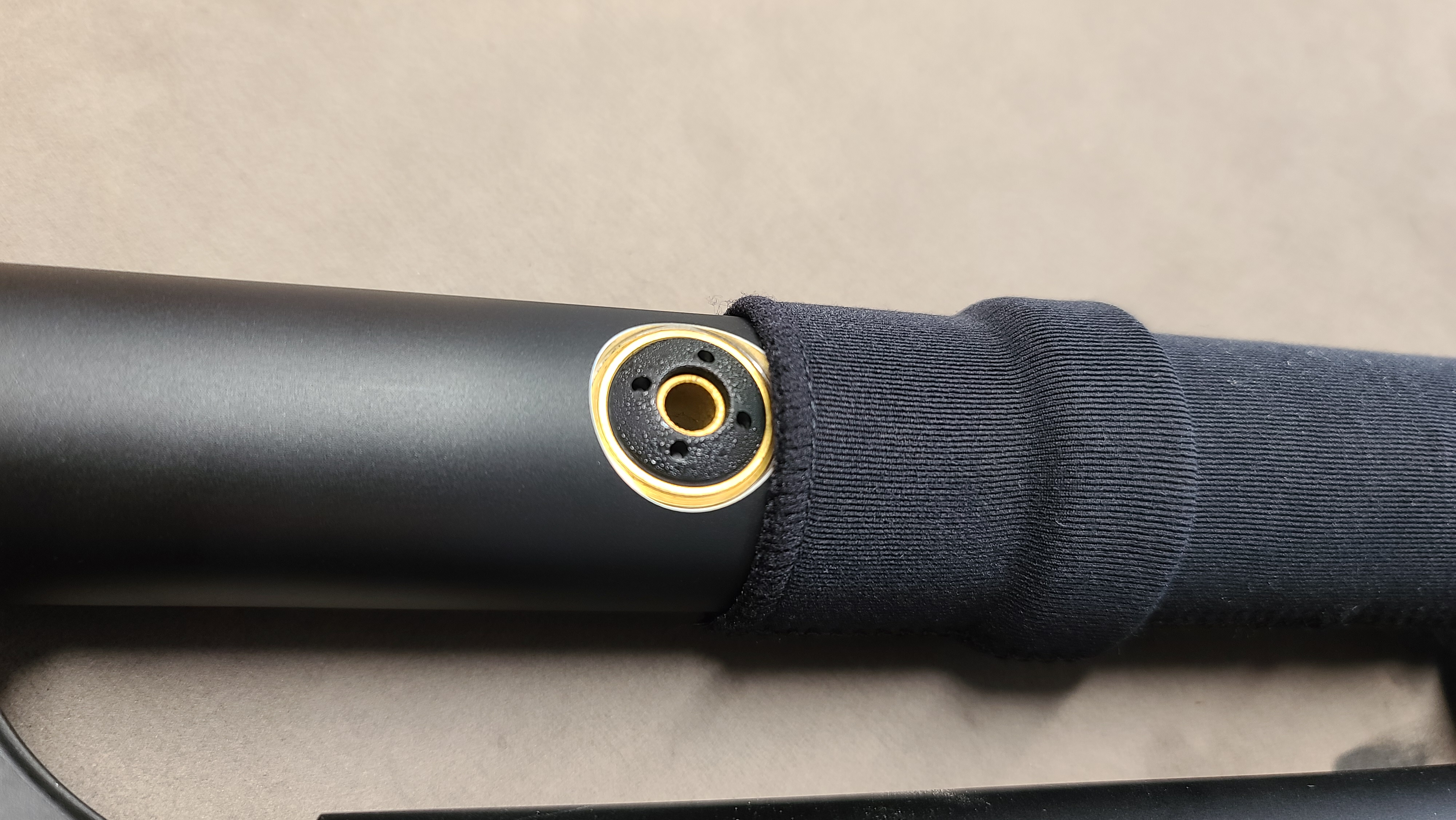

Well that was easy to fix. I degassed the air cylinders, removed the piston housing, pulled out the piston and washers, replaced the 1.5mm x 5mm o-ring, put it back together and filled it up!
I spoke to Brian and it sounds like there were 2 things I could've done differently.
1. When decreasing regulator pressure (I went from 900 fps with 18g down to 800 fps with 18g) it is recommended to adjust the regulator in small increments and simulate a few test shots via bursts of air with the bleed screw.
2. When the pressure in the air tube drops below the regulator pressure it is recommended to fill very slowly and dry fire a few times while filling (make sure to use the magazine without any pellets). This gives the delrin seal a chance to re-engage with the ceramic ball. If the delrin seal doesn't engage the ceramic ball then all the pressure is held back by the tiny o-ring (which will fail about 200 bar). I chose to dry fire every 25-50 bar while filling from empty
