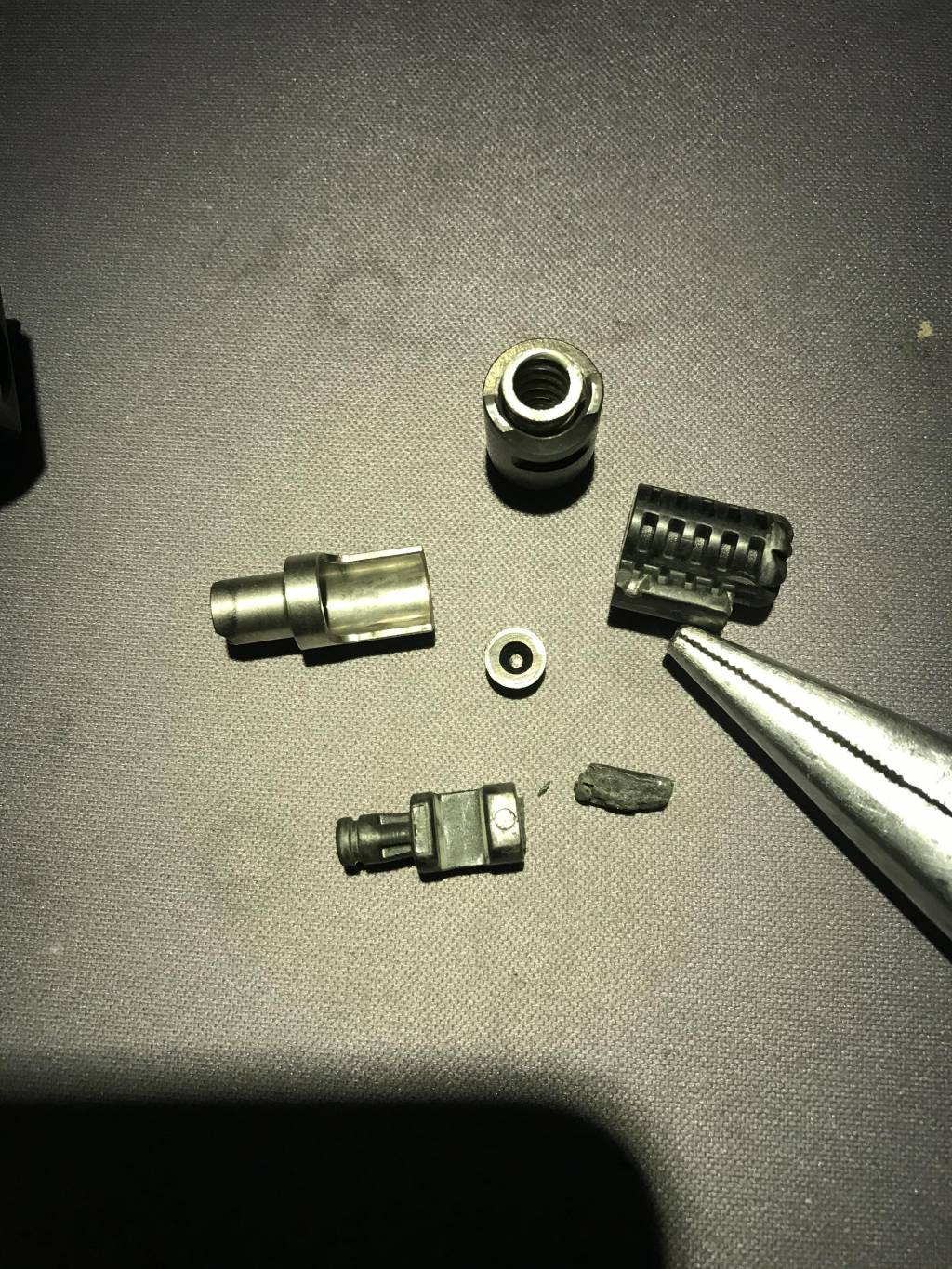

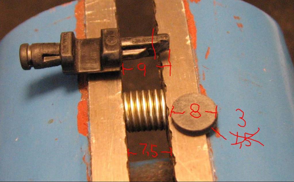

Tis but a scratch - no the L2 is very well built - yes the composite material used for the plunger failed, a new type is used now, no biggie
BTW, here's an easy fix to keep it going while waiting for the new part, just shim the spring to reduce the travel of the plunger, I made a shim punched out soft rubber placed inside top of the tower, now the compressed spring will take the blow instead of the plunger and the rubber shim will soften the blow, rubber shim OD 8mm x 3mm, lots of pellet through since, mag indexing no problems

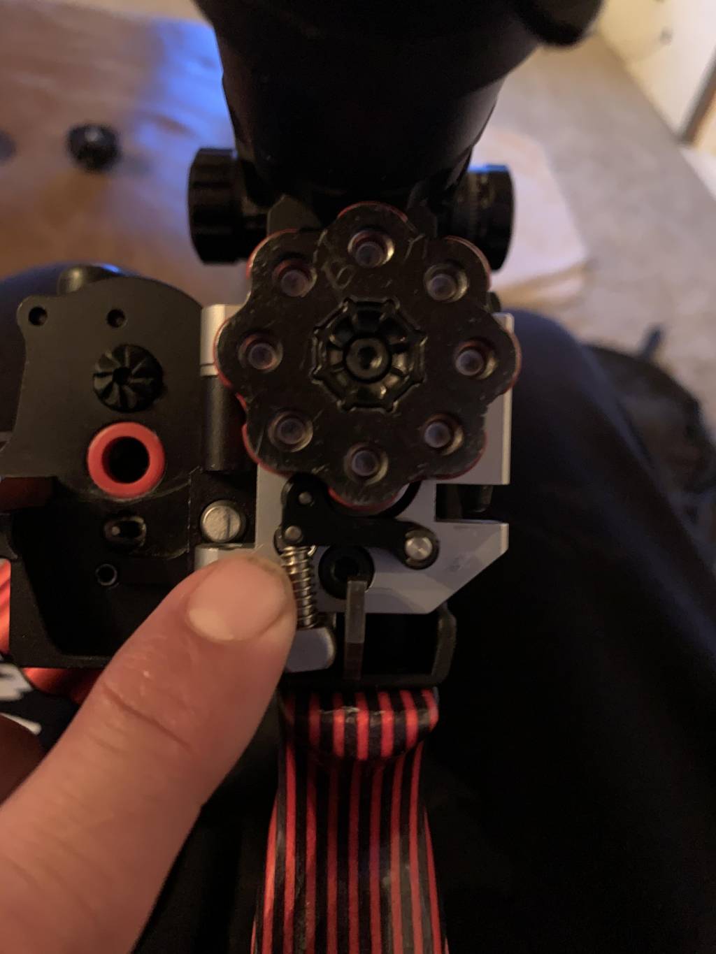

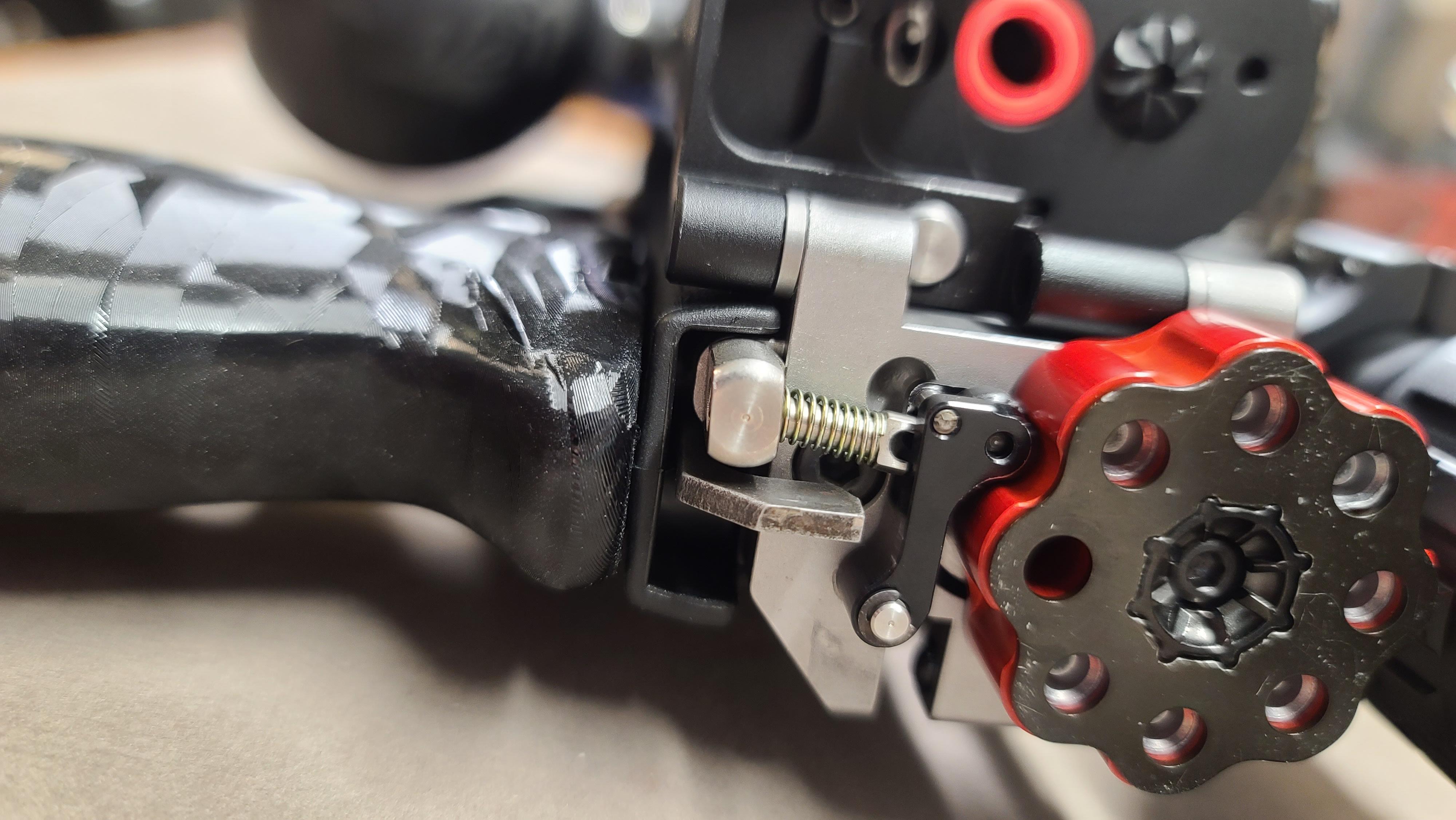

Kinda embarrassing but mine was doing the same thing, I tore it all down checked everything and it turned out the little arm with spring was not where it should have been
Yes that can happen if you pull the arm down by the spring guide to release the mag, I seldom remove the mag but load it with a speed loader
If I want to remove the mag I turn it 360/16 so the roller to rests on the high point, then I can reach an press the wheel down with my thumb and release the mag without any friction
The quick and dirty way (Francisco Rambo way) is of cause to turn and pull
Dang, you took the words right outta my mouth, I'm a little embarrassed myself. The little arm with the spring was just out of place! Wish I'd seen your reply earlier. At least I didn't start tearing it apart.
