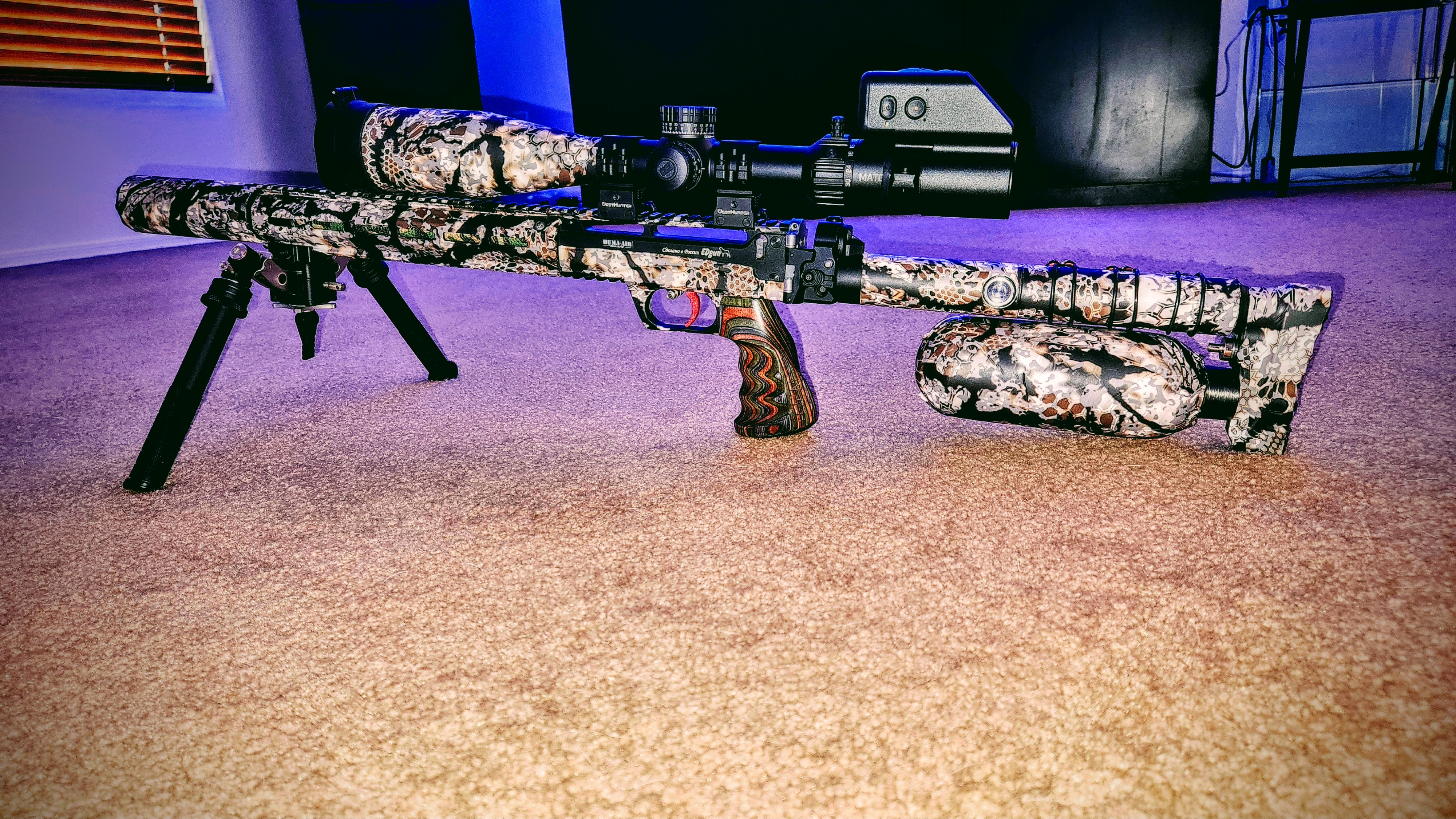

Huma mod 40 with a shroud setup 350mm and 300cc bottle. It might come up for sale with some extras. This thing has been 600mm with fx adapter for fun and setup as a lightweight for woods walking. It’s a fun setup, I used it mainly for armadillo on my property.

Huma mod 40 with a shroud setup 350mm and 300cc bottle. It might come up for sale with some extras. This thing has been 600mm with fx adapter for fun and setup as a lightweight for woods walking. It’s a fun setup, I used it mainly for armadillo on my property. View attachment 462590

Looks good. What kind of shot count on the bottle?
I own a .25 with 350mm barrel. I shoot the JSB King Exact 25.4 gr Reg pressure 130 bar, 0.5 and 0.6 jets. 350cc bottle. Speed around 870 fps. Shotcount 88 to 96 on the reg. Use is for action shooting and 50 yard benchrest. Hunting with an Air rifle is not allowed in my country.
