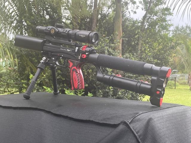

Plenty of shots??? I fill my 470cc tank on my L2 at home, take it to the range, it give me about 92 shots at 920 fps with the jsb exact .25. With Gk1 I'll need to take the big Scuba bottle at my back.Why not get a GK1? Even with the rear adapter and stock you'd be at a total of around $1400-$1500 and pocket the rest of the money. It's super accurate, gives you plenty of shots for it's small reservoir and it can put out as much power as the sidewinder .22.
Out of your 2 choices I would go for the Leshiy 2, customizable, quieter than the Sidewinder. Mags are expensive for both options.
Yeah exactly. I have a 350cc cf bottle that I haven’t used because the tubes are less bulky on the L2. I can get more shots but I’d rather have a skinny gun. The 9 is a different story if you have a tube you’ll get 6 shots lolcompared to the original Leshiy the L2 gets double + the shot count without the C/F bottle. I didnt buy it for shot count though.
Okay, in .22, from a 350b fill I can shoot the 16gr pellets at 800fps and get 3.5mags thats 68 shots. Shooting the 18gr pellets at 900fps I can get about 2 mags and change, that's over 40 shots, and I can shoot the 21.9gr AEA at 900fps for slightly over a mag, about 25shots. All that from a reservoir under 80cc. I can also get about 7 really good shots at about 62fpe. Hell I made a video of my gk1 shooting the Huben peanut 33.33gr and I got them shooting 989fps, that's 72fpe and it stayed within 40fps for the first 3-4 shots from a 8.4" barrel! Now I'm deviating, but if you read carefully you would see that I said it gets a ton of shots for it's small reservoir lol.Plenty of shots??? I fill my 470cc tank on my L2 at home, take it to the range, it give me about 92 shots at 920 fps with the jsb exact .25. With Gk1 I'll need to take the big Scuba bottle at my back.
