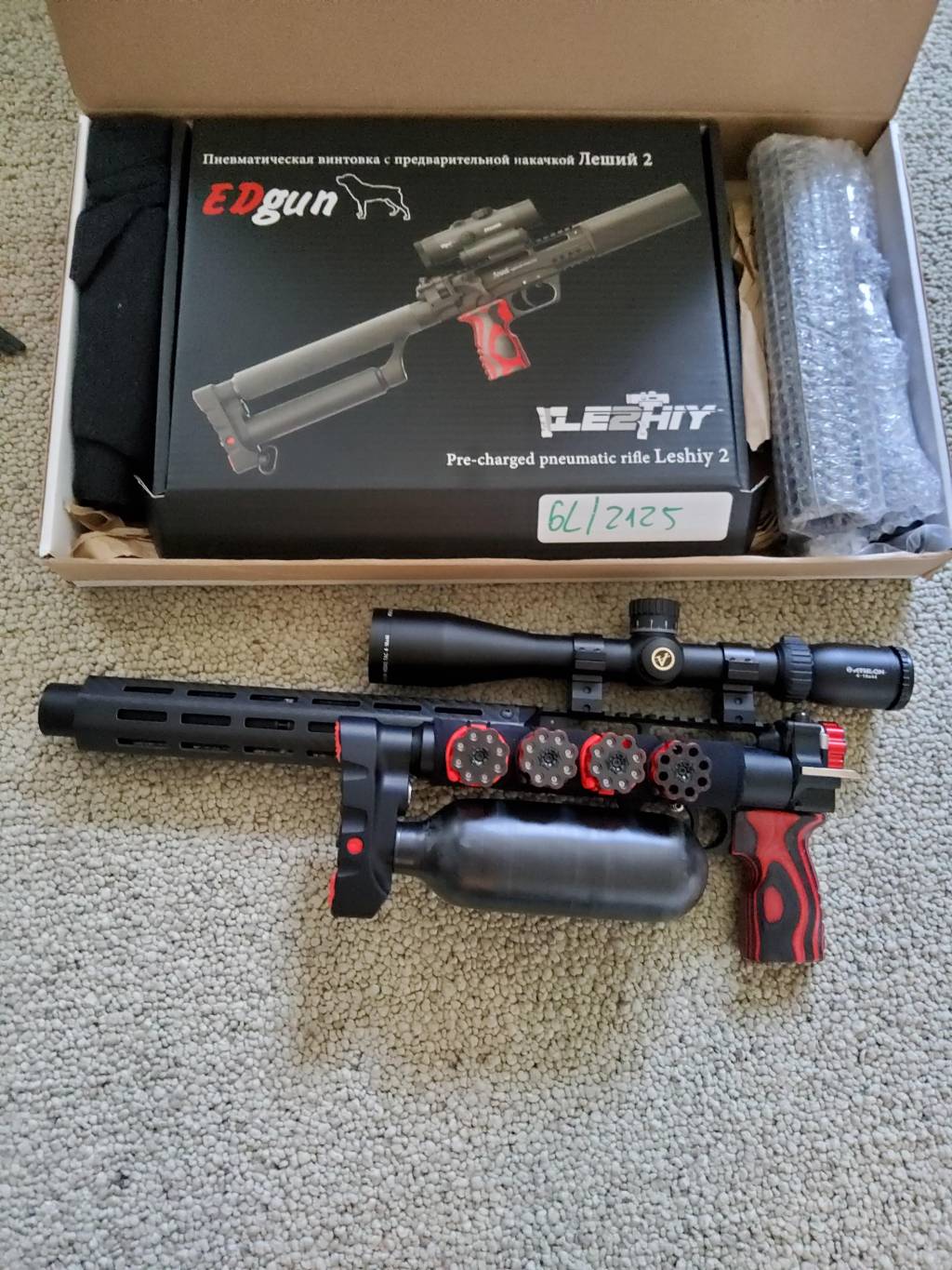

Order 161, received mine Christmas Eve...

I got the 25 cal, out of the box it chronograph at 890fps with JSB 26gr. I would definitely say on the loud side for backyard plinking too.. I will keep mine at factory settings because I am pretty happy with its accuracy out of the box... I was consistently hitting a 4" gong at 100yds while standing unsupported. The balance of the Leshiy2 with the 350mm Shorokh kit and 3.5L bottle is PERFECT!

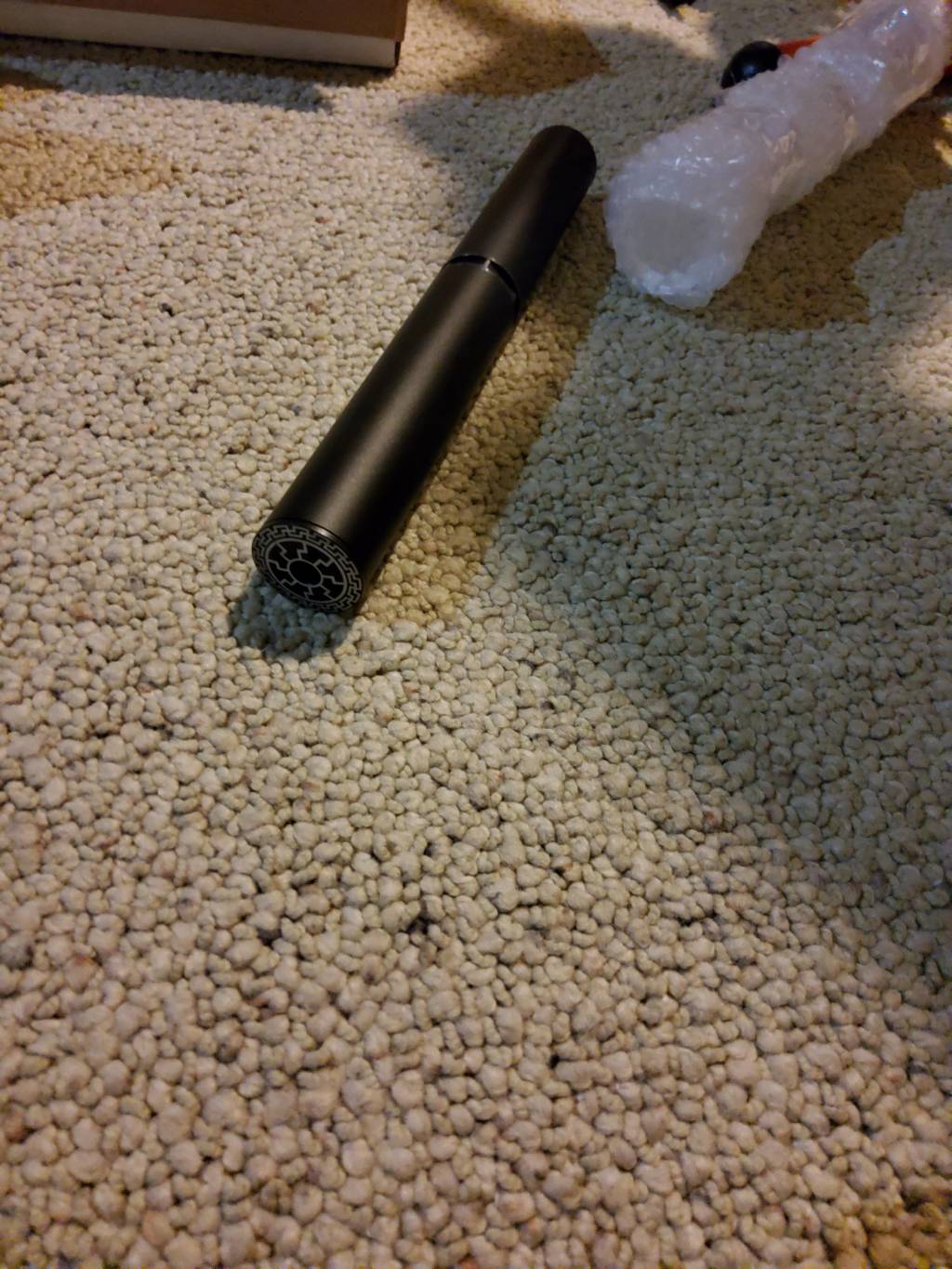

The report of the Leshiy 2 is different than most other PCP's because it's coming more from the valve area than from the muzzle and it sounds like a nail gun going off. You'll find that most LDC's won't make that much of a difference in overall report and will only change the overall tone. You have to really use the reg / jet adjustments to really bring the fps and dwell time down a lot to get any noticeable reduce in overall noise. Fun gun nonetheless.
