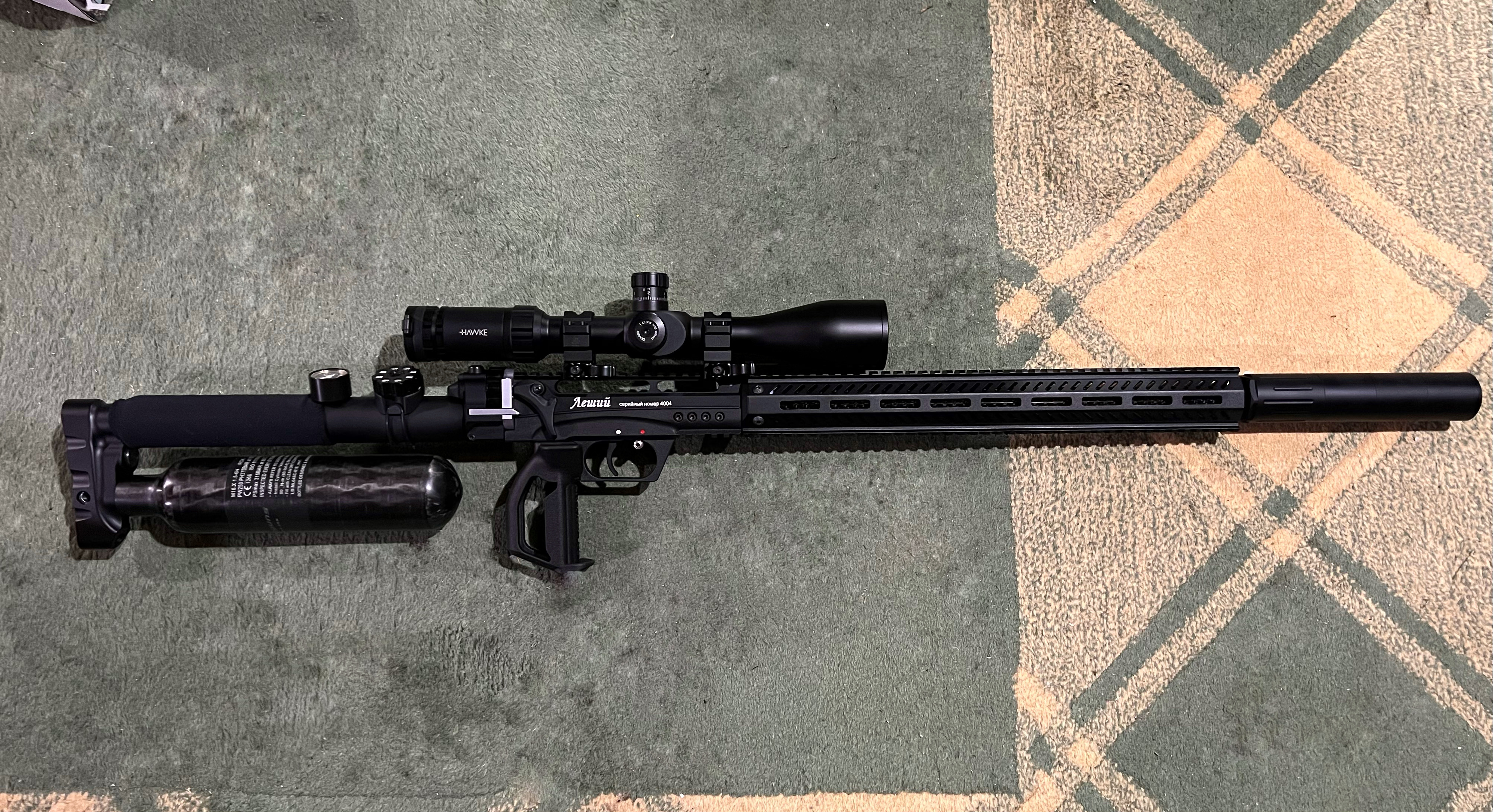

I have had 2 FX barrels on my L2. the first was a 600mm .25 FX and currently it is a >30 cal FX 600mm barrel. I have been very happy with it. In fact, in my opinion the accuracy with the FX barrel installed is better than it was with the original Edgun barrels. I cannot say if this is due to the FX barrel being superior (no pun intended) or if the fact that the Edgun original was 350mm versus the 600mm on the FX, but for whatever reason the gun is better in this iteration.

is the moderator in the above picture threaded to an adapter on the end of the FX liner?

Scouty,
The barrel I use is a FX Impact barrel without the shroud, so it has the liner contained inside an outer metal barrel. Other than replacing the "chamber" end with an adapter that allows it to fit in the L2 the barrel is standard and has a 1/2 X 20 threaded end at the muzzle, so the Huma Mod40 simply screws on just as it would on an FX rifle.

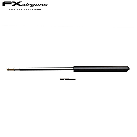

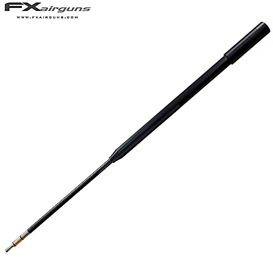

Bonjour à tous, j’aimerais passer par le processus d’adaptation d’un canon fx 600mm 5.5mm, j’adore photographier des limaces.
Je ne sais pas quelle est la différence entre ces deux fûts ou un autre mieux adapté.
Merci pour vos commentaires
FX AIRGUhttps://www.mundilar.net/fr/carabines-pcp/carabines-pcp-fx-airguns/fx-airguns-stx-superior-heavy-liner.html#/versions_disponibles-5_50mm_22_600mmNS STX SUPERIOR HEAVY LINER​
https://www.mundilar.net/fr/carabin....html#/versions_disponibles-5_50mm_22_600mmFX CARABINES À AIR COMPRIMÉ STX SUPERIOR LINER​
Faut-il ajouter cette pièce ?
Et bien sûr l’adaptateur Huma.
Merci pour vos commentaires et bonne année

Do you already have any FX barrels or liners? If not, you would need a whole barrel set. Try to locate the entire kit. Plus the brass piece.
Something like this
utahairguns.com/product/fx-impact-stx-barrel-kit-moderator-not-included
If you need to start from scratch you better search for second hand
