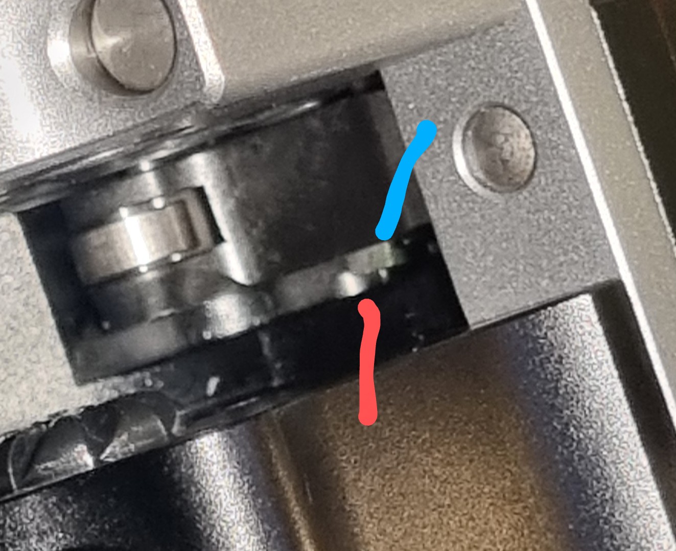

Would you have any more suggestions or fixes? Would it be possible that the trigger blade is not aligned with the valve stem so that it just pushes next to it, without engaging it?
@bigHUN thanks for your suggestion. Tried it, but nothing was visible. But it made me thinking that you can actually see it when the magazine is removed. The trigger rod is pushing just on the edge of the valve stem, and I feel a very little bump when it slides off. You can see it in the picture:
the red marker indicated the valve stem. The blue marker is the trigger rod. Both do not connect, hence the gun does not fire.
Very strange, I didn't have the issue before and suddenly it was off. Does anyone know how both can be aligned again?

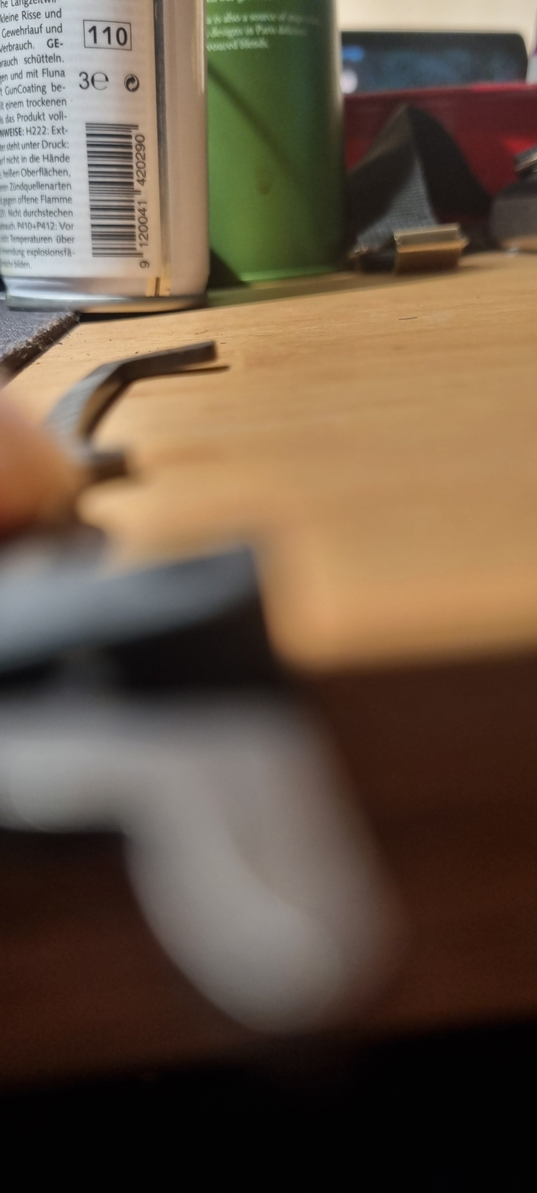

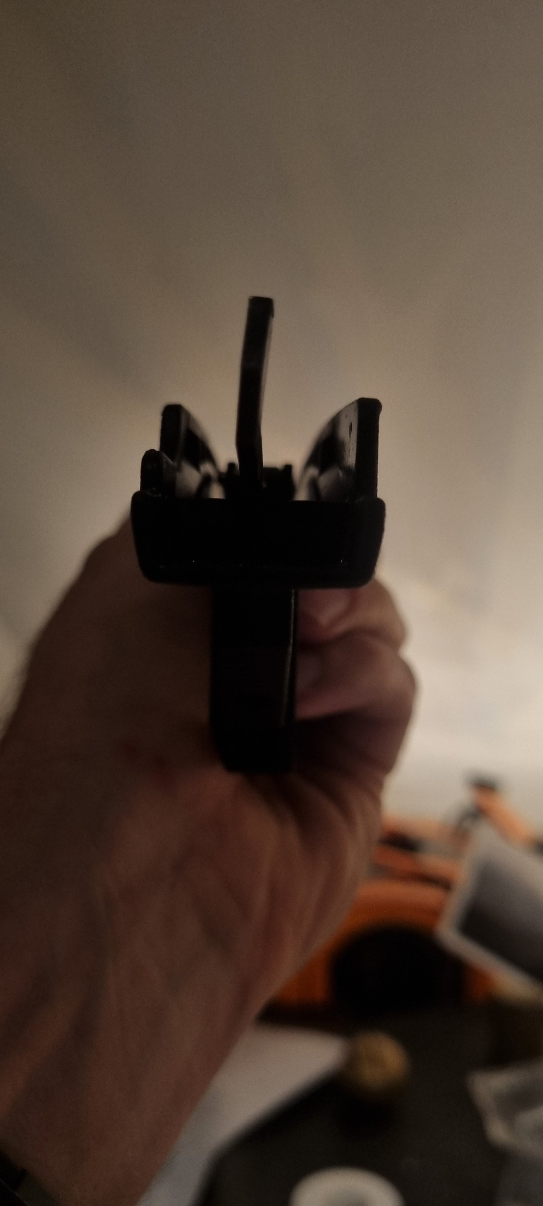

Ok so I found it! I opened the trigger unit, and found out that the trigger rod was slightly bent. See the pictures below. Some twisting of the rod bent it slightly back, and now my gun fires again. But it was a pita finding it out, and it spoiled my shooting day :(
Some remarks/learnings:
  • the rod is fairly sturdy, so no idea how it ended up bent. I have a new gun.
  • I bent it back slightly, but not yet enough. We'll see how long it holds up. If the problem comes back I'll need some more forces with pliers instead of fingers
  • I'm not a big fan of the trigger unit. I'm in general impressed by the engineering of the gun, but the trigger unit seems to be below that standard (plastiky and finicky).
  • If I were the designer (I'm not :) ) I'd make the rod thicker in the end. Now it's very easy to miss the valve stem with a slight misalignment.
  • for those who have the same problem: it's not that difficult to fix it once you know where the problem is.
