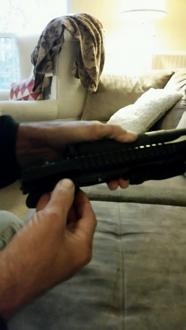

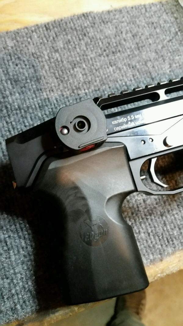

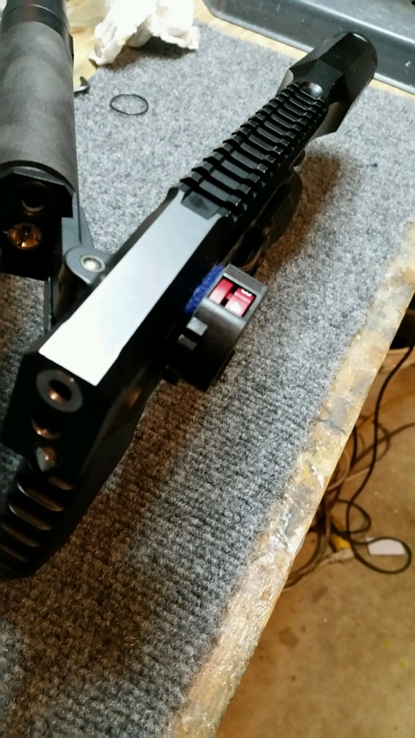

Just picked up a Leshiy and saw some really nice ammo holders, but apparently no one is making them anymore. Then I saw the Gamo Swarm mags and thought "If they are like the BSA mags then they just might work". Figured for $14 I'd see. Well they are just like the BSA only plastic and with an o-ring. Remove the o-ring and you have a very inexpensive ammo holder for cheap $$. All you do is Velcro it to the frame. The spring tension keeps the pellets in the mag. Just cock the gun, lean the gun to the right side. A very slight rotation of the mag and the pellet will drop into your hand for loading.

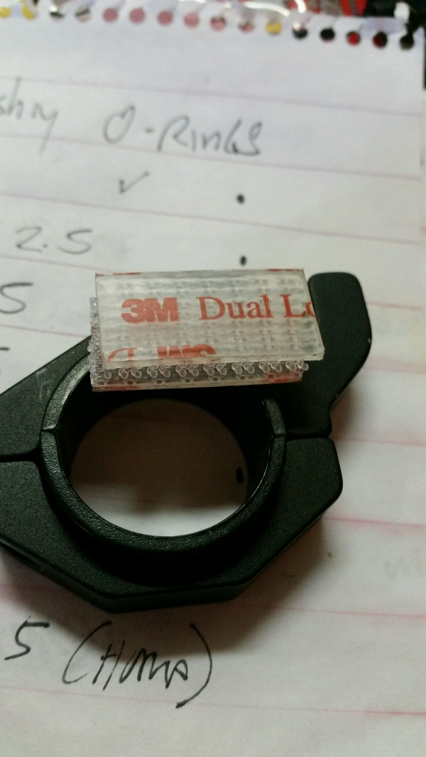

Found something better then the velcro, 3M Dual Lock strips. They were in my EZ-Pass. I like them better then the velcro as they hold tighter. With the velcro you can kinda slide the mag back and forth a bit. I'm sure the velcro will wear quicker too as the mag is much easier to load when removed. Each of these pieces are hard like the hook part of the Velcro fasteners, but they fit into each other.
This seems to be the cheapest price.
https://www.ebay.com/itm/3M-Dual-Lock-Sold-in-lots-of-4-Sets-for-1-00-ONLY-Black-or-Clear-Available/141928702069?hash=item210b9c2075:g:DJsAAOSwyjBW5ZKQ:rk:1:pf:0

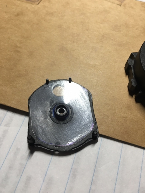

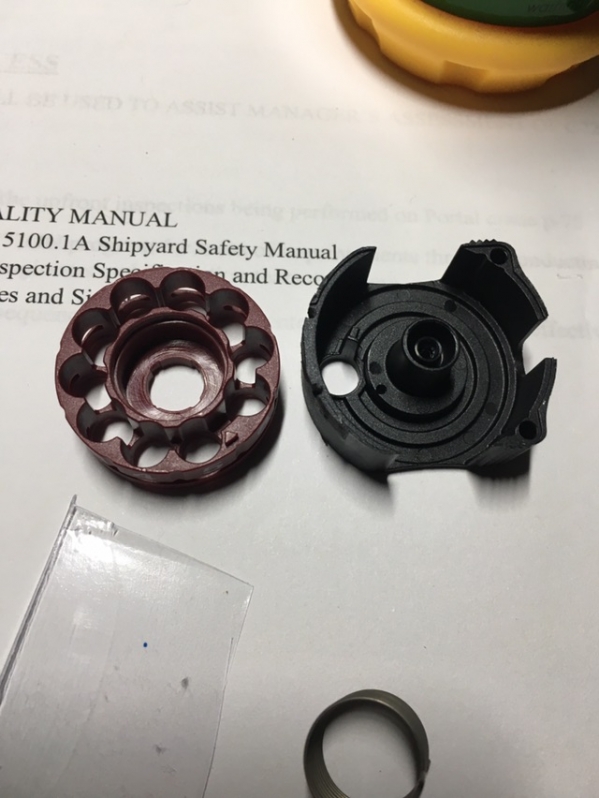

So I got this and right off the bat I ran into minor issues. The pellets had a tendancy to hang up when loading pellets because they would fall right through the mag out the other side.
But here is how I resolved it and now it works like a champ!

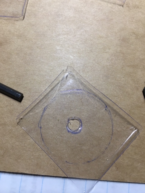

I took the mags apart and added a plastic film to cover up one side of the hole to keep the pellets from getting snagged when filling.
Now that the other hole is covered, loading the pellets are really easy!
This thing works really well!

Toku - sounds like you are loading from the "exit" side of the mag. Actually that's a great idea to put that there and you can load that way, with the mag still attached to the gun. When I tried to load with it attached (thru the exit) the pellets did fall too far into the mag, and I had to shake it to get them aligned. Without the mod it is much easier to load by taking if off.
I had a BSA Ultra so I am used to loading these mags. If you hold the mag wheel between your thumb and middle finger your index finger should wind up right in front of the hole. This is how I always did it.
Reactions: AirRanger
Yes I tried to load it from both sides. The Exit had a higher chance of getting hung up. (Dropping it in tail first)
I have my mag mounted to the gun's picatinny rail so taking it off isn't an option. Was getting to be a real pain, having to jiggle the mag to rotate it while loading.
Now the pellet just drops in and rotates just fine. I'm loving this! Wish it could hold more pellets. I'll probably end up mounting 2 of these onto my scope.
