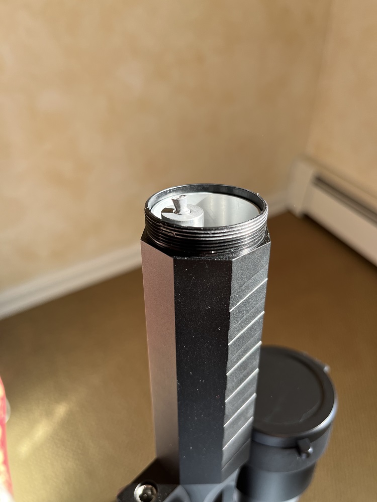

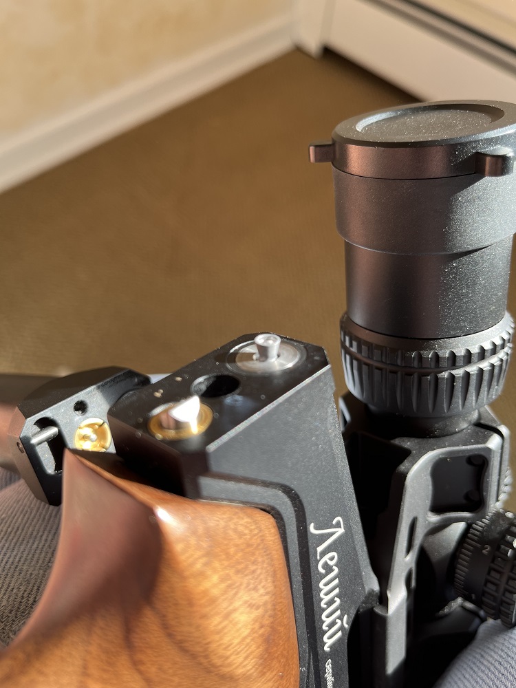

I would check barrel orientation while it's still installed since it's the 350mm. Unscrew the shroud extension and gently try to seat a pellet in each end of the barrel. The head will insert slightly further into the breech end.
I can't see the chamfer on the breech end very well so this is how I do it.
Thought I should mention that I do this before installing a barrel but in your case I'd just check while it's still installed. And then whether it is backwards or not I'd remove the barrel, clean it and then reinstall with only gentle torque on the retention screws.
Take care to be sure the shroud insert is properly aligned when re-installing. The factory insert is way over sized for 177 so I doubt this is a problem. But if you happen to have an Akula or CCD insert I could see alignment in 177 being a problem.
I don't suspect a dirty barrel, mis-aligned insert or over torqued screws are causing your spiraling but I doubt you'll make you accuracy worse by doing all of this.

I checked barrel orientation. It seems to be correct based on the way the head of the pellet drops in. See pics.
I also cleaned the barrel and still have the spiraling. Maybe later today I'll spend some time turning down the speed. Though I really don't want to be lobbing pellets at my targets.
