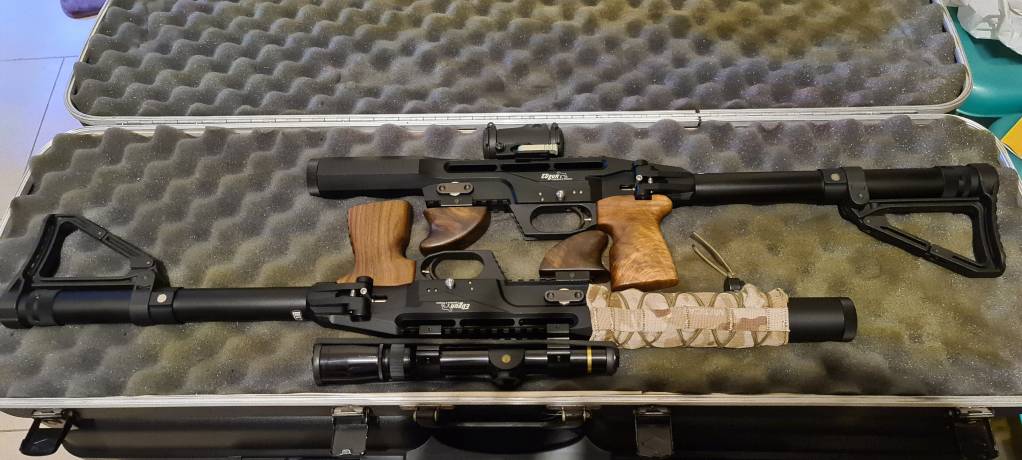

I have 2 leshiy classic in .177. Both have huma 12 fpe reg install. My first leshiy with 250 cm barrel, I set the reg at 65 bar (with derlin insert) and using jsb 8,4gn, I get speed 666 fps avg (8,2 fpe) and 80 shot from 220 bar to 60 bar fill.
My second leshiy I set the reg at 90 bar ( also with derlin insert) but with 350 cm barrel. I get 800 fps avg (12 fpe) with jsb 8,4gn. I get 50 shot from 220 bar to 80 bar fill.
I use aimpint red dot sight for 250 cm leshiy for close range (up to 30m) perfect gun shooting red, and I use leupold 1-5×20 for 350 cm one.
I have a lot of airguns, but I love these leshiy classic very much because of their light wight. Both under 2kg.
Note: with my 350cm leshiy, if I change the barrel into 250 cm without changing the setting, I get around 10 fpe with the same shot count.
