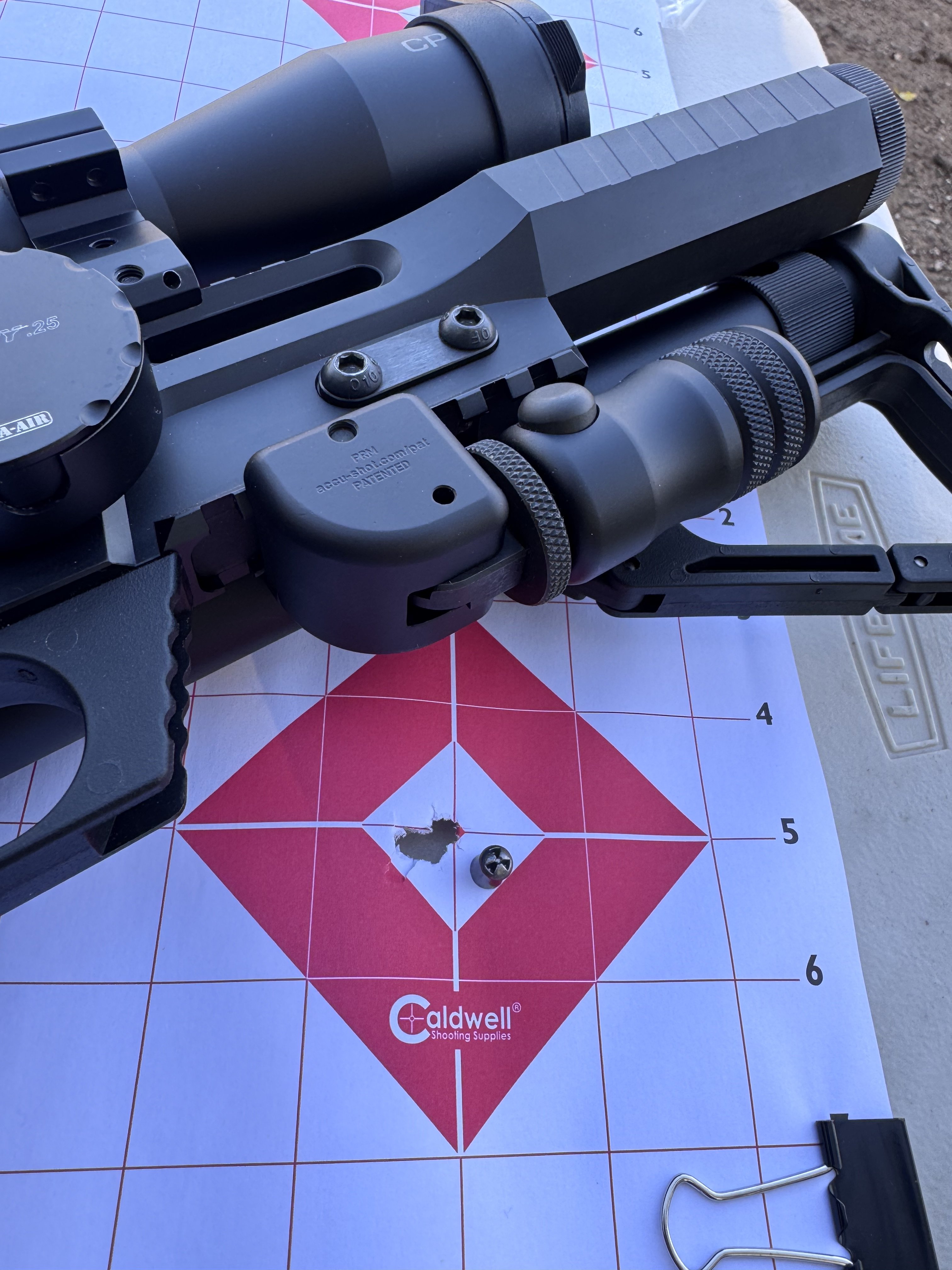

Here’s my .25 at 25 yards off of a wobbly table
Factory shroud insert or STO or something else? Tuned to the knee or is it a short dwell tune?
My dog is getting too old to keep the Marmot away at our cabin so I plan to set up one of my Classics in .25 for close range use.
All stock tuned about 5% below max speed . I leave it alone even when changing calibers and barrels it just shoots well in this tune no matter what. it has a huma set at 110
