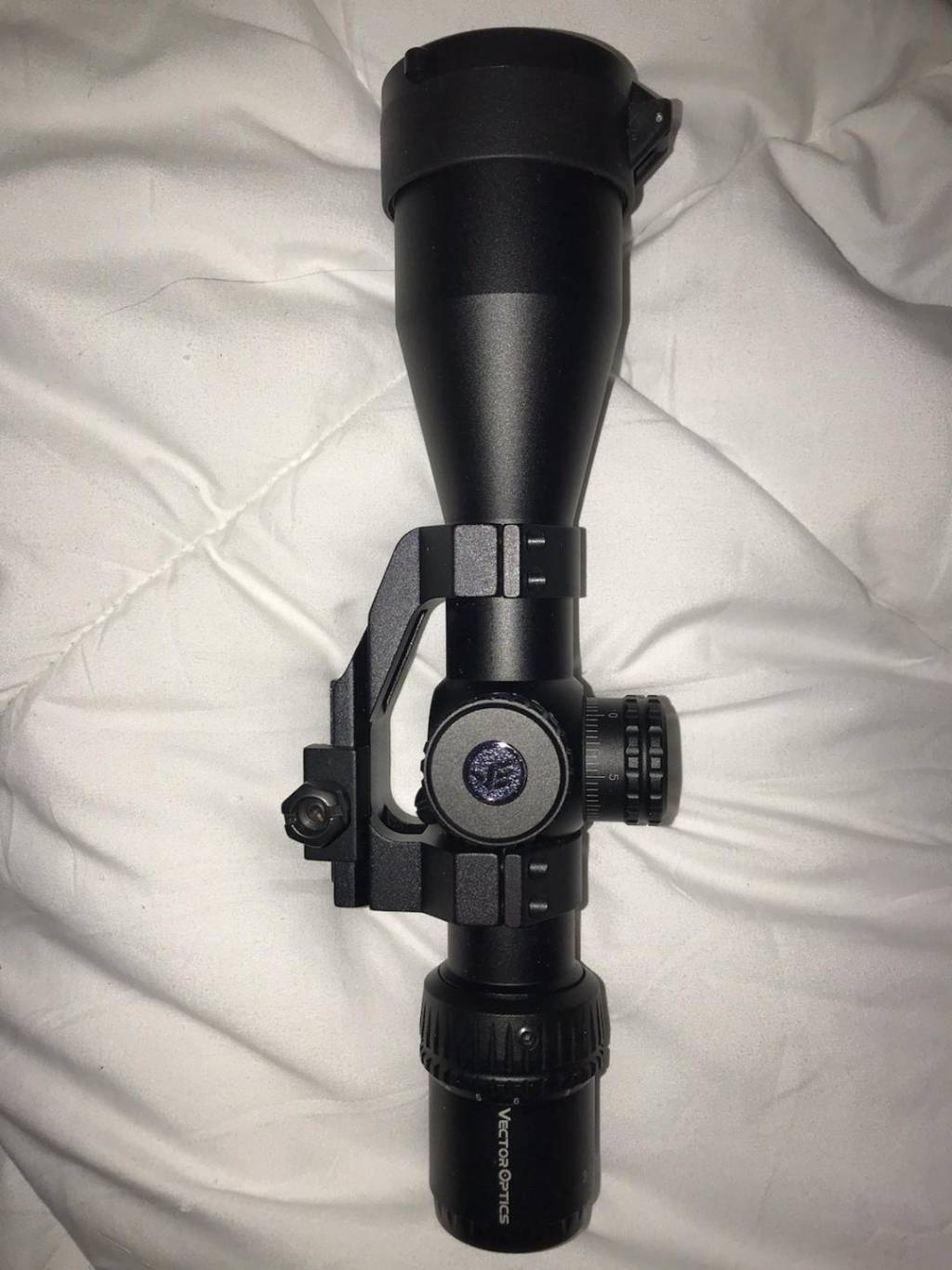

I bought a used Vector 3-12x44 which is the same scope body as your VT-3. It came with a one piece mount.
I don't know if this is considered a cantilever or a partial cantilever or what. I don't know the make of mount either but can take a closer look if you think it will help.
In this position the scope sat much too high for me so I never really used it. As you can see even with the flip cap it's well above the shroud. It also didn't have enough eye relief for me. I was going to flip the scope around in the mount to offset it towards the back but since it was so high I didn't bother.
For other scopes I have various pieces of spacer material on my gun bench that I use to mock up scope height. I then measure a stack and shop accordingly.

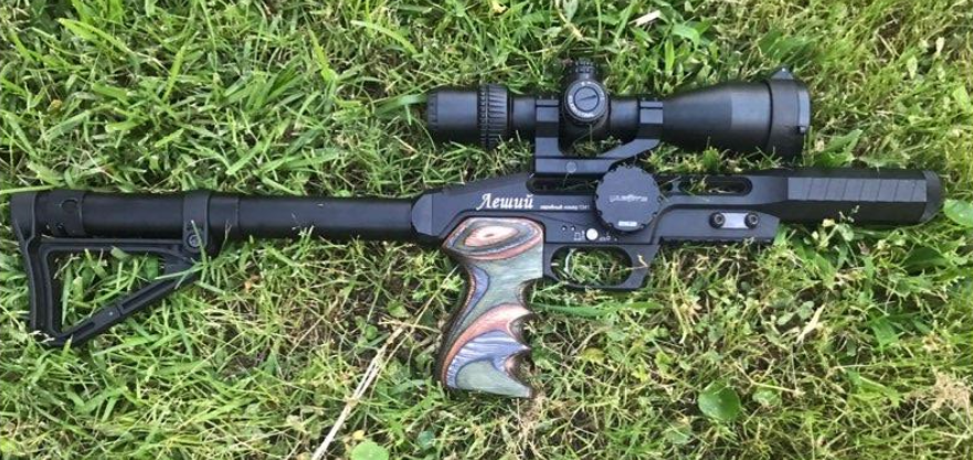

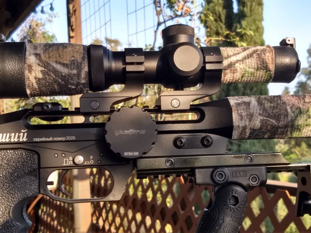

I used the UTG Accu-Sync 1 piece scope mount with offset. I only needed the medium height for the Bug Buster though. The offset is 34mm. The distance from outside ring to outside ring is about 3.75". You can see that the offset is opposite of how Scouty's is mounted. It's ok as is but the scope could actually come backward another inch for a slightly more comfortable eye relief. But I can't move it back any further. This scope mount is also available in a high version. It also comes in a 50mm offset, but for some reason I thought the rings were farther apart on that one and it wouldn't have fit my scope... I may have been wrong about that though.

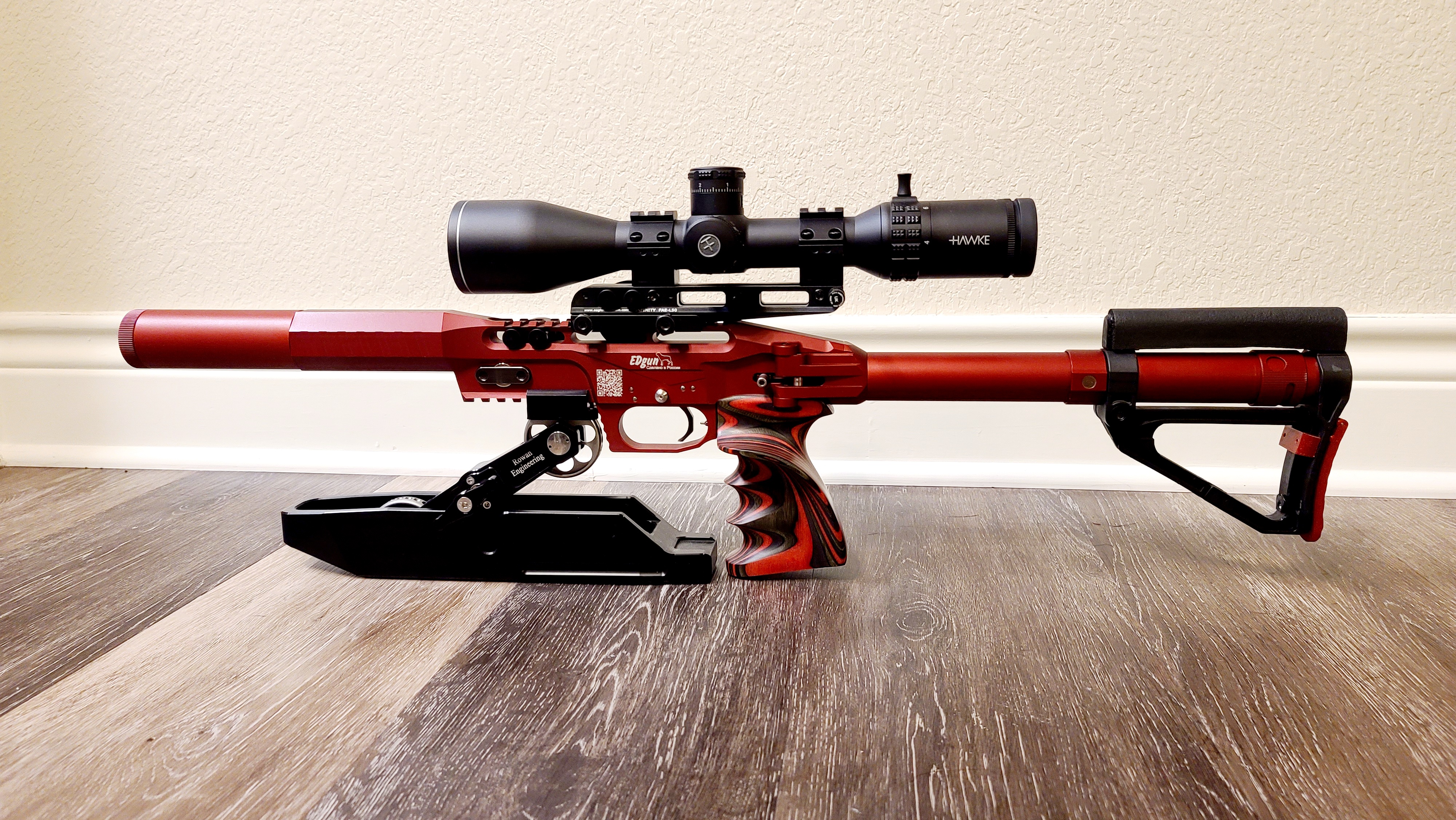

I tried many scope ring combinations and much of it depends on your scope glass size vs the different meanings of medium, high, etc. Really liked the Hawke 2-7x32 IR on their medium rings and an Osprey CP-3-9x42 MDG on high rings. But I finally settled on a FFP Osprey 1-4x24 IR sitting low upon a set of 30mm Monstrum Offset Cantilever Scope Rings. Granted this setup may not work for everybody, but for this 6'3" giraffe neck the L1 is now a very low profile back packing grove gun that earns it's keep everyday.

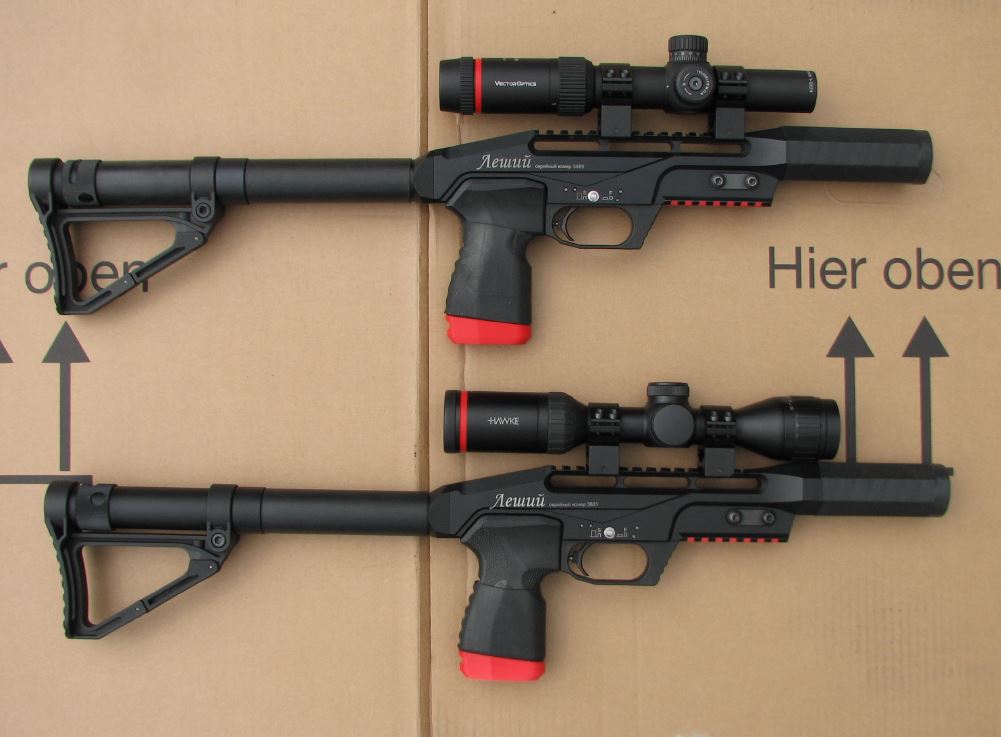

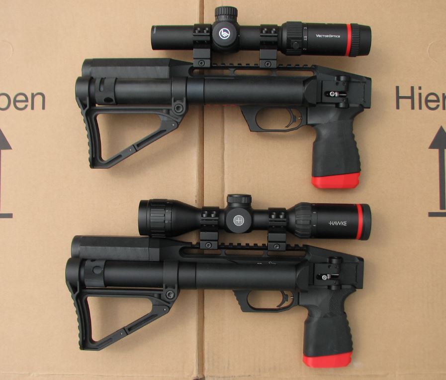

I always zero my pcp's at 34 meter and save the trajectory to memory so my holdover calculations is in the back of my head and seldom fail me - I just trust the force
No trouble with eye relief at high mag, neither the Vector nor the Hawke 2-7x32AO, BTW the AO adjustment ring on the Hawke is OD 47mm and this is max for the Hawke high mounts, just clears the moderator by a hair
The Vector comes with low mount included but too low for me so Hawke high is used on both Classics
Here pictures of my setups

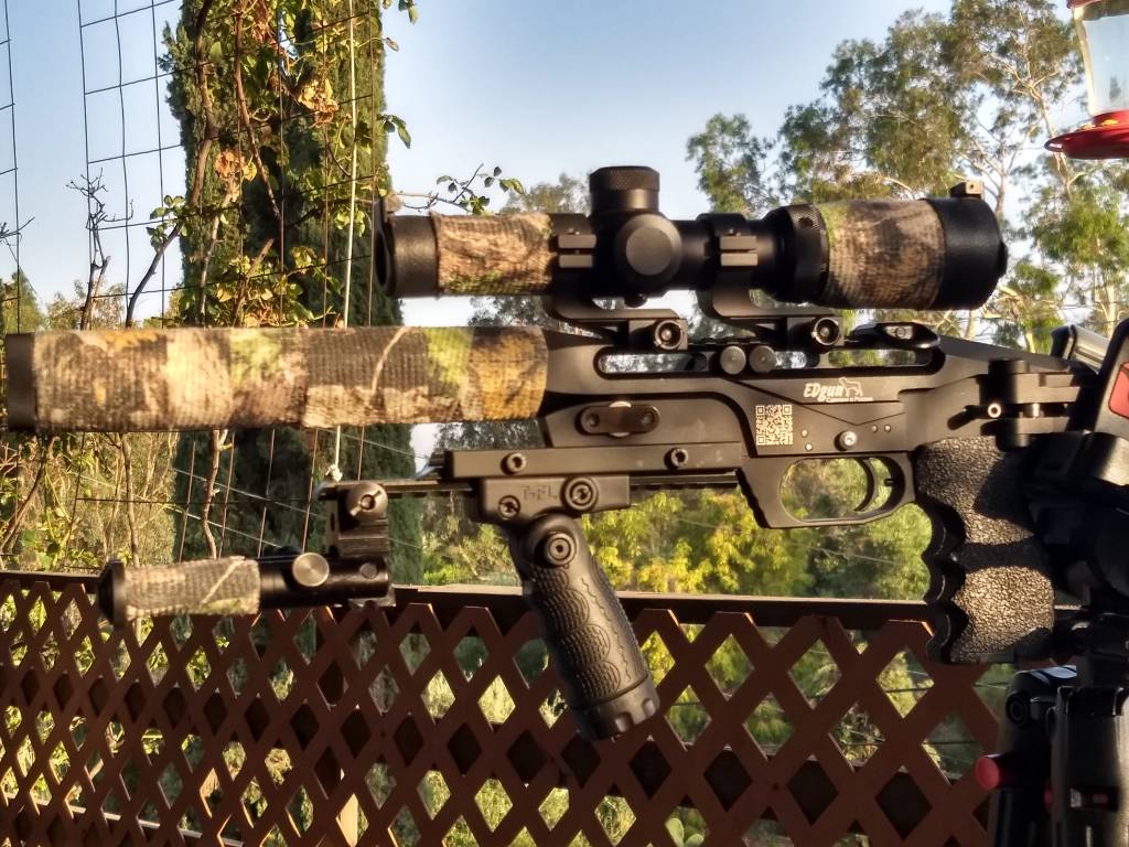

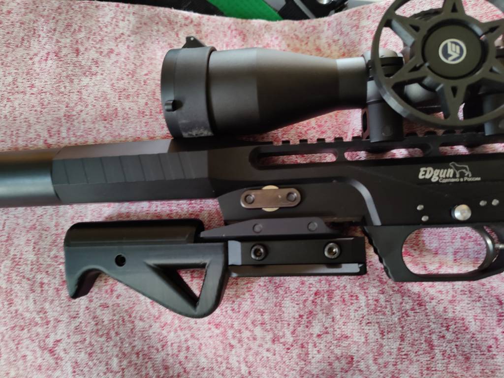

Here is a picture of my Burris Timberline slammed down on the shroud. I believe the paracord is called cordless paracord. The AO just barely skims it with 31mm height to center rings. If it were regular paracord I think I would have needed slightly taller rings.
