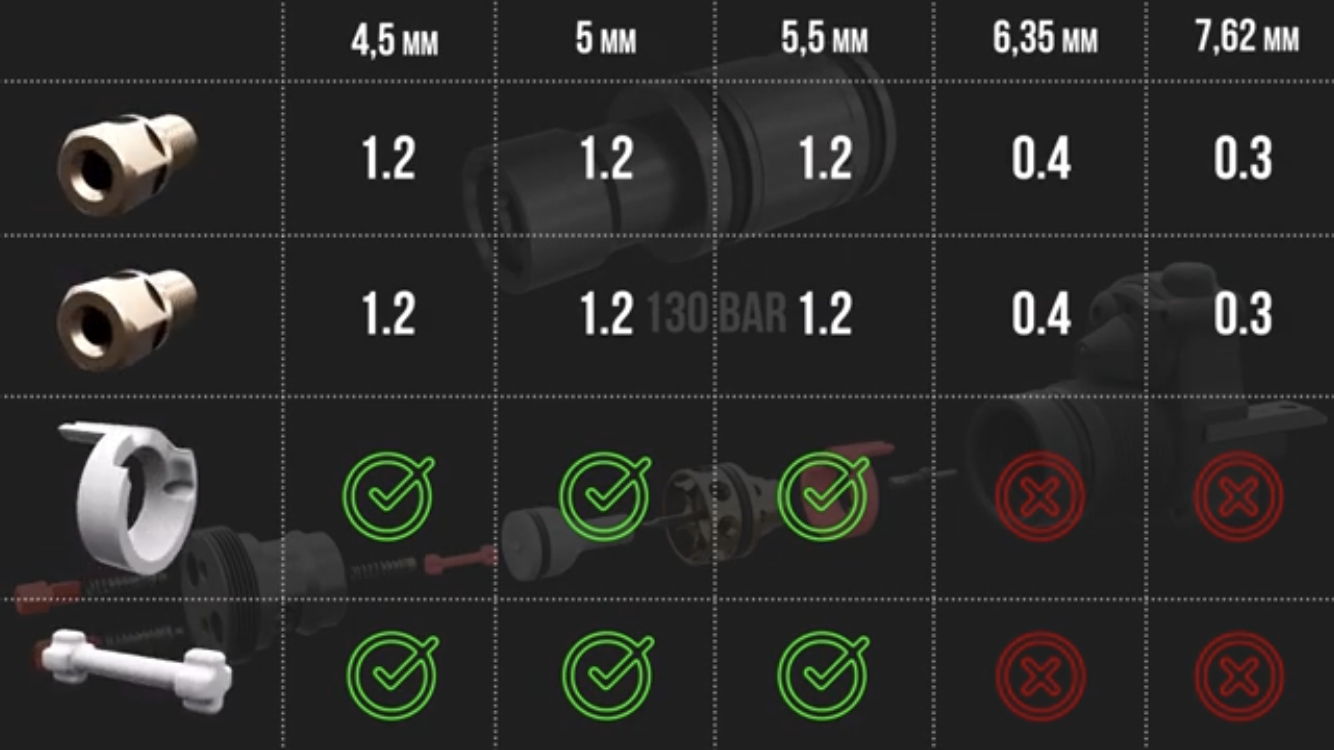

Bigger jet + smaller puck is where I would begin your journey, small changes however, such as a 5.5mm puck over the 7.5mm.

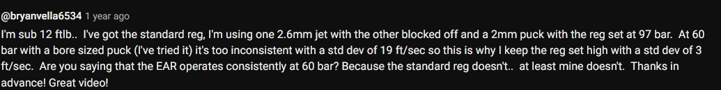

Read through the Youtube comments as well for other users input. This guy is running a LOT of jet and...a smaller puck.

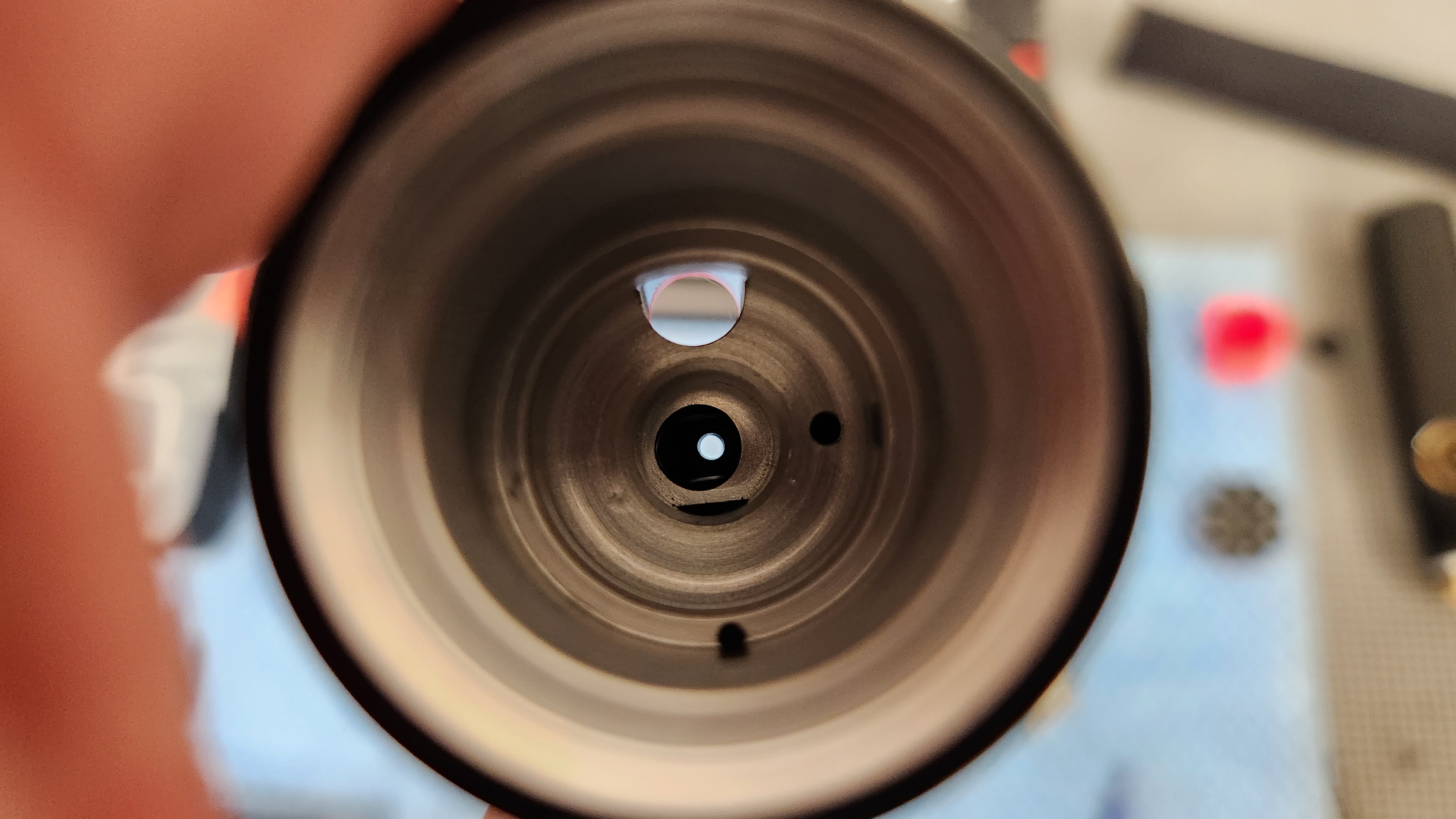

That guy have something below the large setscrew from the side, what that thing does? limits the volume or limits the flow to indexing?

What nobody actually answered is, "what the 2mm setscrews doing in that forward plug" ? I would like to learn about that trick but not speaking that language.
I speak Russian. The 2mm set screw has a .7mm hole in it. It is used to reduce flow to the trigger/valve disconnector and magazine cycling. He said it also solved his other mystery problem of big airdumps when dry firing. Some other modder video also had an orfice reduction piece that does the same thing. He sells a shoulder bushing that just presses into that hole. I'm going to try this because one of my Leshiys has a problem cycling at medium pressure (fine both high and low). EDIT - he used a trimmed tire valve spring to replace the tirgger disconnect piston spring to make easier to cycle with less air. Also makes the cycling quieter.
Thank you Sergey. Impossible to find a 2mm setscrew with a 0.7 hole in it, unless I make myself a tool to hold the screw and drill it myself.

Not sure why there is so much backlash on reducing the puck from 7.5 to say 6.5 or 5.5, when there are videos from Brian himself doing it to his, along with them providing 2 different sizes. It may NOT be necessary but its a VERY simple and REVERSIBLE attempt to get larger jets cycling the action properly. I am not saying the puck itself will cut dwell (smaller tp's don't cut dwell much they more-so cut airflow), I am suggesting it will potentially restore function with larger jets, especially when fine tuned, one should see really no major power loss unless you drop them significantly in diameter.
There is no reason you shouldn't be able to run a single 2mm jet or two 1mm jets at higher pressure. If jet alone was ALL that was needed to cut dwell which would cut power, then puck size wouldn't matter, ever...yet he supplies 6+ different sizes, 2 different sizes when you order the 4 pack, and 4 custom sizes you can order.

Drill and tap a 2mm female thread (or just drill a hole you can press it into ) then lock-tite/super glue it in while you work the hole, then heat and remove?

Enlarging that hole at 6 a clock is - non reversible
Making that hole smaller at 3 a clock is - reversible (I can drill 0.7 hole in 2mm setscrew in my garage, will make a jig for it)
