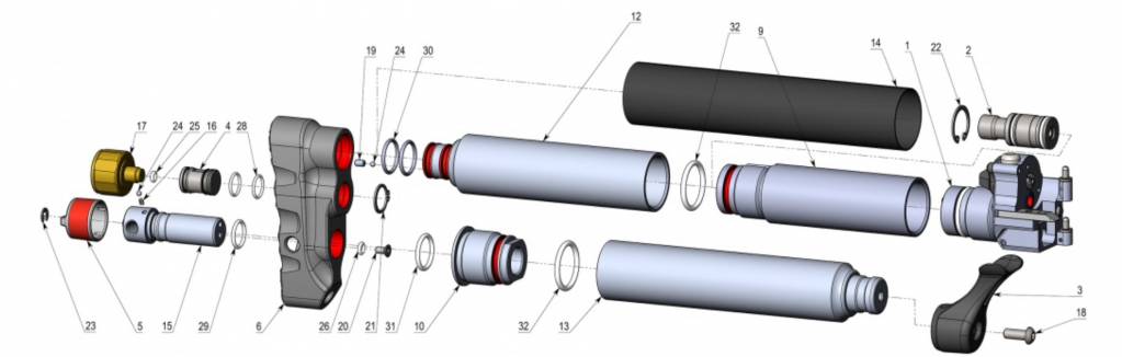

Isolate the leak using soapy water. The below may help. Don’t take anything apart till you know where the leak is coming from.
The gauge and gauge oring are probably among the most frequent.
I would look at the fill port or the cylinder bleed screw. Gauges are another common leak point, either through their housing and weep hole or at their threads which is harder to get to.
For the fill port, sometimes you can put a couple of drops of silicone oil into the air inlet or fill adapter and use your compressor or hand pump to blow it past the ball check valve to hopefully dislodge any tiny grit that might be preventing the ball from seating all the way.
To search for and positively locate your leak, you want a dab on bubbling solution. You can make your own with dishwashing liquid, approximately one part dishwashing liquid and maybe three or four parts of water. Dab this on various places and look for bubbles. You can also buy Oatey bubble solution for leak detecting off the shelf at the home store.
