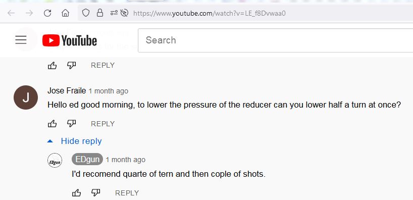

Ed, from the comment string in this video:
https://www.youtube.com/watch?v=LE_f8Dvwaa0
I blew the reg o-ring twice (.177 cal) backing of, so a couple of shots may not be enough to take the plenum pressure down in that caliber, so I play it safe and do four and have not experienced any problem since
