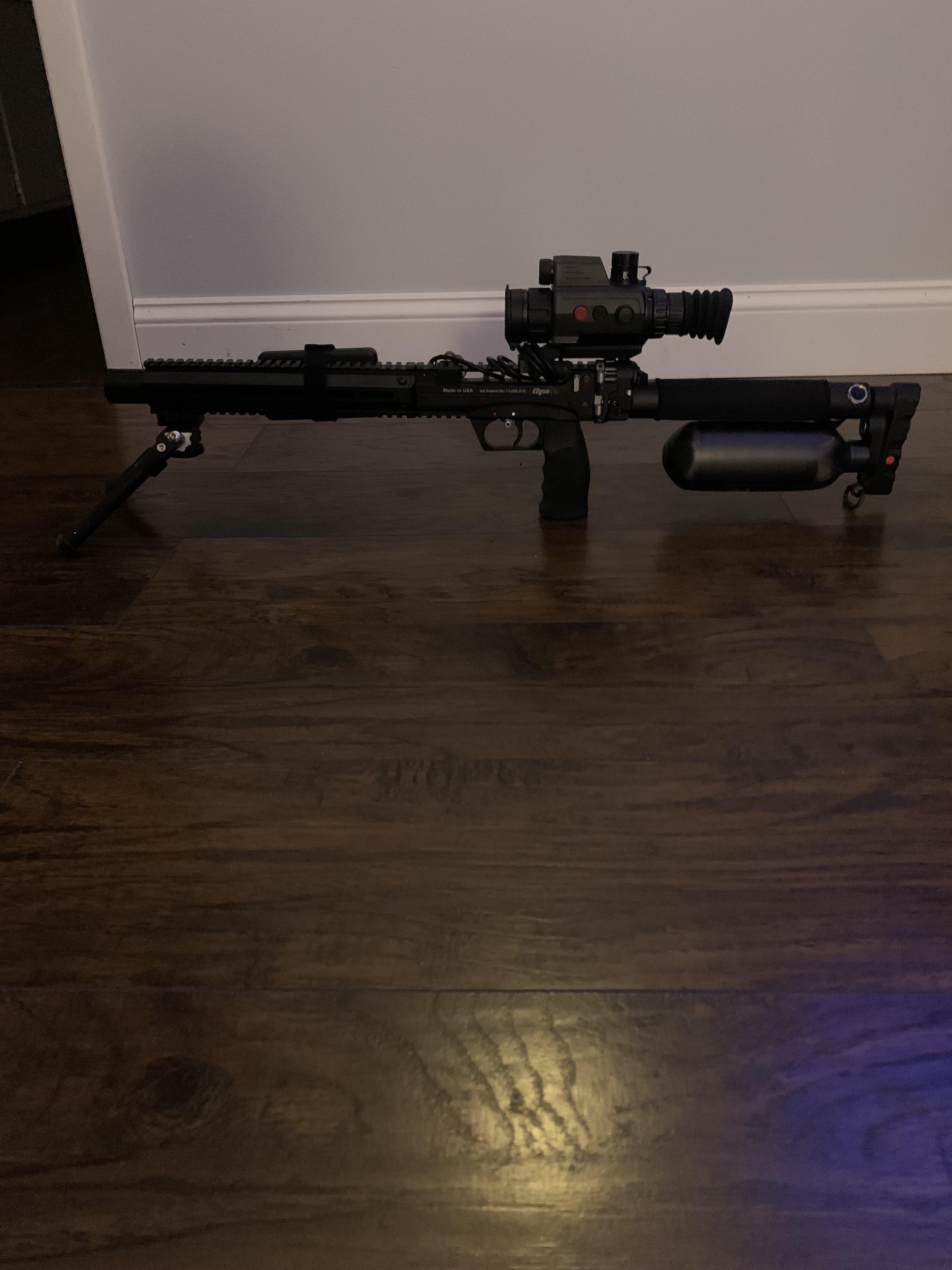

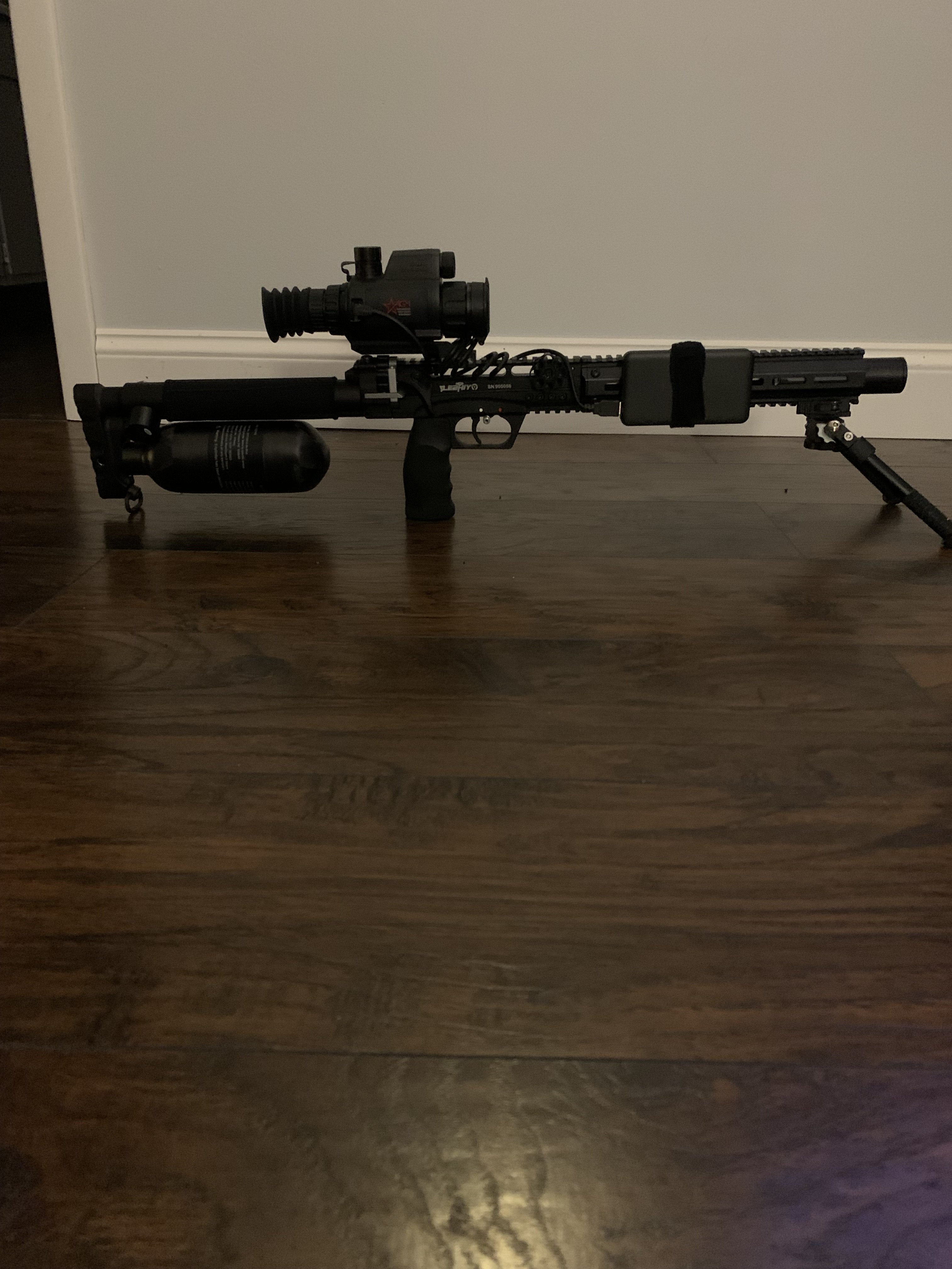

EDgun Leshy 9 to .25
So I have a Leshy 2 in 9mm with the larger plenum. I put a 380 mm .25 superior liner with different hand hairs and she is sweet looking and running hot! She has one jet a .3 and I know she is wasting air. So my question is what jet or jets do you Leshy guys recommend me starting with I do have the jets.
Start by replacing couple of 0.1mm jets and “see” what’s your maximum speed for that regulator pressure. Once you have that speed then swap out the 0.1mm jets to bigger sizes until your L2 is shooting at around 96% of your maximum speed of your regulator setting. Less wasted air this way. You can use the same method to tune to your desired speed by dropping the regulator pressure first
Use 2x .3 jets for the 25.
Then when switching to 9mm, simply remove one of the .3 jets and plug the hole.
I also have a 9mm set up in 25 by Brian at edgun west and that was his advice to me. If you go on the edgun Spain site, you'll see on their chart that those are the maximum (or minimum, depending how you look at it) that should be used for each caliber. A sum of .6 for 25 and .3 for 9mm.
