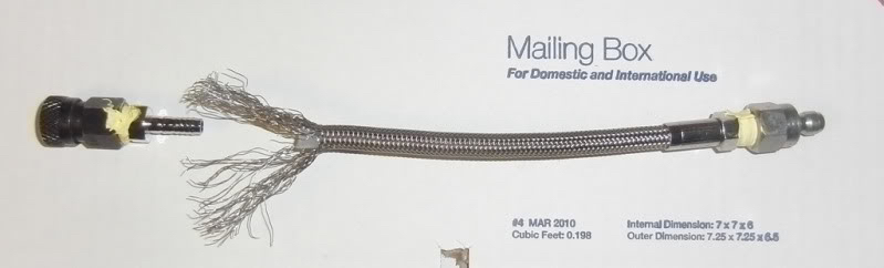

I told Joe about something that happened to me this winter while shooting tethered on a picnic bench at our cottage when it was about 15 degrees F outside. I got about 5 shots into my bench time and BAM! WHOOOOOOOOSHHHHHH!!!!!! I thought I was dead. My ears were ringing for two days!
(this isn't my hose, but a photo Joe sent me and mine looked pretty much just like this)
My hose had peeled away from my fill port and had a catastrophic failure. I blamed it on the cold temperature, but Joe asked me the question that changed everything. Where did I buy that hose?
Well..... The hose came with a 4500 PSI Carbon Fiber tank I got off of Ebay from a Chinese dealer for a GREAT DEAL! Like half of what I was finding here in the U.S.
This is where Joe's nickname of the Airgun Scientist went from cute to real and I mean like life or death real. I also learned that Joe's nickname the Airgun Scientist isn't just a catchy name - but he is actually a trained Aerospace Engineer with a TON of higher education in Physics.
He went onto tell me that how he got into designing airgun fill equipment was because he saw the industry or at least some vendors in the industry adopting paintball and airsoft gear to apply it to high pressure airgunning. The issue is most of that gear isn't rated for the 3000-4500 PSI pressures we work in.
It most likely wasn't the cold that made that hose fail - it was more than likely a hose rated for 1800 PSI! Furthermore I told Joe that I had been using an ACECARE Carbon Fiber bottle which was marketed as 4500 PSI but says 300 bar on the bottle (not 4500 PSI). Doug Noble had warned me about this earlier this year and I took his advice to not fill that bottle over 4250 PSI and stay within the 300 bar specs. But Joe went even further.

I had an Air Hog fill hose explode on me. It was a brand new hose that I had ordered, and I think it was the 2nd time I went to fill my gun (inside a room in my house of course) and all of a sudden "BOOM". Tuns out their machine hadn't crimped the microbore hose correctly and the air quickly bypassed into the protective blue hose covered. My ears rang for at least 2-3 days. All I got from Air Hog was a "sorry that happened, we'll send you a replacement" and that was it. I'll never buy another Air Hog product.
I don't get the ACECARE part, what is the test pressure labelled as? it should be 50MPA (500 bar) which is 7251 PSI, the service or working pressure should be 30MPA (or 300 bar) which is 4351PSI so you are correct that if it is advertised as 4500PSI safe working pressure that is incorrect.
However if someone is saying that another 10 bar (150PSI) could be the difference between life and death I think they are being a little overdramatic, especially as SHENYANG GAS and ACECARE make the carbon bottles for practically everyone else anyways.
