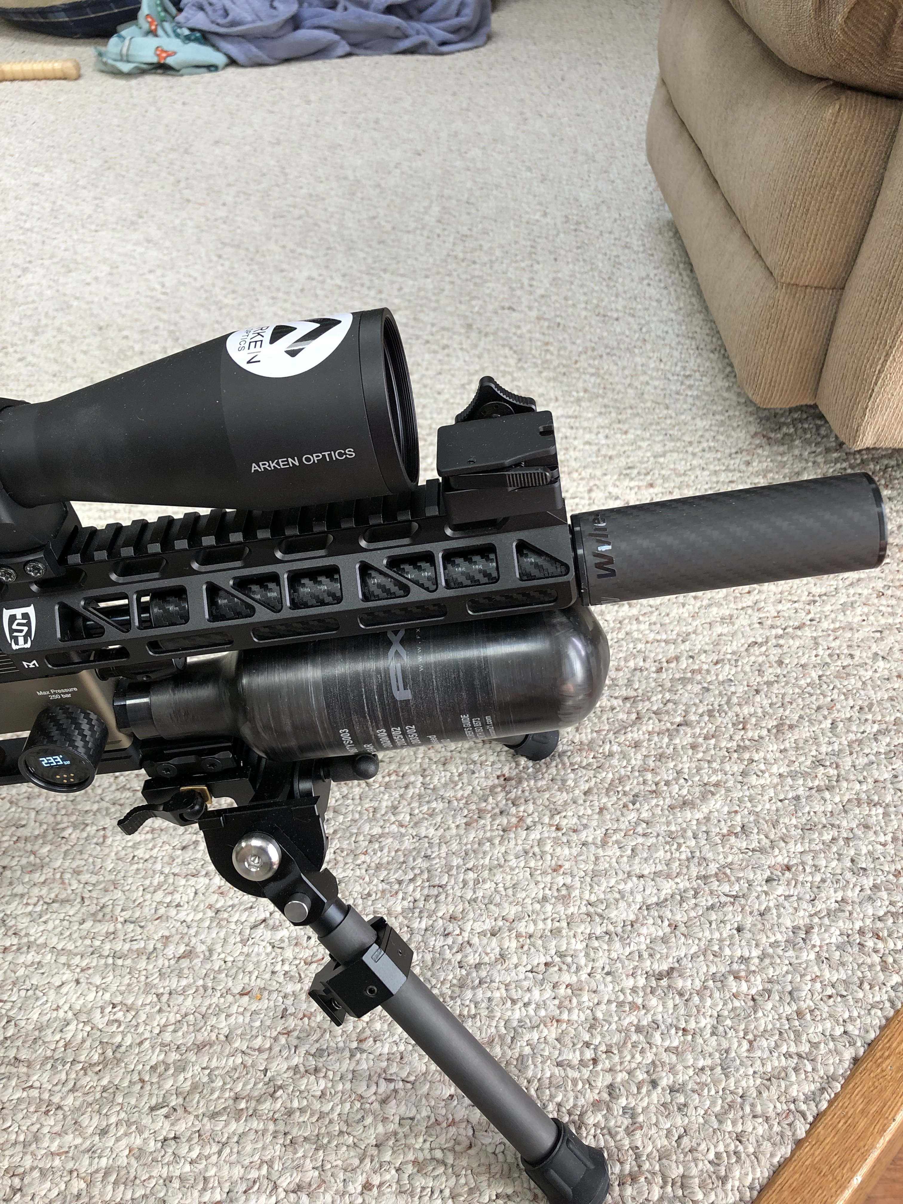

A friend and I just did a moderator testing session on our Leshiy 2 setups. We had a .22 350mm, a .25 350mm barrel, and a .30 500mm setup. We tested almost all offerings from Donny as well as a huggett snipe, and a sto sarissa. The Donny tatsu and tanto were shockingly quiet on all 3 setups to the point they actually did a better job than the ronin and sumo we tested. Now this wouldn’t be the case for all airguns, but a Leshiy 2 is fairly loud as is, and to make all 3 setups backyard friendly with a tatsu or tanto is pretty remarkable!

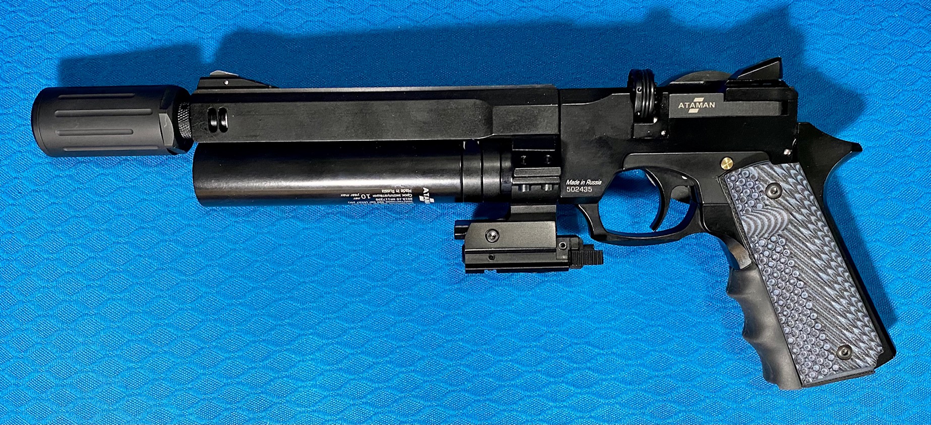

I use one section of a Huma-Air MOD30 on my Ataman AP-16, it's just shy of 2" long, yet it does an amazing job of suppressing the bark from that pistol. The AP-16 is tuned to shoot 14.3 grain pellets at 860FPS, so it does a realy good job with as small as it is!
