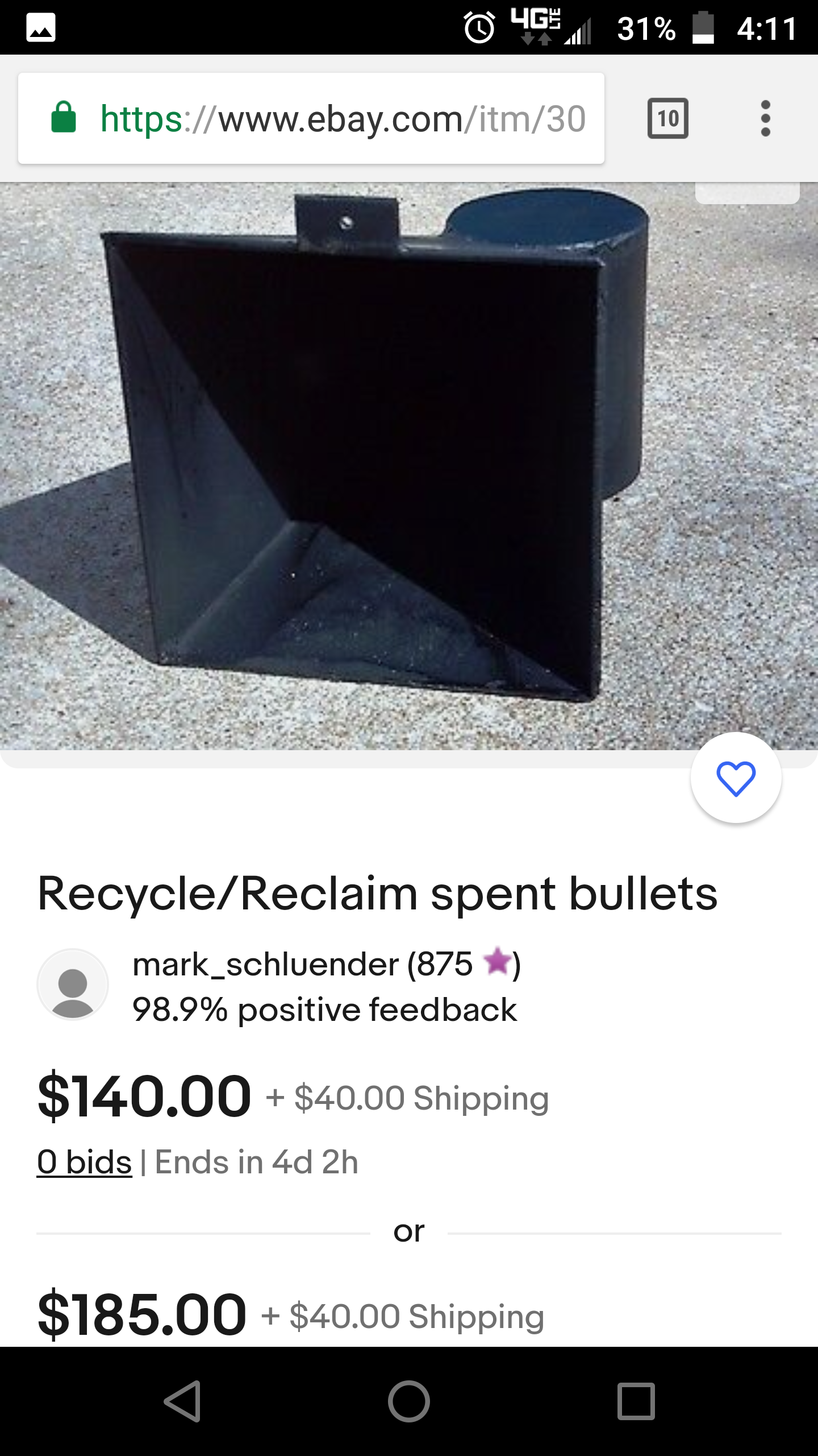

I use this beefy bullet trap (sold on eBay) and quieted it down by gluing 3/4" horse stall rubber floor matting to all sides and the collector (mats from Tractor Supply). Heavy big bore slugs hit with a dull but metallic thump now and a quiet air rifle is louder than pellets are. I tried collecting lead in rubber but the rubber bits in the lead makes a smoky stinking mess when melted down into ingots.
@Airgun-hobbyist Thanks for the link. I looked for one of these recently and didn’t find it. What I wanted to ask you is, do you experiencing any shattered fragments that rebound of the top, bottom, or anides of the trap and fly back through the target?
@Ezana4CE With solid steel ricochet inducing bullet traps, even at extreme angles, you are going to get lead ricochet splatter backwards to some degree.
@Airgun-hobbyist That’s very interesting footage and it explains plenty concerning the the shapes of fragments that I have recovered. What I’m still wondering is, what can be affixed to the front of a steel trap to minimize fragments from bouncing back and ripping through the target paper and out of the trap? I’m wondering how I might use a horse stall mat or maybe a piece of linoleum or something that can impede fragments with that sort of energy.
@Ezana4CE I use cardboard box material for the face of my target box and do get splatter, but don't have splatter going through the thickness/weight of the cardboard. I think that you are on the right track as far as containing the ricochet splatter by using the rubber horse stall mat material on the face of the target. That material would also give you something to staple the paper targets to.
