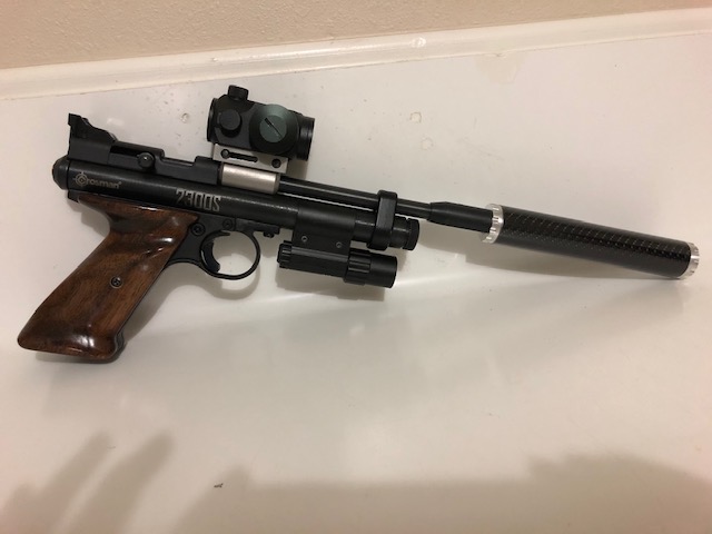

Got the internals all slicked up, trigger job, valve port and polish with angled port, lighter valve spring and hammer spring, ice maker tube transfer port, RPA, red dot, and extended bolt probe. Almost had all the parts for the marauder trigger conversion, only missing the bolt sear. Shoots great with the TKO and getting about 475 fps with CPHP. Been shooting my son's plastic golf balls out to 15 yards and watching them fly!

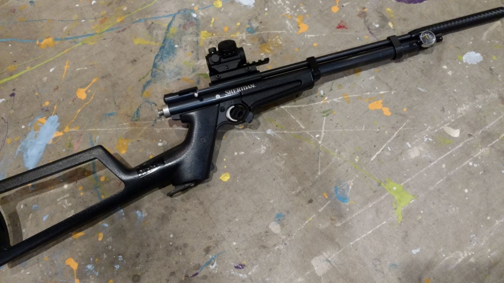

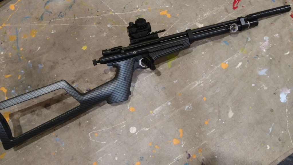

So here are a couple of 2240/2250 platforms that morphed into 2260 carbines. fantastic and fun shooters. I prefer red dots as most of my shooting is out to about 35 yards (and maybe 50 yards from time-to time). First one started out as as 2250 back in 1999. Converted to HPA a few years ago with a Benjamin/Sheridan 2260 tube from MagnumAirpower. The 14.6 Crosman barrel is an absolute tack driver (I don't think they make them like this anymore).
-Steel breech. -discovery spring.
-Extended probe.
-MagnumAirPower deadblow hammer.
Cothram Machine spring aduster.
-Discovery Valve.
-HUMA (90bar)
-MagnumAirPower fill port/air guage.
-6.5" TKO
-P-Rod trigger assembly.
I'm getting about 42 shots at 710 fps with 15.9s and same count for 14.3s at 750 fps.

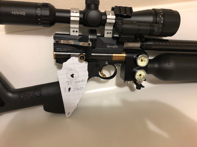

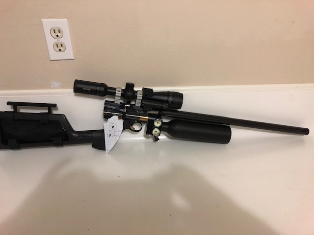

Second, looking almost identical, is a 1760. Ordered earlier this year as a Crosman Custom Shop 2400KT with the 14.6 Lothar barrel.
-MountainAirCustom 2260 tube.
-Challenger hammer adjuster.
-Extended Probe
-Stock 2240 spring
-MagnumAirPower dead blow hammer
-Discovery Valve
-HUMA (90 bar)
-Hillairgun Hi-cap gauge port (tapped about 3-inches from fill port).
-5" TKO
-P-Rod trigger group.
Getting 50+ shots at 795 fps with 7.9s and 50+ at 775 fps with 8.4s.
