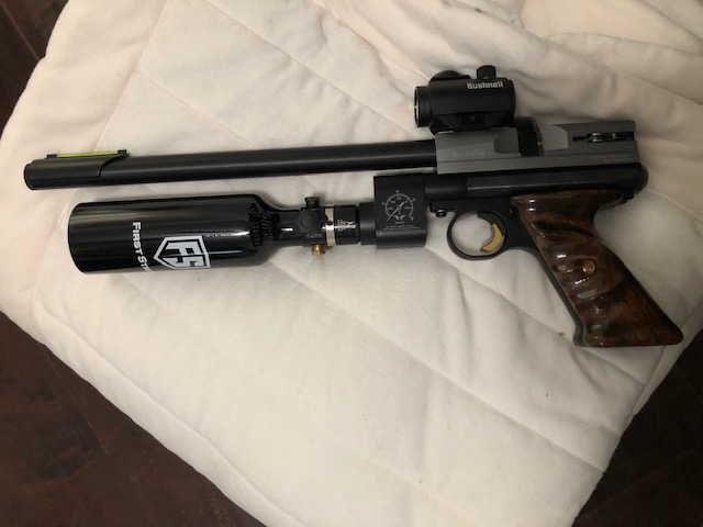

Top .25 DAQ Upper co2 cart gun. Bottom 9mm DAQ Upper 2kpsi PCP
2240 tube, 2240 grip, FX STX barrel, DIY carbon fiber shroud, CustomAir breech, System-X dropforward
.25 DAQ Breech,2250 tube, DIY rear sight, Corcoran Grips
RJ Machine breech, Bluefork Design gripframe, DIY adapter and arrow barrel.

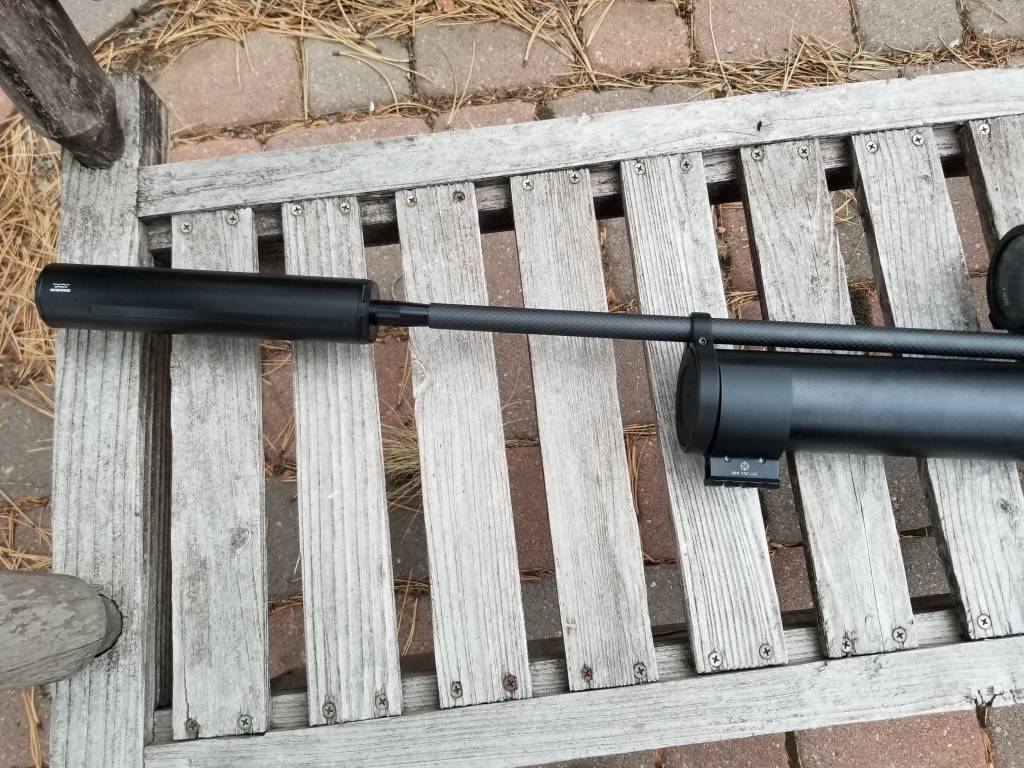

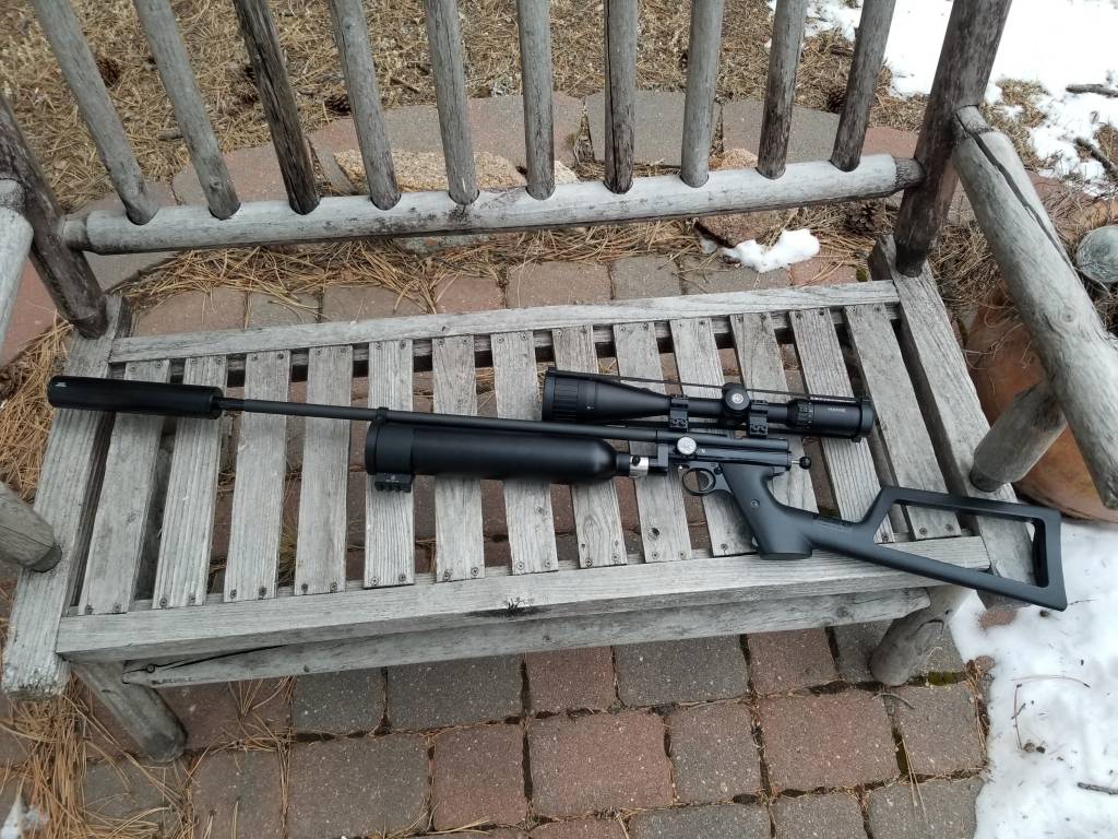

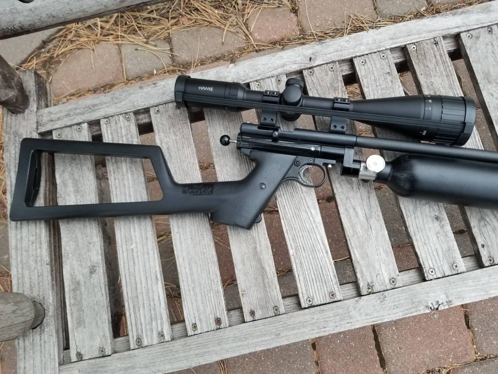

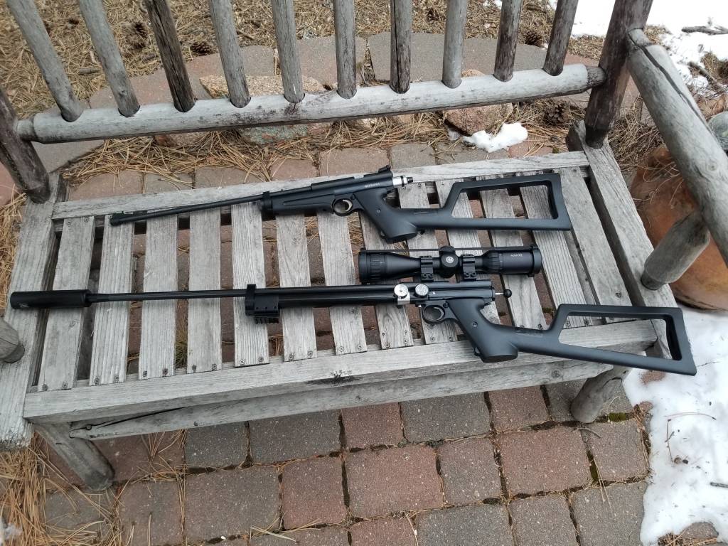

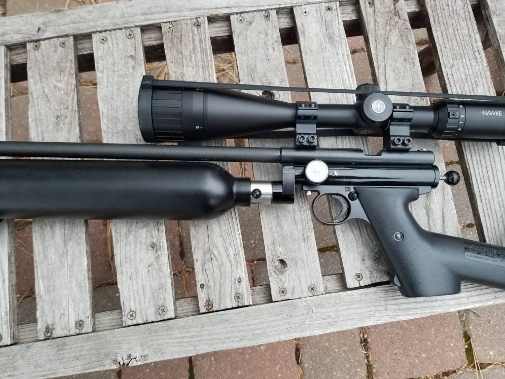

I'm a tinkerer, and I must admit that I have gotten "bitten" by the 2240 bug pretty bad.
Here are some pictures of what I call my "regular shooter". This is the one I take out back and plink and plink and plink. I have no idea how many shots I am getting on a fill, but it is probably at least 150. It is regulated to about 2000psi (about 140bar) and I fill it to 3600psi (250bar). I'm pushing 15.89gr pellets to about 800fps with this one.
  • It is a Chinese PCP Conversion from free_outdoors
  • 450cl Aluminum Bottle
  • Carbon Fiber Shroud over 24" Barrel
  • Hawke Vantage 4-16x50 Scope
  • Sports Match Rings
  • Custom Barrel Band
  • Picatinny Bottle Clamp
  • Moderator adapter from Alchemy Airwerks
  • DonnyFL SHOGUN

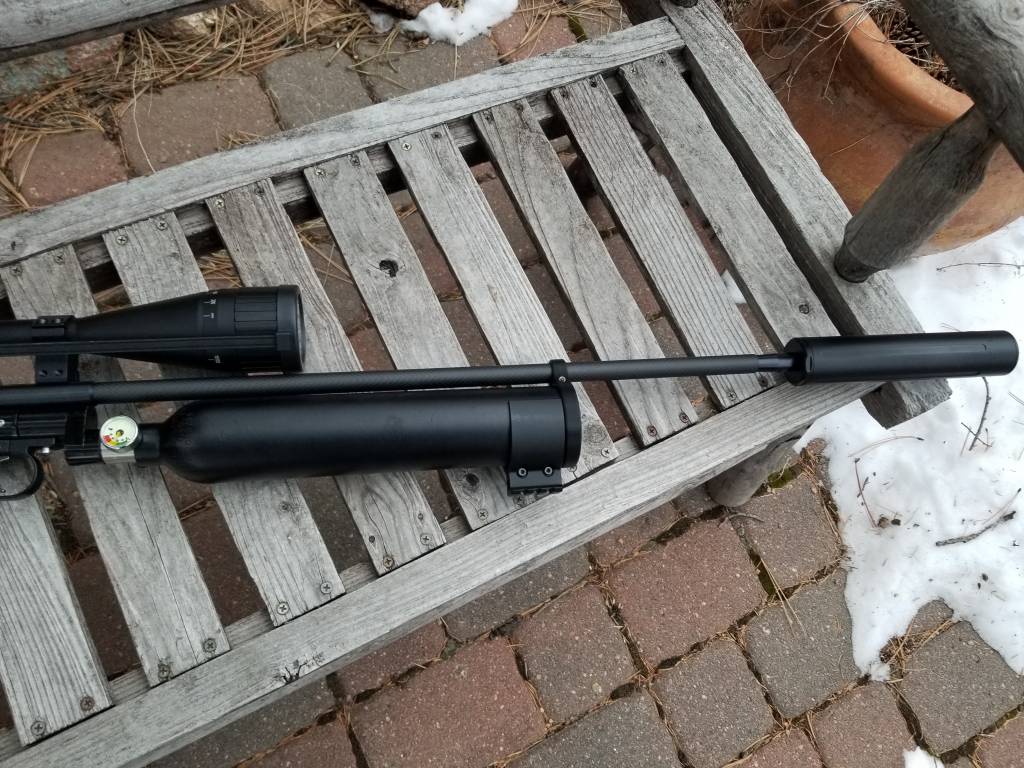

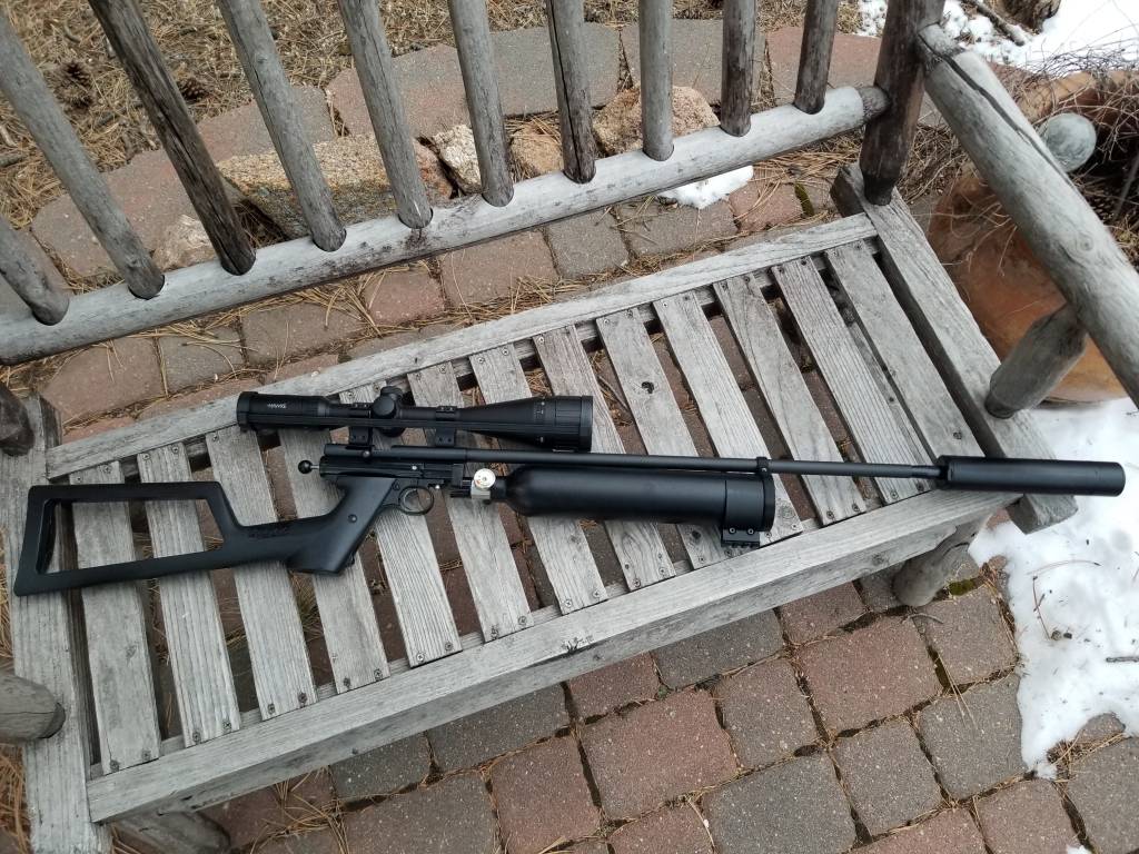

Here are a couple more. The one on top:
  • Still uses Powerletts
  • 18" Barrel
  • MIMS Sight in back and high visibility in the front
  • Speed Dial Power Adjuster
  • Marauder Trigger Group
  • BOSS Transfer port
  • Stock Valve
  • Longer/lighter hammer spring
The one on the bottom is a 0.177cal that is regulated to about 1700psi (120bar) and I fill this one to about 4000psi (270bar). I'll get about 50 shots of 8.44gr pellets at about 860fps.
  • This is also a Chinese PCP Conversion
  • 71CC Titanium Cylinder
  • Hawke AirMax 3-9x40 Scope
  • UTG Rings
  • Picatinny Cylinder/Barrel Clamp
  • DonnyFL - Tanto

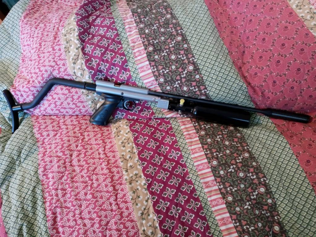

All the parts in to complete my fist 2240 build. I call it Brass Elegance, LOL!

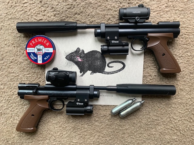

I like it. I have several 2240 builds, some in .177 some in .22, I finally decided all stainless parts, bolt handle, co2 cap, trigger ect on the .177 and similar parts in brass on the .22's. That way I can tell the caliber at a glance.

Would you mind giving us some details about your gun? I haven't seen that breech before (I don't think). Also, is that a gauge on the side of the drop-block, or is that just printed on? It looks like everything on that gun is after-market.
WARNING!!!! DO NOT ATTEMPT TO BUY CROSMOD PARTS ON CROSMOD.COM. VERY POOR BUSINESS PRACTICES. PEOPLE LOST MONEY BUYING FROM THAT SITE!!!!
Fortunately, I was one of the lucky few and received the parts I ordered, and I bought Crosmad parts off the forums. They are high quality parts. There are similar parts on ebay for the breech. I purchased a tank block from this vender and it was of similar quality to the CROSMOD parts. He sells a multishot breech. i will be ordering from him.
