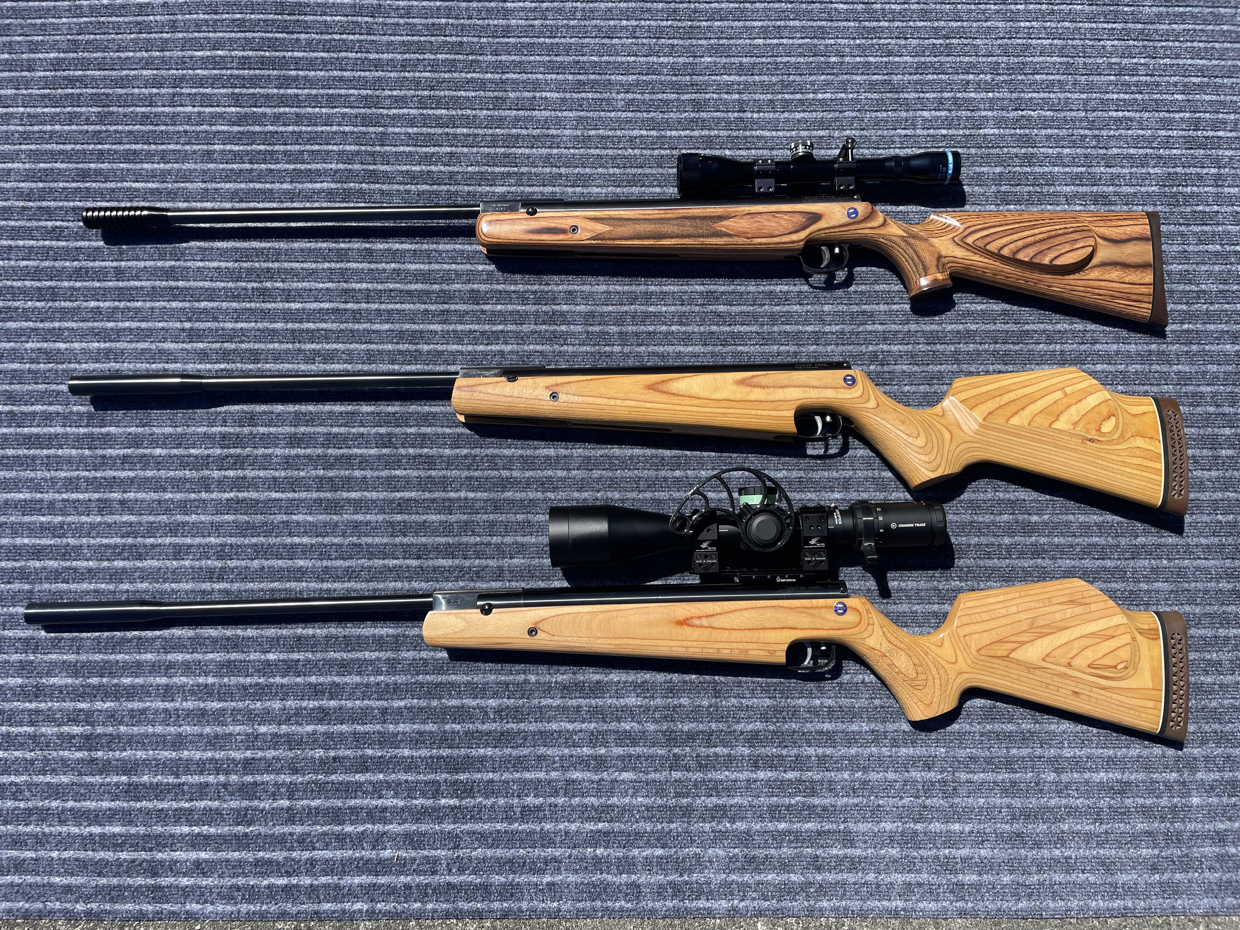

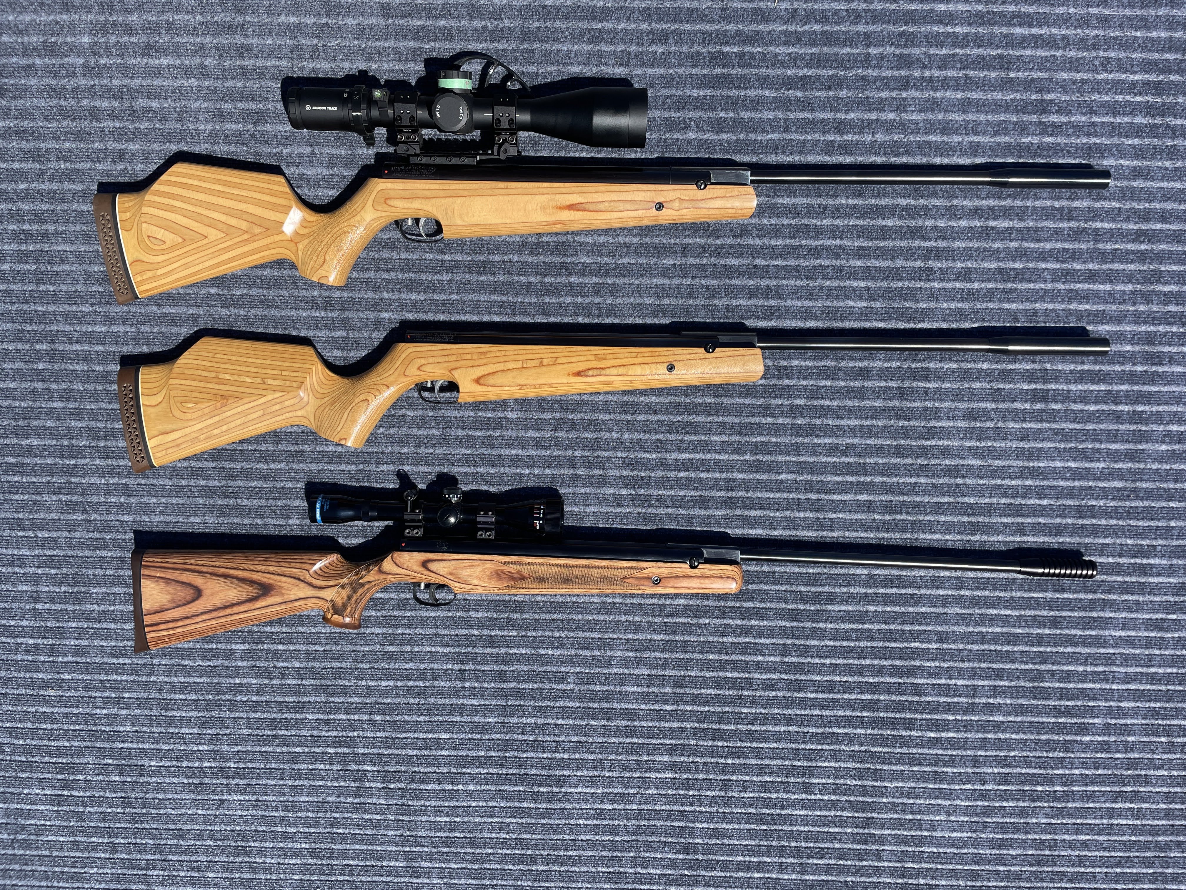

Beeman Let's See Those Beeman Lasers. (I know they're out there!)
Love these guns. They were all the rage when I visited the Beeman showroom in Santa Rosa in the late 80's.
All 3 of these are .20 cal.
Huh
Where did they all go. Someone has one.
They aren’t that rare.
Laserized guns with beech stocks do consistently pop up, but the laminated laser guns are very hard to find. After much research, only a dozen MK1s have been recorded. Considering that the MK1 was available in the Beeman catalogs for eight or nine years, you would think that more would surface. Combined, there have been even fewer of the MK2 and 3 models noted. Most likely, the 1990 $800 MK1 price tag proved to be a barrier for most. By 1996 the price had increased to $995. That's over $2000 in todays economy.
Congrats to Lewis and anyone else who has gathered all three.
