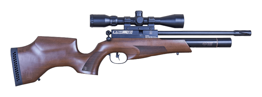

BSA CLX .177 Sub 12. . . . 0ne I do not yet own but I think it would be an excellent Woods Walker. I would certainly get rid of that clunker of a scope and the rings and mount and swap to BKL 303 rings and an Optisan CP 3-12x32 scope

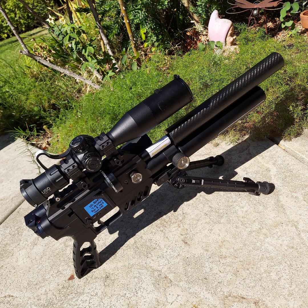

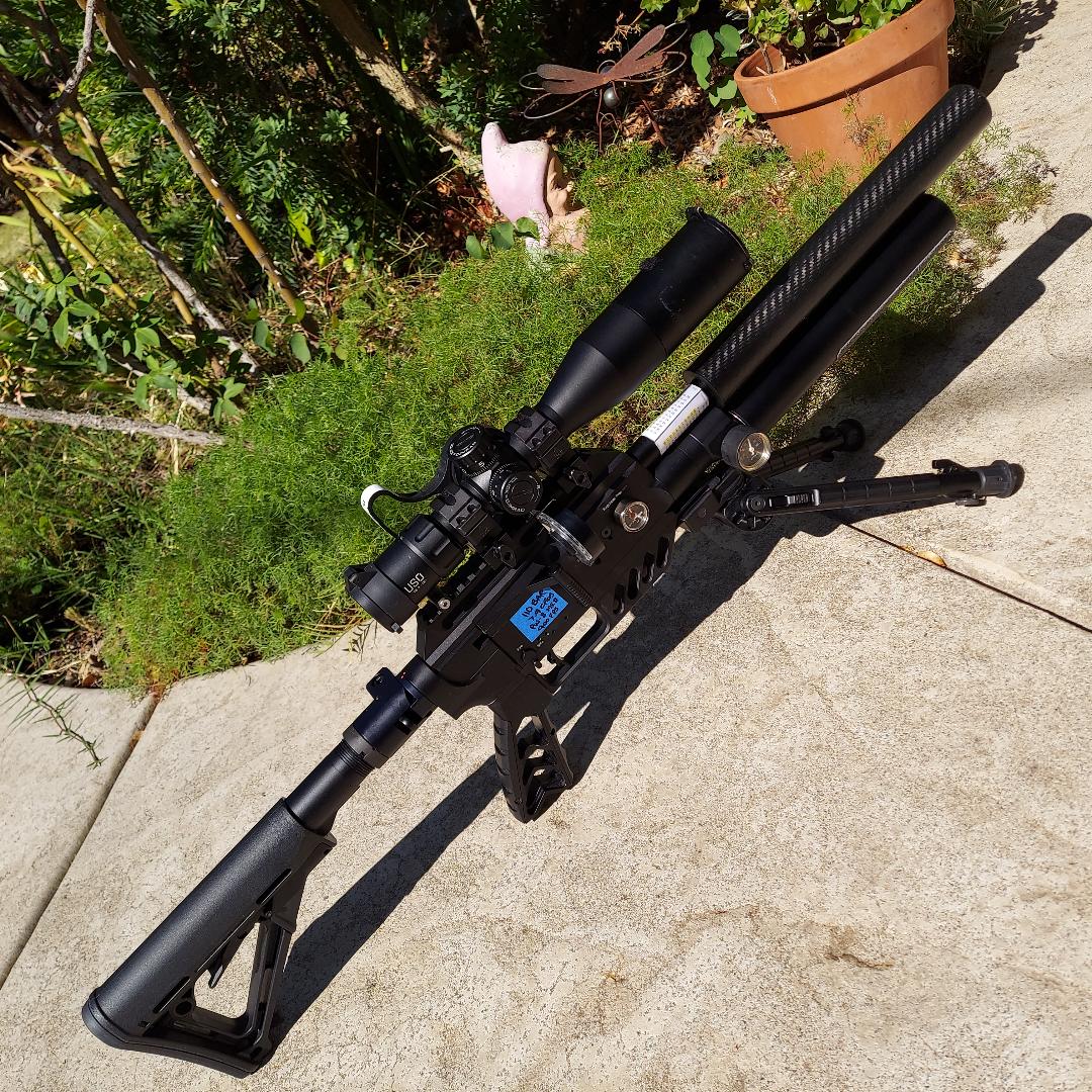

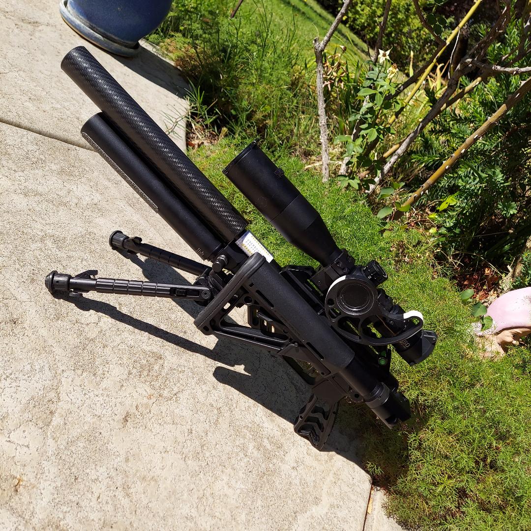

Recently acquired this little gem of a "used" compact & went about changing up a few things, while setting it up to my desires.
FX Streamline Tactical Compact. Newer model with plenum extension & thin barrel shroud. * Added a large 1 1/2" over shroud LDC/Shroud that only added about 2 1/4" to OAL * USO 3-12 FFP Compact scope w/hood on UTG QD rings, Scopeweks side wheel & DOPE to 60 yards wrapped around barrel. * UTG attached Bi-pod
As set the Regs @ 110 bar, PW at 8 on Med Transfer setting. Shooting @ 900 fps w/ Crosman 7.9's ( About 14 fpe ) Makes @ 70 shots on the 170cc air tube.
Its short, light and power adjustable on the fly if required.
Not an FX fanboy typically but this ones growing on me quickly
