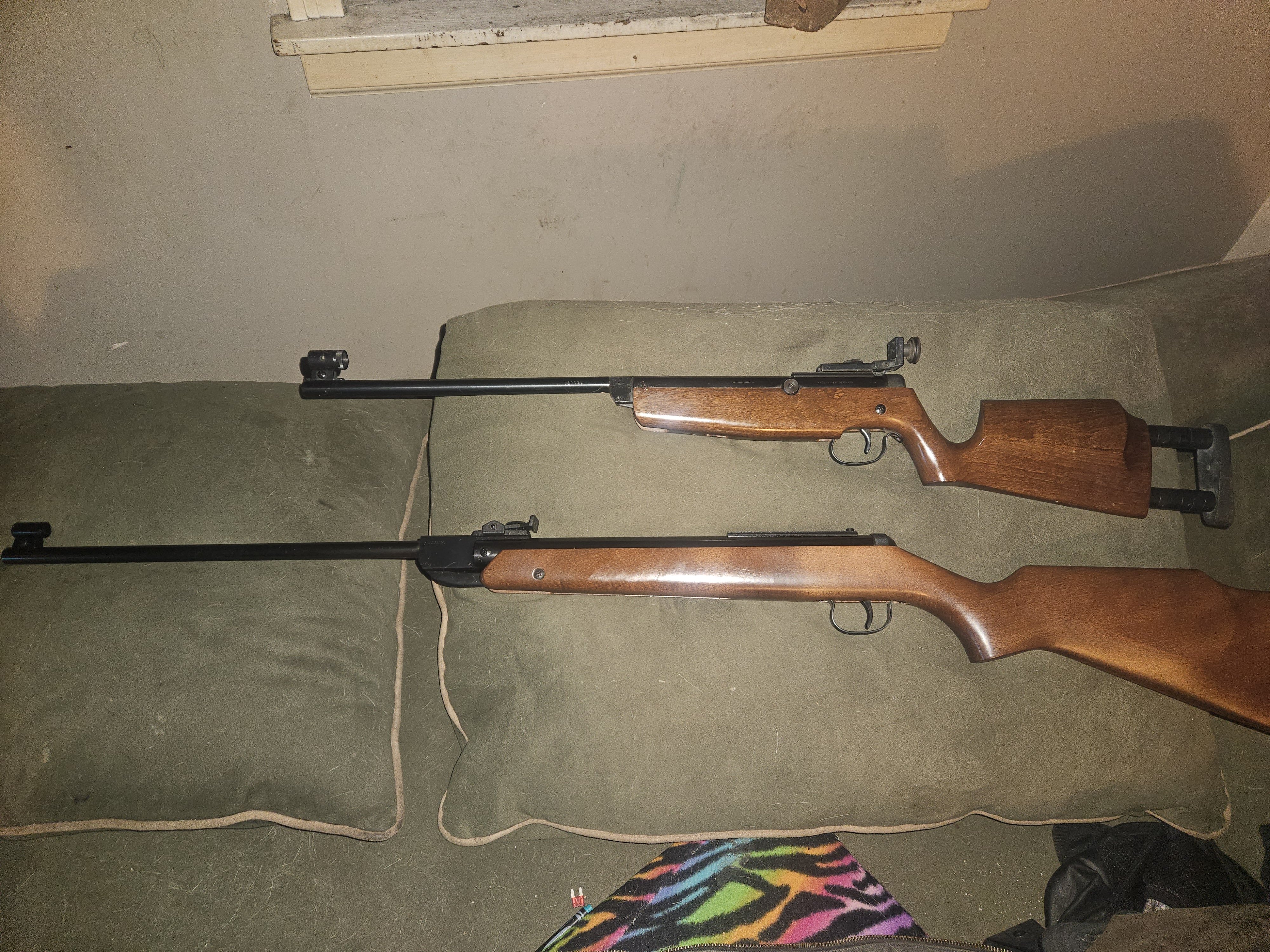

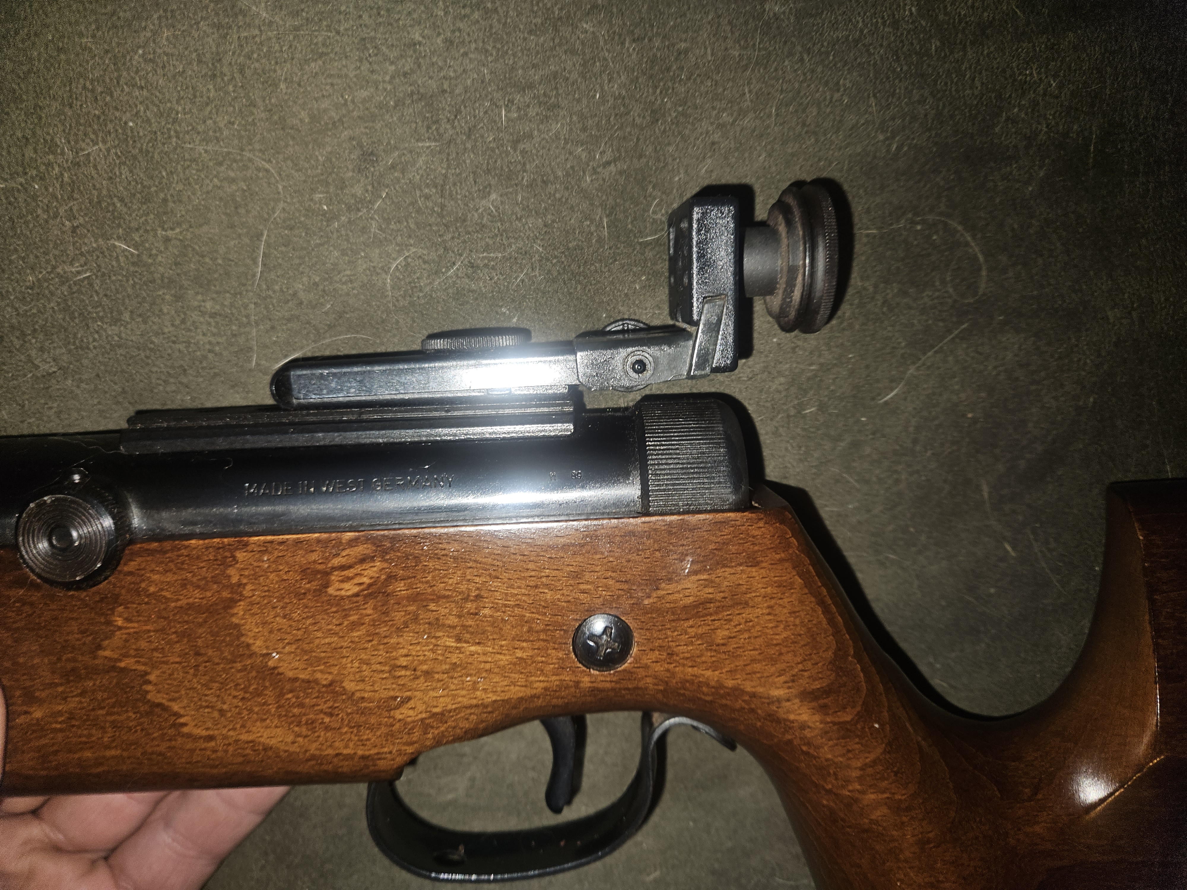

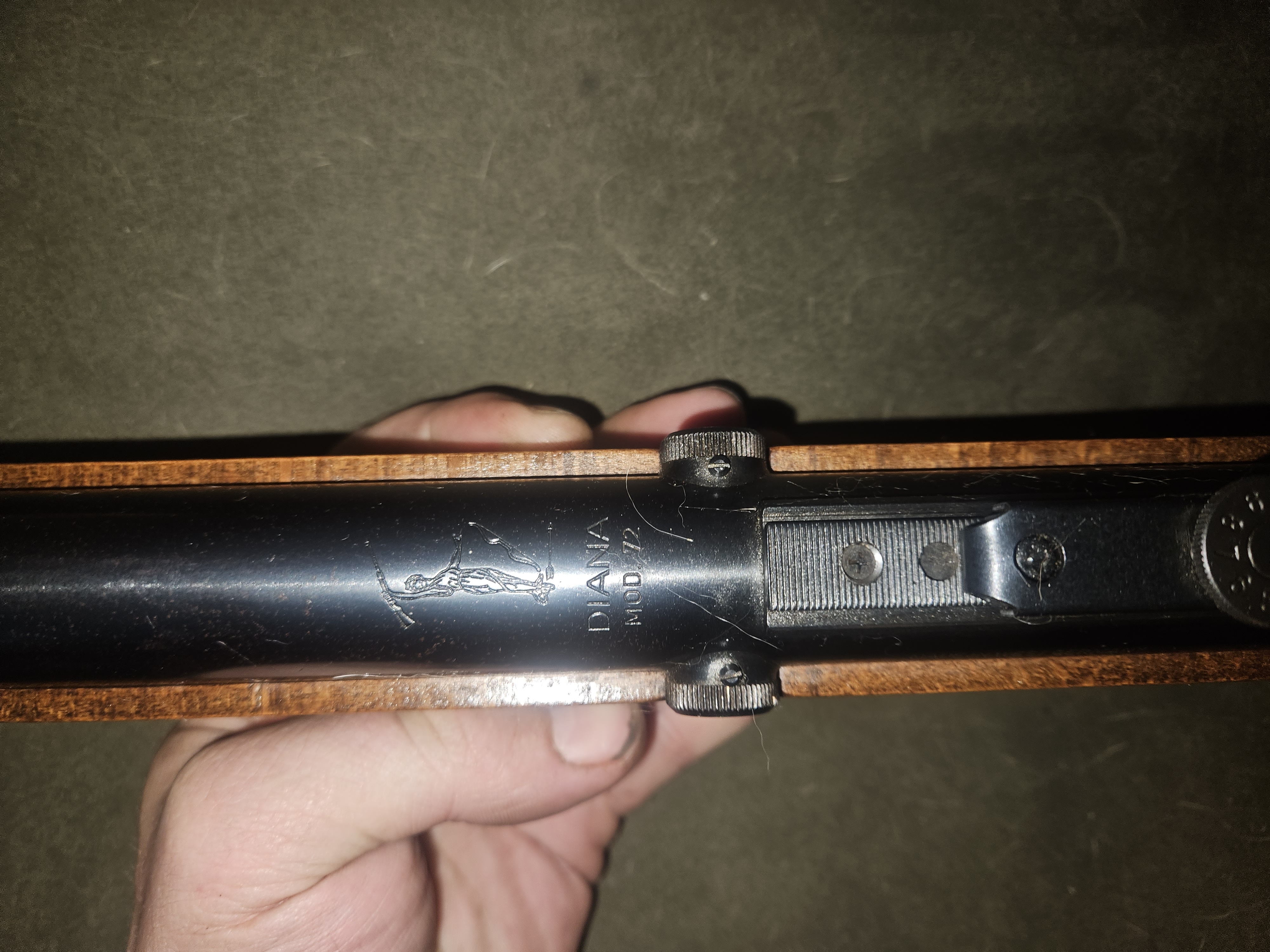

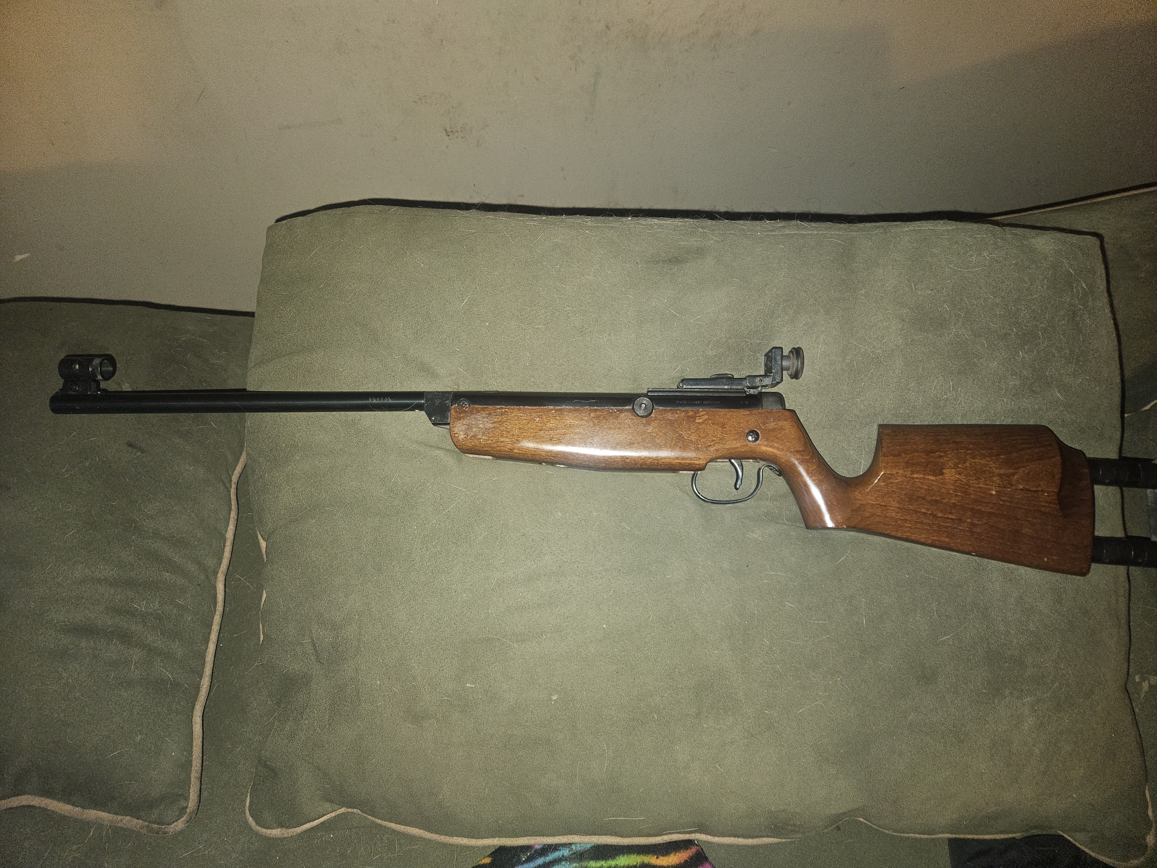

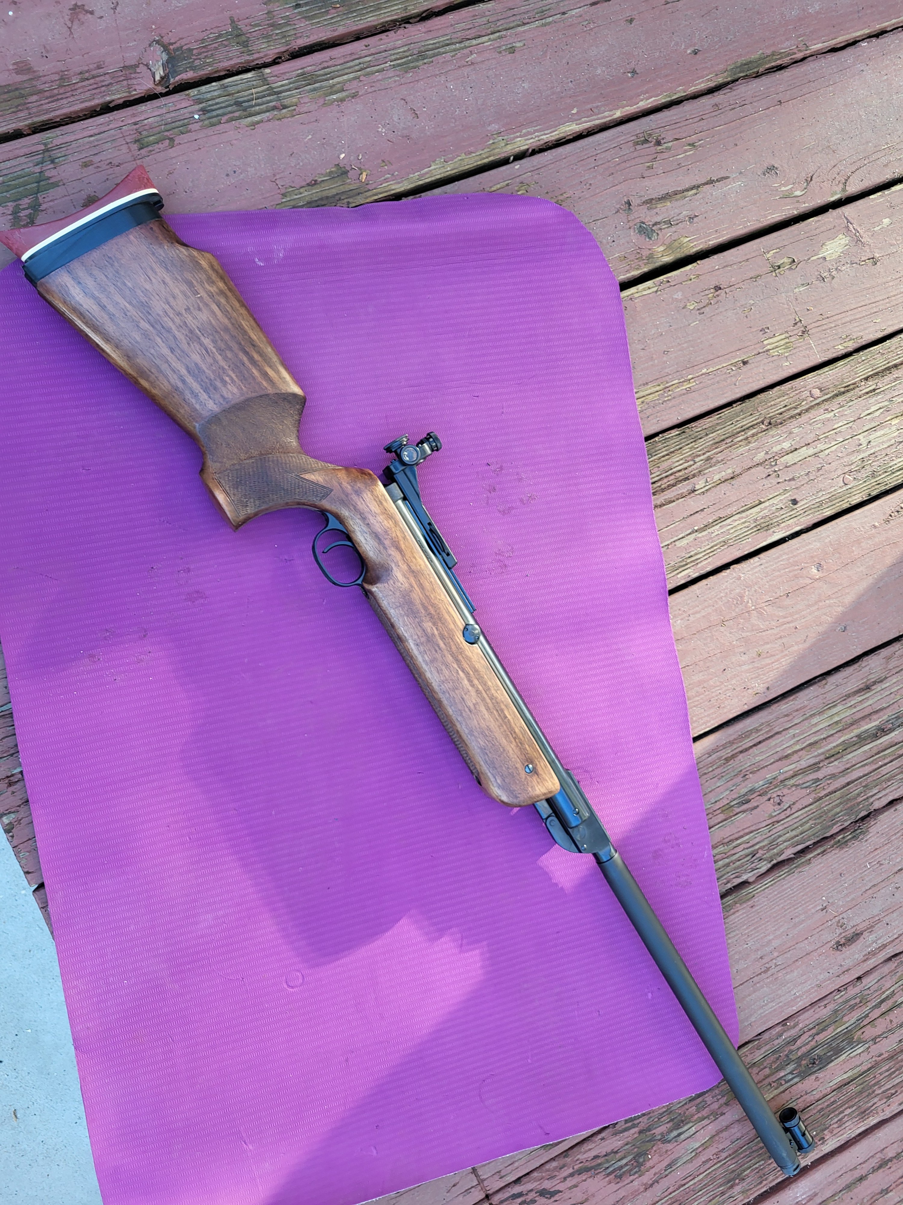

Here's my super rare model 72 next to a model 34 for scale.
Love the model 72! A true recoilless match gun for the grade-school set, ha - we will never see its like again. I had a model 70 for a while (recoiling version based on the model 5 pistol instead of the model 6) which was very cool too.
A great detail on those guns was the abilty to mount the rear sight on the scope rail, and nifty clip-on peep attachment. Diana is missing a sure bet not to do that for all their rifles.
Thanks mike! She sure is a nifty little gun, and with all it's spacers attached, the LOP is long enough to be comfortable for my adult frame.
