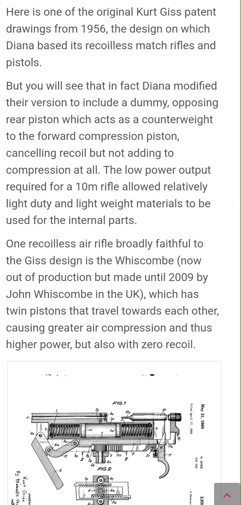

John Whiscombe's amazing limited-production guns used the original Giss patent system, with pistons moving toward each other. Some of those met or considerably exceeded 12 FPE. IIRC some of them had multi-stroke cocking that even allowed shooting at different power levels.
More info and pics here:

John Whiscombe's amazing limited-production guns used the original Giss patent system, with pistons moving toward each other. Some of those met or considerably exceeded 12 FPE. IIRC some of them had so much power, that the cocking action required multiple strokes.

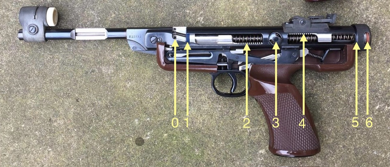

I shamelessly ripped off this image of a factory cutaway model 6 pistol from Danny Garvin's fabulous "Vintage Airguns Gallery" site. It shows the workings of the "Giss system Dianas" very well:
0. Breech seal and transfer port
1. Blue seal on face of front piston
2. Straight rack teeth, on both sides of the bottom half of the front piston
3. Controller cogs, on both sides of the receiver tube
4. Rack teeth on top of rear piston
5. Blue bumper on face of rear piston
6. Metal piston spacing shims and red end cap pad
Note also the gun has doubled mainsprings, one inside the other and wound in opposite directions, to reduce vibration.
(So anyway - how cool would it be to own this thing...!?!? I have a hot flash of envy every time I see this pic...!)

Fully recoilless guns as opposed to sledge type systems which are listed as semi reoilless. Dual opposing pistons cancel recoil, predominately 10M guns both rifle and pistol and mostly Diana, Whiscombe used the same "type" system.
