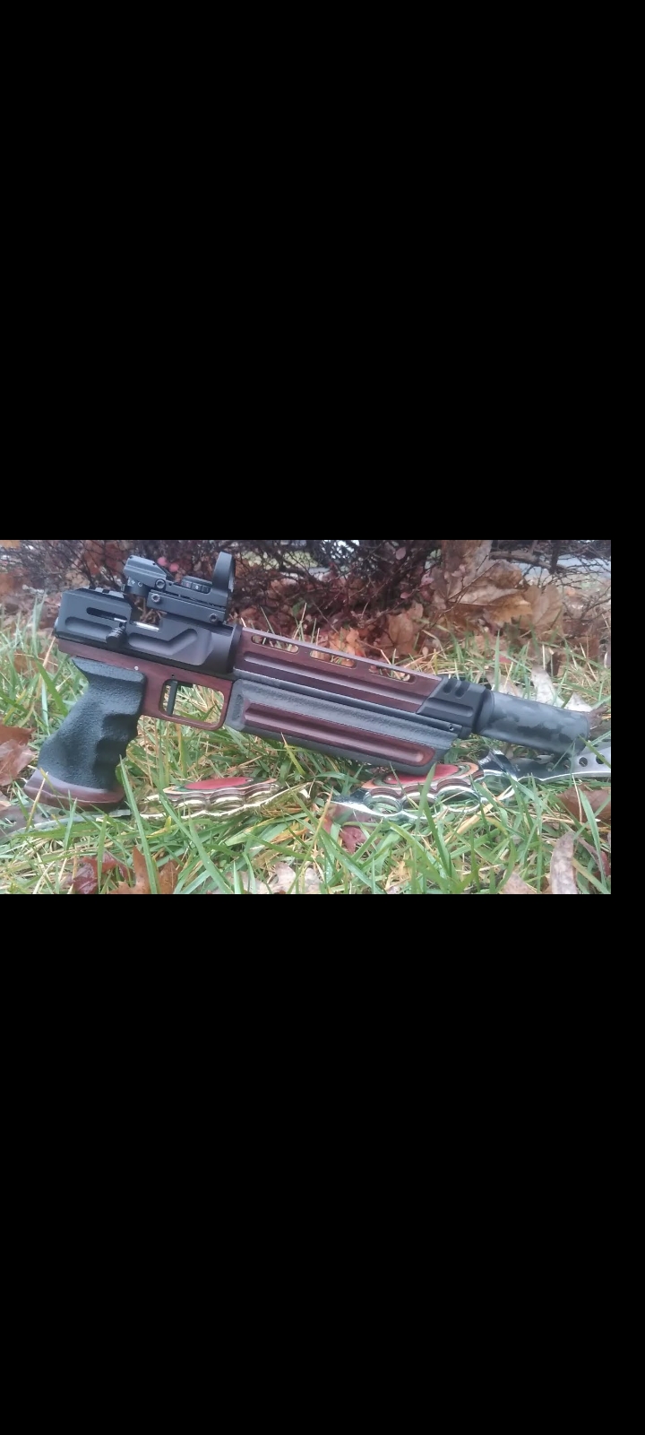

Nice work but she's begging for a steel breech & a LPA MIM sight

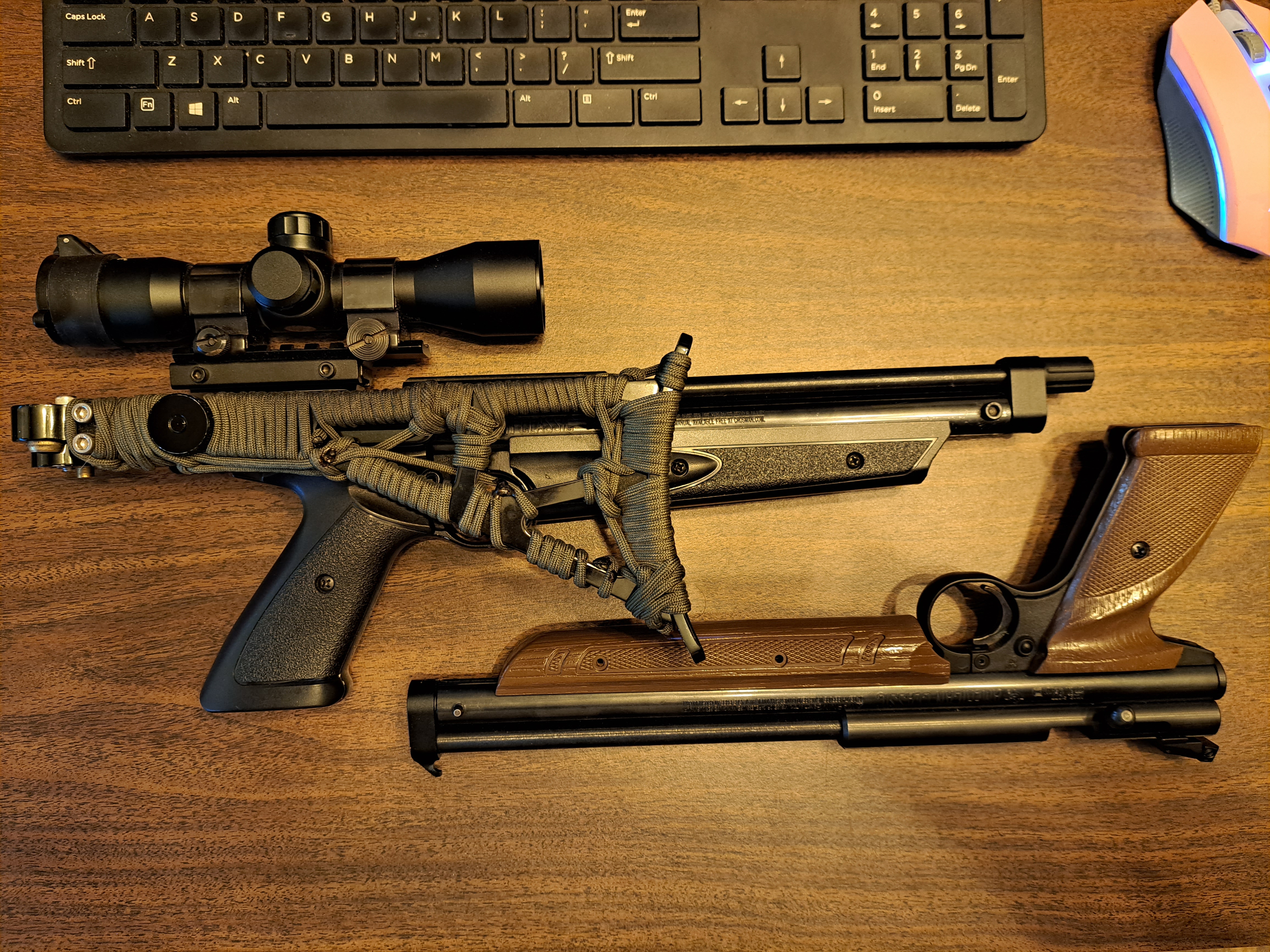

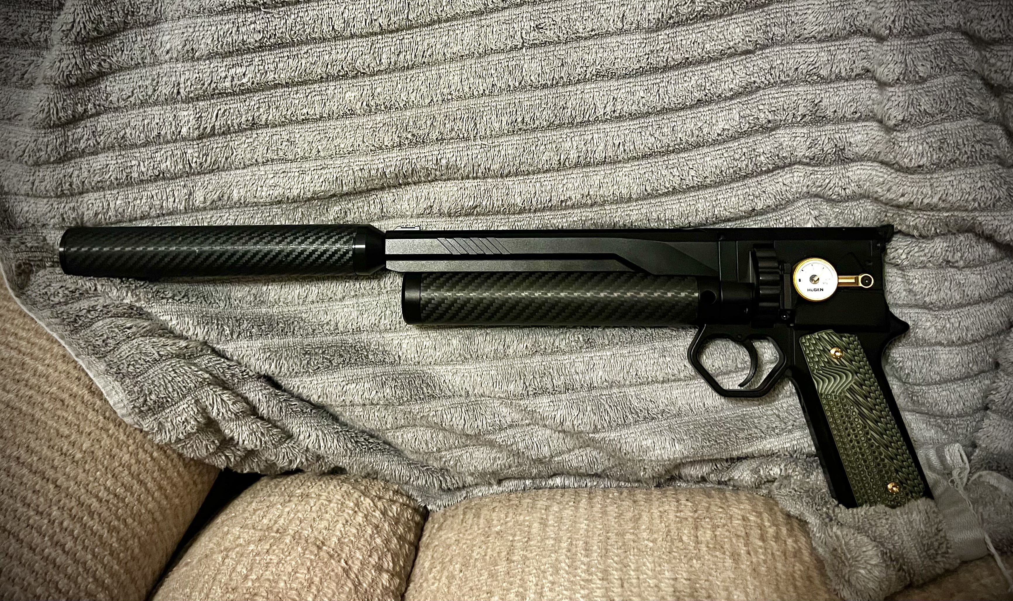

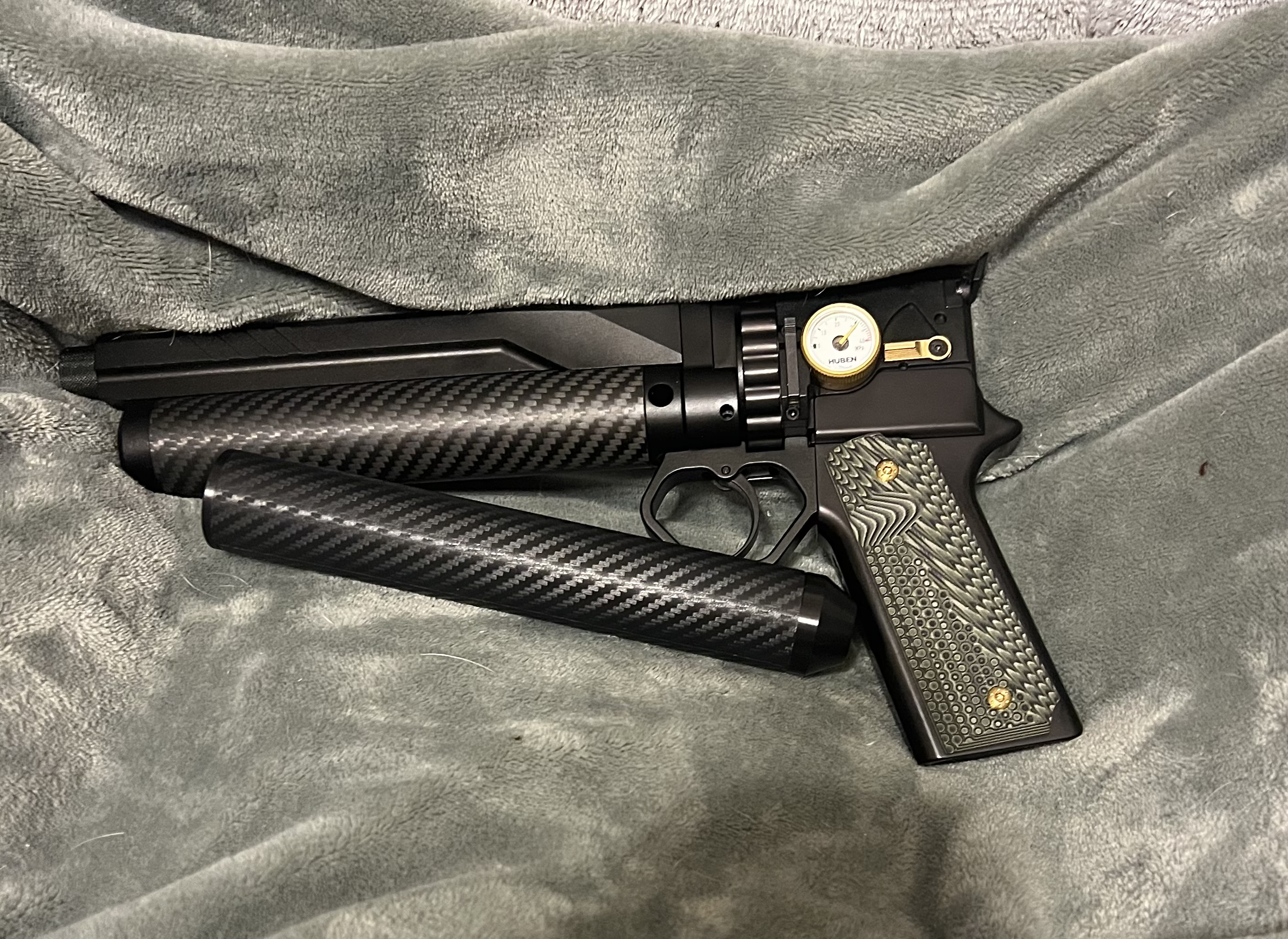

The bottom pistol is essentially its twin but in brown and. 177. with the breech MIM and metal front sight.
These posted are. .177

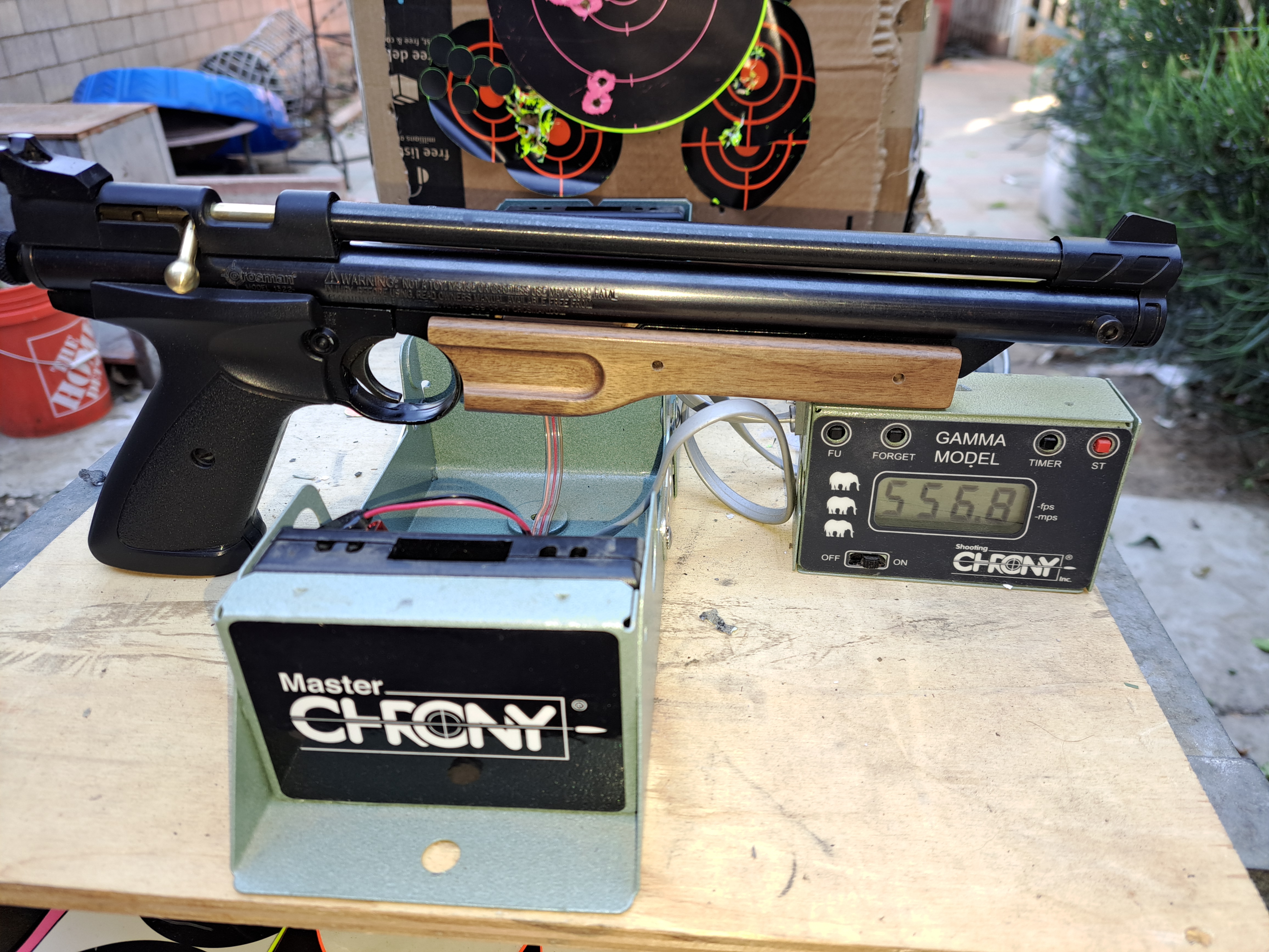

I would like to learn more about this one if you can . I am trying to do the same thing.Wanted to push the limits on a stock barrel.

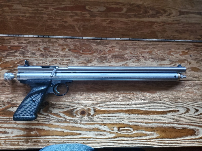

Still a work in progress in the furnishing but I'm done with the internals. This is with 15.43 .22
Pumps. Fps
10. 470
12. 500
14. 532
16. 556
10.5 ftlbs In a compact self contained build.
It uses the stock pump cup and newer ridged piston, transfer port and barrel port opened to. 157, valve exhaust angled, larger internal volume, poppet shaft thinned down and seal shaped for flow, valve Inlet dead space removed, stock valve spring with RVA that added 15 fps.I would like to learn more about this one if you can . I am trying to do the same thing.
